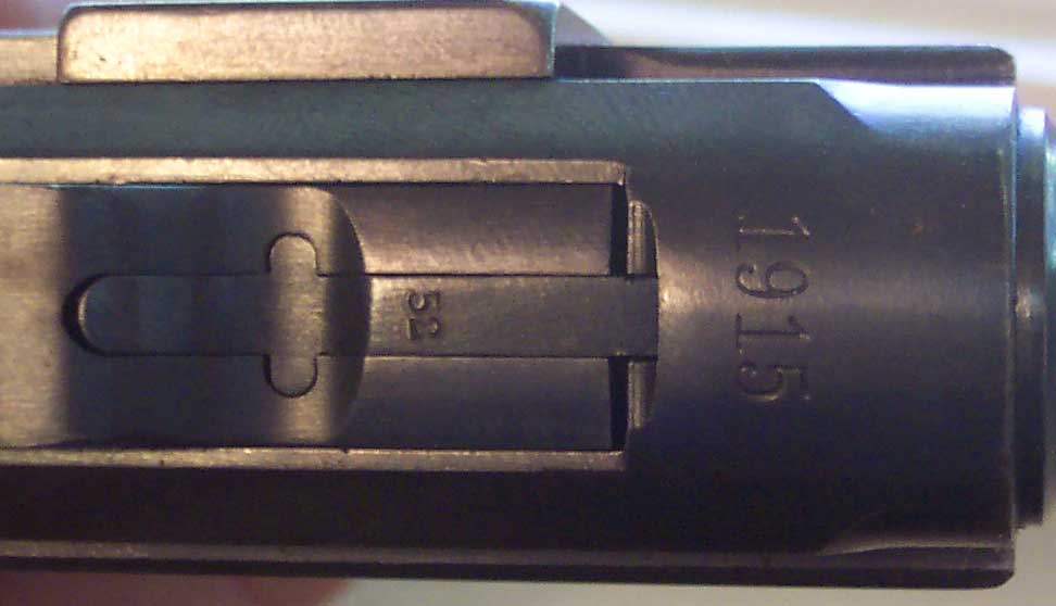

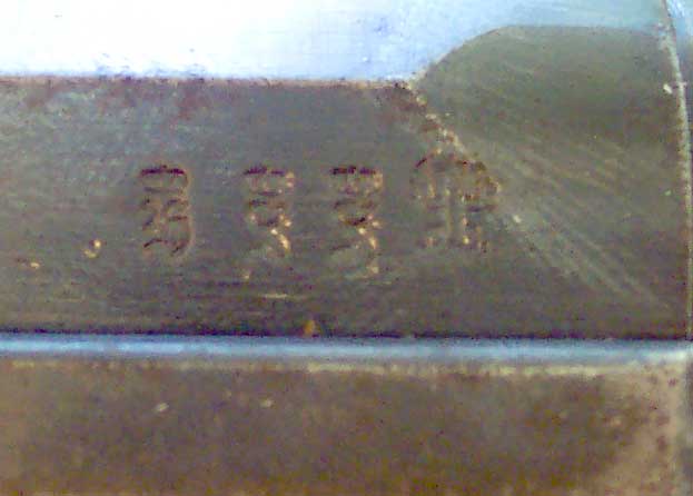

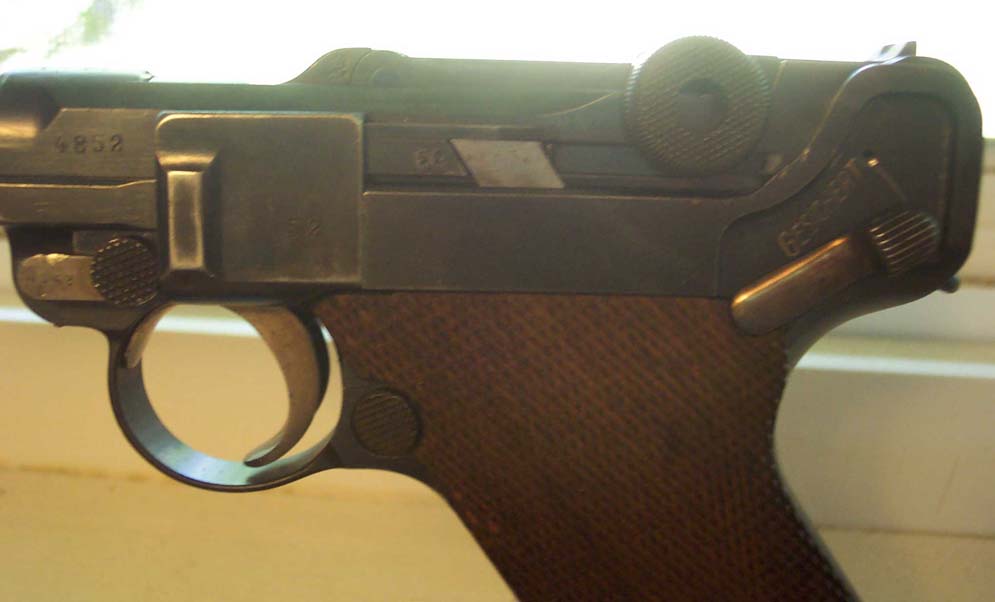

Hello, I just got this gun from my father, He got it during WW2 taken from a german officer (rank unknown). It is in good shape just a little worn and need help in locating a small clip for the magazine holder (part # 028 on parts list for on this site). Hopefully the pics to follow will help in telling me all about this fine gun. holster and a extra clip along with tool did come along with it. On the left side before barrel is 4852 im guessing this is a serial number, and above it is a inscription and was wounder what that is, and means, along with in several places there is a 52 stamped. also would like to know what type ammo should be used with this gun and any tips on care to keeping in in good condition.
Jeff

Default pic
inscription
Jeff

Default pic left side
left side
Jeff

Unread 07-09-2005, 08:32 PM   #7
Hello Jeff,
This is a 1915 DWM made for WW1, it appears to be in fairly nice condition. We'd like to see the holster if we could?
The last two of the serial number should be on about 6-8 other parts, while under the barrel is usually the serial number and a 8,82, 8,83 etc., which is the land-to-land measurement acceptance marking.

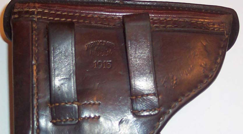

Default holster
Here is the holster
Jeff
jlmr is offline   Reply With Quote

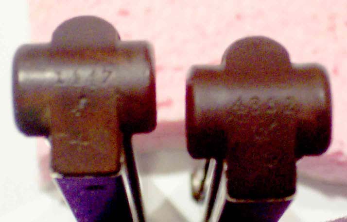

Default magazine
one is marked 4852 d +
other looks to be better shape cleaner looking 1447 looks like a slanted stick figure and +

The part you need (28) is the Magazine holder catch spring, and you should be able to get it from several sources. Try placing a want-to-buy ad in the Wanted Forum classifieds. The guy you need to ask is Tom Heller (Lugerdoc).

Jim, Nice example of a 1915 DWM military PO8 with one matching mag & holster. Unless my eyes, or your photo, deceive me, the tube of your #1447 (mismatched mag) appears to have a slot cut into the spine just above the wood bottom. If I'm correct, this may be an early Dutch luger mag tube that would have originally had a spring actuated quick release wood bottom. Definately worth restoring. If you can find the proper wood bottom, I have the spring. I also have exc original mag release springs available @$12 post paid or new repros @$8. Tom Heller POB 398 St.Charles, MO. 63302.

One last thing Jim... the actual serial number for the entire pistol is located on the front of the grip frame... There is likely a small alphabetical character under the serial number, that is integral to the serial number to distinguish it from other Lugers with the same four numbers which would have been repeated many times during the production of Lugers...
For any official purpose (e.g., registration forms, insurance papers, bills of sale, etc.) make sure you include the suffix letter with the serial number to make sure your Luger is documented properly.
Since one of your magazines is apparently matching, "4852 d +" then the letter suffix to be found on your Luger on the front of the grip frame should also be a "d" character. The plus sign indicates that this was the spare magazine for your Luger, and not the primary magazine...
