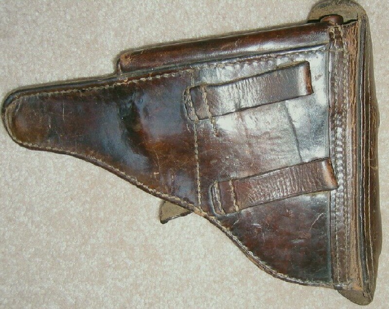

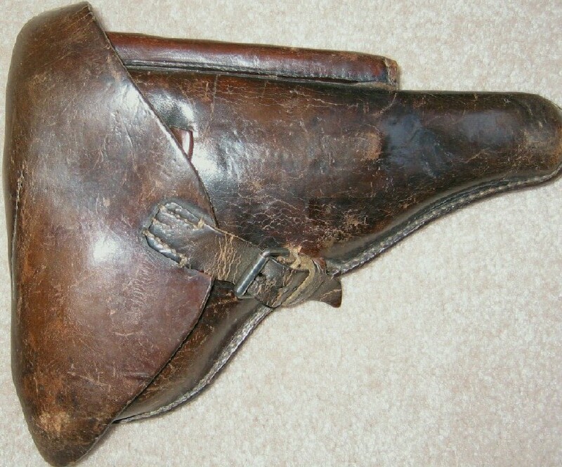

I recently bought an Imperial rig with a holster which appears to have been with the gun since WW-I. The holster is in good physical condition, but the surface/finish is pretty rough.
I would like to improve the appearance and protect the leather from further deterioration, BUT I don't want to do anything which would decrease the value of the holster or negatively affect the collectability thereof.
In the opinion of other collectors, would any kind of restoration degrade the value in a manner analogous to that when a Luger is reblued?
Thanks for your help.
Luke
http://forum.lugerforum.com/lfupload/holster_front.jpg
http://forum.lugerforum.com/lfupload/holster_back.jpg

Luke, It depends on what you mean by rough. Dents, scratches, scuffs, chemical burns, wrinkling, discoloration, peeling, cracking and some others that don't immediately come to mind. Post a photo on the Forum and I will look it over.

Thanks for the comments. I edited my original posting and added two links to pictures of the front and back of the holster. The damage is mostly scuffs, dents, scratches, and some minor cracking. The cracking is primarily on the strap and the rear section of the top.
After posting on Jan's forum I did find a very clear "1916" on the inside of the top cover. Have not been able to find a maker's mark.

Luke, Took a look at your holster. It is actually in pretty good condition. There is some surface cracking but it is rare not to see some of this on WW1 holsters. I would not hesitate to lightly coat this holster with Hide Food. Let it sit for an hour or so and rub it down with a soft cotton cloth. Lightly stuff the body with newspaper to prevent collapsing the leather and causing more crackling. If there is any HF residue in the holes or seams lightly toothbrush them out.
Before you apply the HF lightly brush the seams to get off any dust or dirt.
Good Luck, Jerry Burney
