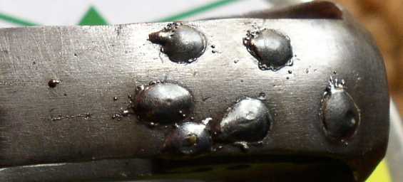

Normal is 3-5 months as per my website. Small spot repairs are usually only 2-3 weeks. Some jobs that require engraving or extensive welding adds anywhere from 4-6 months because some of the work is subbed out. Your particular gun was almost ruined by the person that cut the frame flat. It has been to Don almost 6 times now. He runs a full time business so sometimes is it gone anywhere from a week to 3 weeks at a time. I am sorry it is taking so long but I sure dont want to send it back in bad shape.
I have it and Don says if the current fix doesnt work it will try something a bit different. We have the back shaped but the weld pits are what we are battling. Here is what the problems are by a picture. I can do a gun in a week usually but when things like welding show up I have to have some help. Don and I are about going nuts but are persistently working on it. Thanks for your patience.

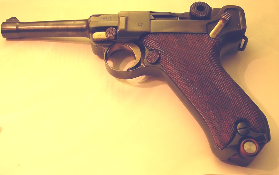

When you get yours back it will look at least as good as this. Excuse the fingerprints but the picture was originally take to show the GT modified MecGar magazine. It groups 3 inches at 50 yards without a rest (on a really good day)

I am getting the impression here that you are building up pits by welding a little spot of metal in them. Is this the case, or is it just my overheated imagination? If so, how well do they blend in by the time you have applied blueing?

unspell-- Actually there was very little trace pitting on the pice. Some one in the last 100 years or so attached a stock lug to my 1900 AE, when Ted removed it, it was discovered the back strap had been ground flat. The welding is to rebuild the contour of said strap but the welding process itself can create voids and pits in the metal which in turn have to be filled. Glen
