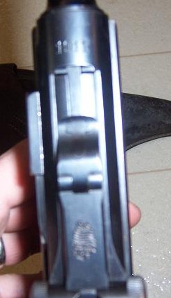

ok, i had a 9mm luger handed down to me last month from my father in law and i looked in my shwing gun catalog and i cannot determine which model i have. the top of the chamber near the barrel is stamped 1911. the serial number is 23 on the back of the gun and in two places on the left side of the gun. the safety has GESICHERT written on the top of the safety switch not the bottom and there is an emblem on the top of the chamber like the one on a 1906 russian contract in the catalog. not the rifle emblem the other one. there is also three engravings on the right side of the barrel that i have trouble making out. the first one looks like an F according to the photos on this sight. the middle one looks like an H with lines on the top and bottom of it and the last one is the eagle emblem. all three have crowns above them. the gun has the holster and extra clip with it and the gun is in emaculate condition. i just cannot determine what model this gun is and what the value might be. i have no intention of selling, just interested in the value and model. i have pictures as well if it might help but im not sure as to the quality of the pictures as far as showing the emblems and engravings. i also have a MENZ rifle bolt action single shot that was from the same time period, if someone could tell me who i can talk to about it or a web site i could look into. any help on either item would be of great help. thanks

Is the emblem on top of the chamber or on the center section of the toggle? A Luger with a date and an emblem on the chamber would be quite unusual. The full serial number will be found on the front of the frame and the bottom of the barrel. The three "engravings" on the right side are on the receiver, and are inspectors marks and the eagle firing proof. It sounds like you have a 1908 pattern military Luger dated 1911. Does it have a stock lug at the bottom rear part of the grip? Photos will help a lot. Condition goes a long way in determining value.

i went thru some of the photos and the emblem markings this weekend and none of them match. i have a few photos but i was using a 4.1 mp. and i could never zoom in close enough to get focused without distorting the picture. the date and emblem or engraving is on the very top of the gun. the date is out toward the barrel and the engraving is in the dead center of the gun ontop. is there instructions on posting pictures to help me attach them or do i just attach it to my messege and i will post the pics this evening.

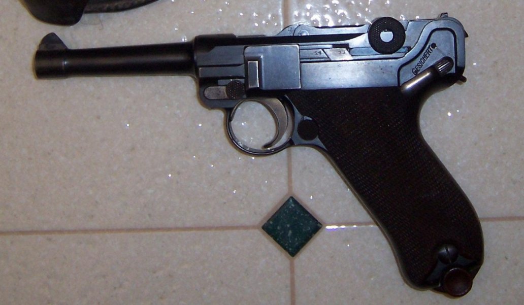

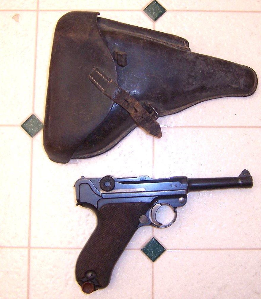

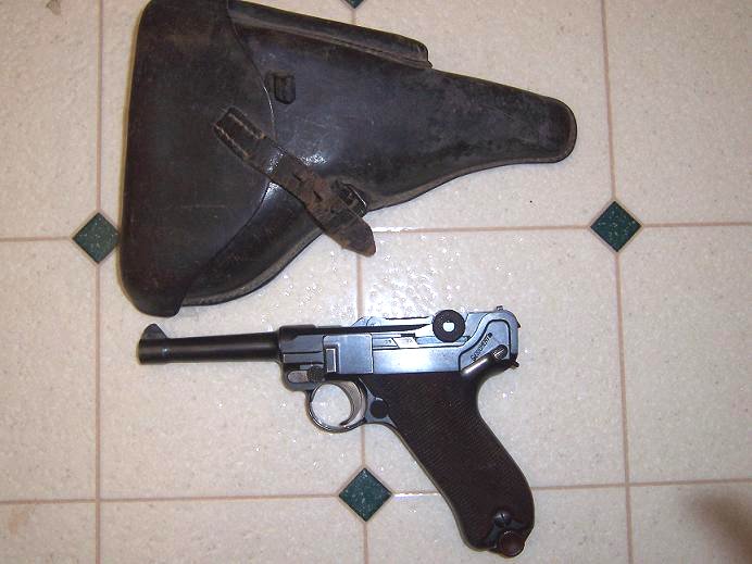

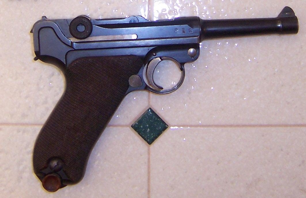

Pictures added for Shawn,
Unread 02-11-2005, 11:46 PM   #7
You have what appears to be a very nice model 1908 pattern military Luger manufactured in 1911 and made by DWM, Deutche Waffen und Munitions Fabriken.

* I believe Ron has hit the nail on the head. A DWM 1908 model made in 1911 for the Army.
* From the pictures, a very nice looking example. Have you identified the full S/N and suffix yet ("The full serial number will be found on the front of the frame and the bottom of the barrel.")?? I'd hazard a guess you'll find a small, lower case "c" or "d" suffix underneath the S/N digits of this example. The suffix is considered a legal part of the S/N.
* Properly marked in the commercial style, you will find the last two digits(23) on the underside of most small parts including inside the grips. Also, a few parts inside (trigger, holdopen if present, receiver lug, firing pin) will bear the same last two numbers.
* Any marking on the holster? Could be on the back between the belt loops, on the front along the edge near the pull-up strap knot, on the inside of the bucket top, etc. If you find some, please post & we'll try to ID the maker and year of holster production. Could be die impression stamped marks or ink/rubber stamped markings(usually inside).
* You have what appears to be a nice, collectable grade, WW1 Army Luger. Trust you can appreciate the fine care given to this example over the 93 years of its existence.

The scrolled engraving on the top are actually the letters D, W and M. On some contract guns, where crests or other engravings were placed on the toggle (the bit where the DWM is stamped on, not engraved), the DWM logo was placed on the chamber, just before the barrel.
Funnily enough DWM (Deutsche Waffen- und Munitionsfabriken) never registered their fancy DWM logo, but instead registered the DWM logo that I use as my 'avatar' (the image on the left).
