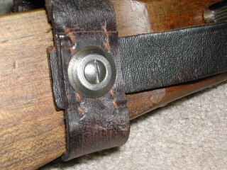

From what I remember on the stocked rig the boot is flimsey and not lined with rawhide. Not correct at all so it leads me to suspect the whole rig. The brass studs were clunky, not fine enough for German manufacture. They also had little or no patina. The metal screws in the stock were shiney too. Original stock screws are steel and have a heavy black patina.

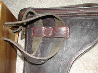

Here is a picture of the back of the holster. In person, the color of the leather does not stand out nearly as dramatically as the picture would indicate. I do not even know what the stock block is or the belt loop Jerry refers to, so again, I am asking for answers as to why this is incorrect. I have access to this holster for another day, so if anyone has any other questions or comments regarding this stock/holster, I would appreciate any comments. If the rig is as bad as Jerry described, then I will probably be getting it back, as I have a full money back return policy if not satisfied. I am not out to gouge or trick anyone, all I am trying to do is sell a stock and holster for what it is. Tracy

Hi Tracy,
If you have the ensemble at home still, could you take and post better photos than were on e-Bay...a good detailed look would certainly help...

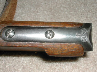

I cannot be sure but the serial number/sufix on the stock iron sure looks like it has a "halo" to me...but cannot be sure of the glare in the photo...
Glad to hear you are on the square and offer a refund...cannot fault anyone that does that !

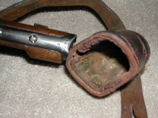

Here is a picture of the stock iron. The original pictures I took for ebay showed all the detail, but when they post them on their auction site, they compress them and therefore, lose much of their clarity. That is why I always ask potential bidders to ask questions and email me for more pics. I emailed more detailed pictures to about 40 prospective bidders, sometimes more than once, when I originally didn't get the angle they wanted. Again, I want to proclaim that I am not trying to hide or deceive anyone. I'll let the pictures speak for themselves. Tracy

Picture of the metal stock screws.

more screws

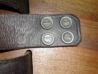

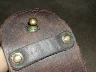

This will be the last picture, it is of the flap enclosure studs. My friend took these photo's for me and was able to downsize them for me. If anyone wants more pictures, I will directly email them , only they will be in a larger file. Thanks for looking and hopefully for some tips on what to look for and what not to look for. As you can see from the photo's, I am not trying to hide anything. I must admit, the screws look pretty new, but again, I don't know what they are supposed to look like. Tracy

Unread 02-03-2005, 01:22 AM   #19
Thanks: 1,119
I gotta admit, it still fools me. To my uneducated eye I couldn't tell you if it was original or not. I wonder if we are looking at two different rigs? I don't see the double line of stitching on the ends of the stock block nor do I see a belt loop, the boot is lined, and the screws look patinated. ????
I'm glad I don't have to make the call.

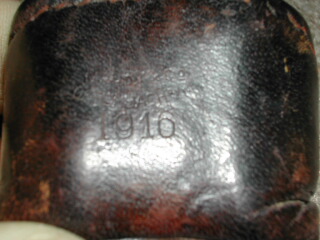

I found another pic which I hadn't posted yet. It is a pic of a stamping of 1916 found on the inside portion of the endcap (closest to wood).
