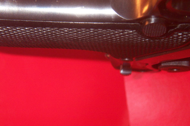

Now look at the fit along the grip straps. The second pic from my Luger.
tracyp is offline   Reply With Quote

Look at the fit below the sideplate. The second pic is one of mine. Look at how much better the fit is.

Here's another pic of mine along the grip straps.

Hi Tracy,
Yours looks just like the only known-authentic black grips that I own. I strongly suspect the grips on the Luger in question are repros.
Luke

Luke,
I have three and they are all the same. The fix is excellent and the backs are smooth with no bubbles.
Tracy
