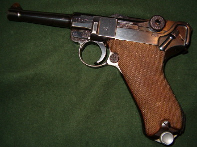

I just picked up a 41/42 Ku Luger along with the capture paper from the Vet who brought it back. This Luger is in excellent condition. With all matching serial numbers including the grips. It also came with a shoulder holster. I'm not convinced this is orginal to the pistol. I know this is one of the more controversial Lugers. Some think it was a Mauser contract Luger for the Kustenfliegerstafflen. Others think it was a Kreighoff rework. All I know is that their is no knowed Kreighoff proof marks that matches the Ku proof mark. Anyway I would like to know more about this Luger. And the Kustenfliegerstafflen

Here are some pics, sorry I cant focus to close with the type of camera I have.

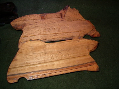

Full four digit serial numbers inside the grips!!! Is that normal for these???

Hi Johnny,
The 4 digit serial number on the grips seems to be normal for the "Ku" examples. Here is a link to my example that has all the ear marks of a "Ku" but doesn't have "Ku" stamped on it.
http://lmd-militaria.com/page540.html
Regards, Leon
