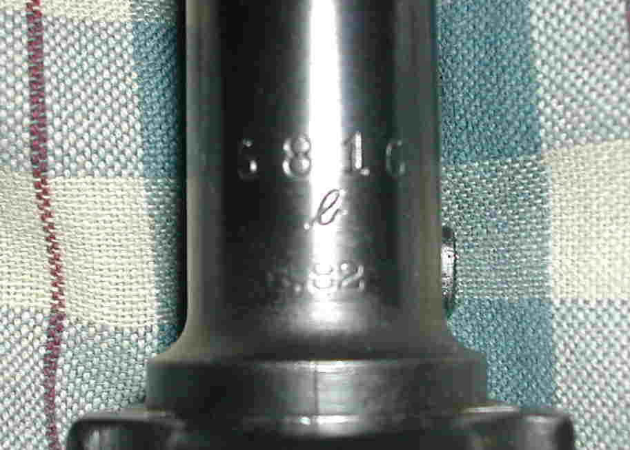

Please post pics of the serial number front of frame, barrel gauge and serial number of barrel. Would like to see if the "halo" around the stamps is present. This would be a sign of re-finish.
SteveM

Reply to Steve. I just tried taking some pics of the area in front of the receiver, but could not get them to come out clearly. I have changed cameras and do not have the macro feature. I will try and borrow a camera and will try to email you the pics. I do not see a halo around the stamps, but then again I do not know exactly what you are referring to. As far as posting new pics, I haven't been able to upload pics as described by Edward Tinker. So new pics will have to wait on this board.

Here is the photo that SteveM requested. I hope I got this now. Tracy

Photo #1
