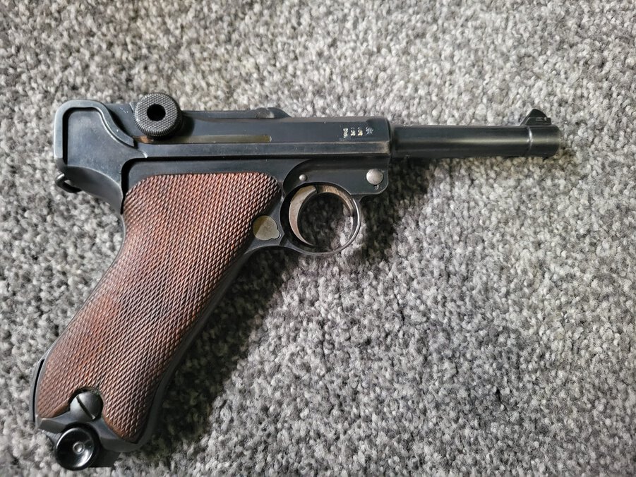

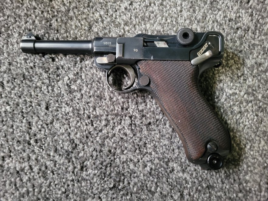

Not really my first, but my first since I started collecting guns. My first luger was an artillery with the drum and stock my grandfather won in a poker game in when stationed in England during WW2 with the 8th air force, he gave it to me for my 21st bday but my roommate stole it 20 some years ago and it hasnt been seen since. Anyway, I've always wanted to add a Luger to my collection and came across this one at the local gun store I frequent for what I hope was a good price ($1550).

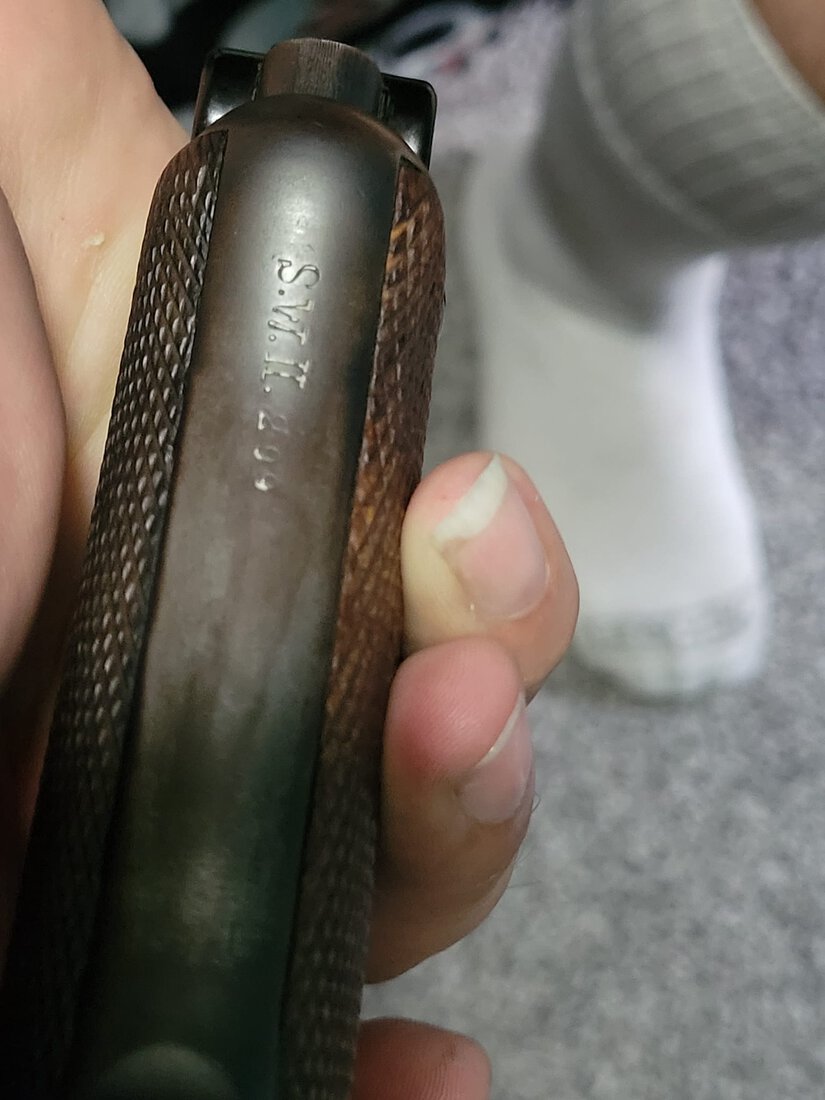

Your 1918 DWM Luger left the factory as an Artillery model. It was later converted for Police use by installing a short barrel and a sear safety.
The unit mark S.W. is also Police for Wiesbaden. The II probably indicates the district, area etc. and the number which I cannot make out for certain is the weapon number.

The mark is "S.W.II.299"

Let me add that at one time your Luger had a magazine disconnect. It has been disabled and is no longer functional. Very few Police Lugers with functional magazine disconnects survive today as they were almost all disabled or removed entirely.

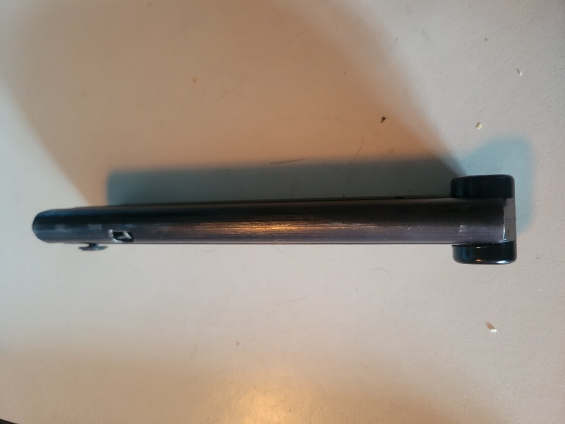

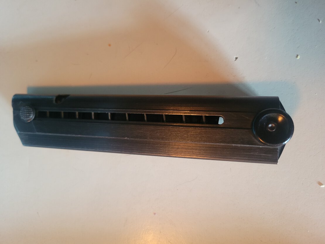

Mrerick, the mag doesn't have any stamps on it at all. The feed lips were bent out a little, I massaged them back in and now it shoots fine with his mag. The mecgars I bought however, are junk. Thankfully they were only 25 bucks each
