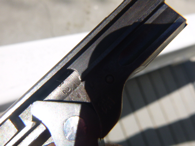

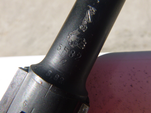

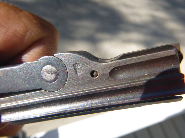

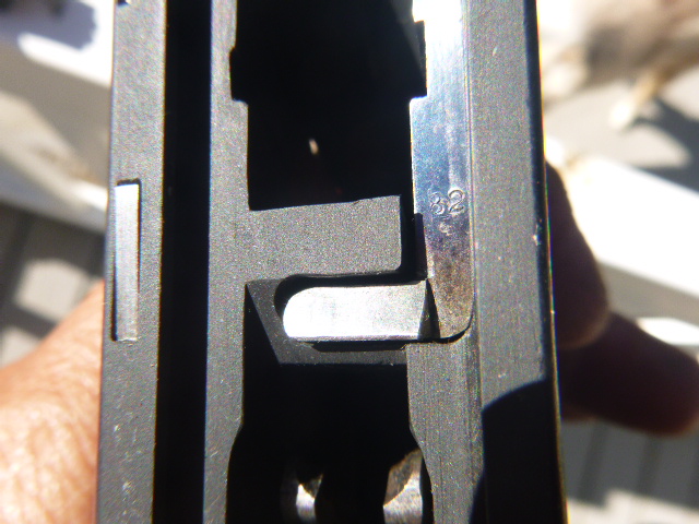

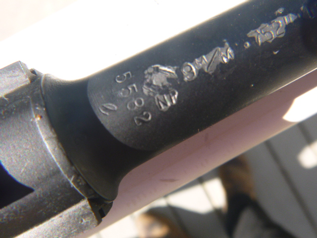

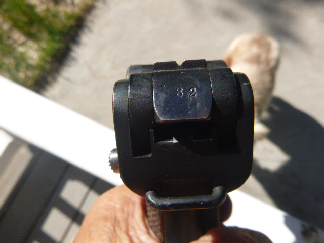

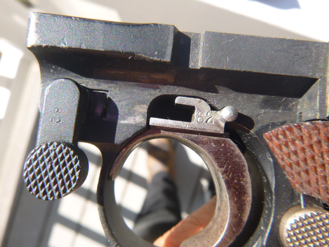

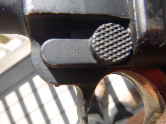

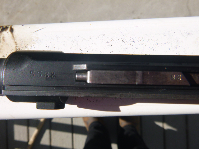

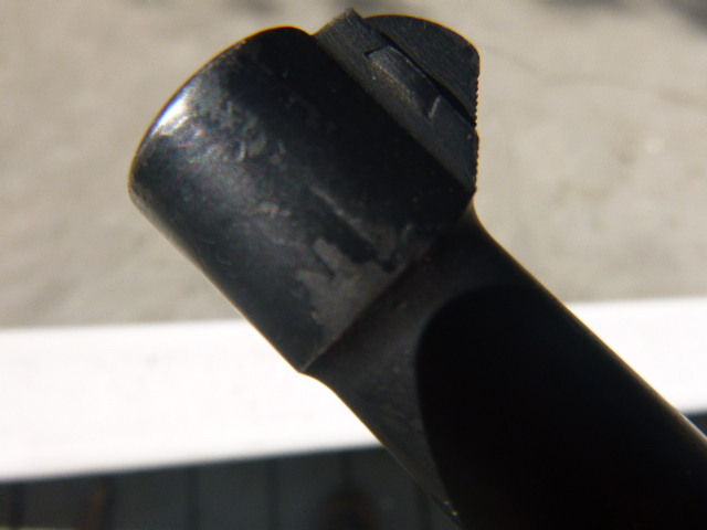

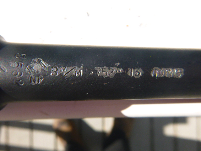

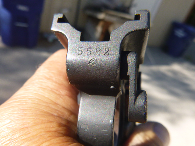

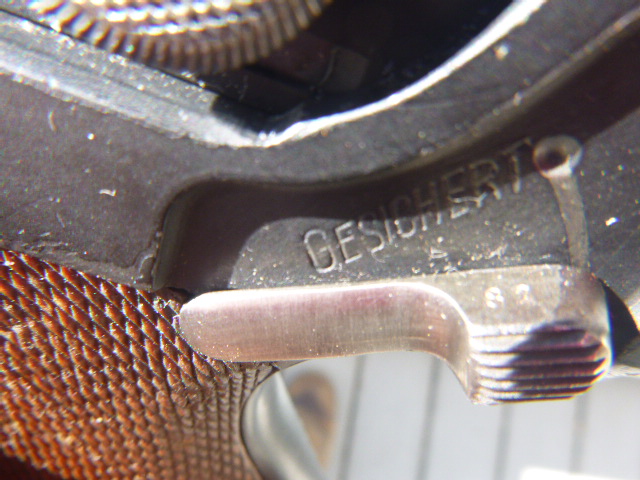

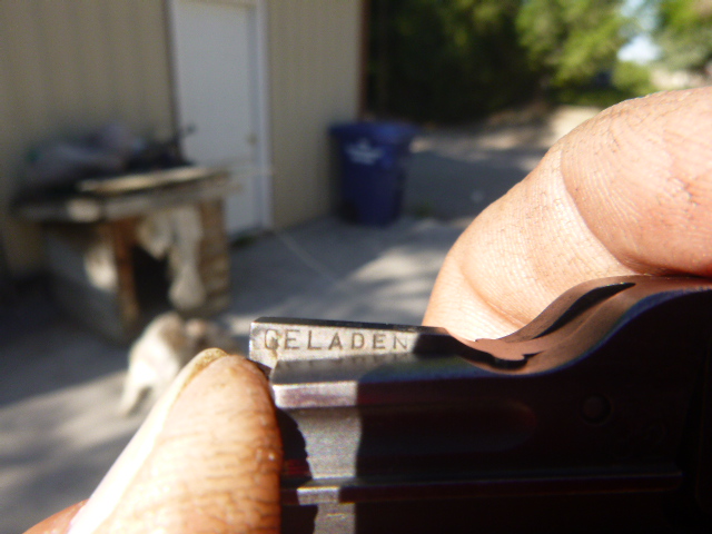

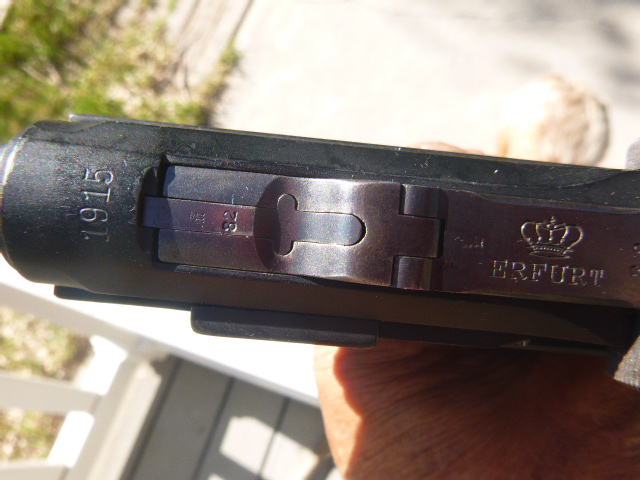

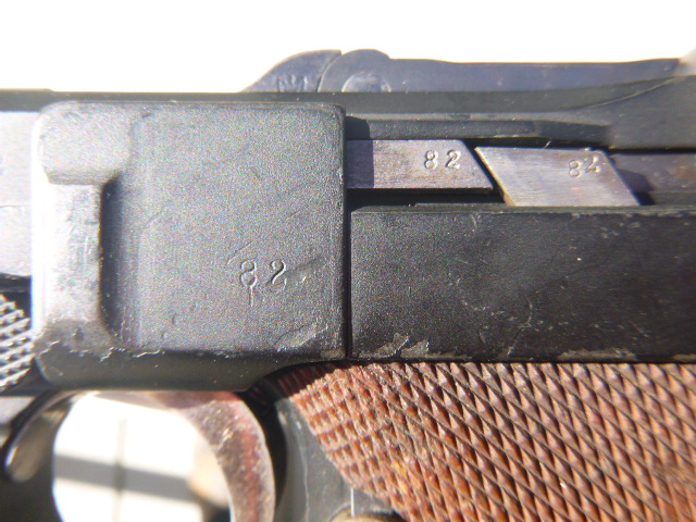

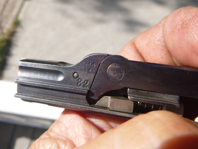

Just picked this up today, couldn't resist, but I can't find much information on these lugers other than when these were sold into the public, the proofs went on. What is the story about these. This is all matching except mag, and the grios are marked 72 instead of 82. Also, what is the stuff that looks like a coating over the blue? Do these hold any value other than a shooter status?

Certainly a refinish and shooter grade. Are the British proofs only on the barrel?

It’s not just refinished, but a total mismatch as well. Erfurt did not make any P.08s in 1915 but someone has mated an “82” marked Erfurt toggle train to a DWM cannon. The British proofs were placed by Birmingham (? unclear photo/mark) for the commercial market.

Interesting. I have seen other similarly marked 1915 Erfurts on the net. There are no other British proofs that I could see other than the barrel marking.

As Bill stated, Erfurt did not make Lugers in 1915. Your toggle train is Erfurt but the receiver is DWM.
At some point your Luger was summitted to a British proof house for proofing, possibly due to repairs. Always interesting but not uncommon.

I'm guessing the black paint looking coating is Suncorite, also known as "stoving". It was used during FTR (Factory Thorough Repair) on small arms throughout the British empire, usually applied over a phosphate finish.
Can you tell whether some of those areas where the coating has worn off look like phosphate/Parkerizing? It could also be applied directly on top of whatever bluing was present at the time but again, usually over phosphate I think.
