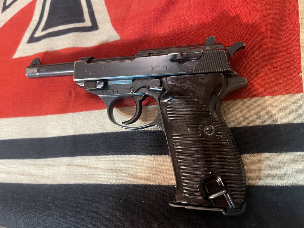

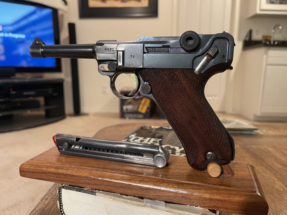

I’m going to run a magazine through my early S/42 , I’ve replaced the original matching numbered firing pin with an original backup as I’ve heard the strength of the metallurgy changes with age? Suggestions? Lighter loaded Ammo? Grains ? 115? Thoughts? Thanks Jim (also my AC41 P.38)

I think the firing pin would be the least of my worries of breaking any part. Me, it would be the ejector.
