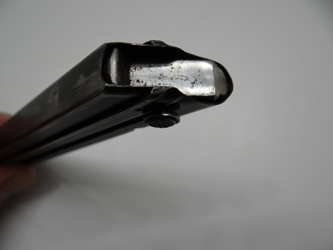

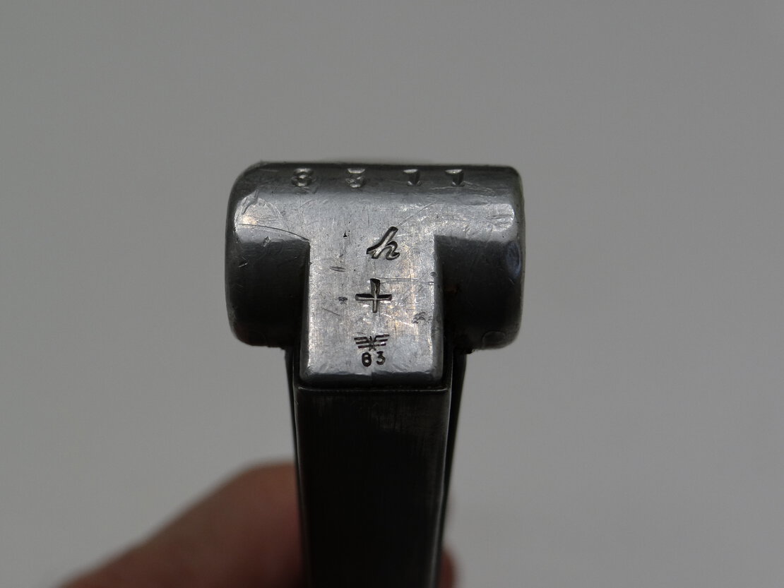

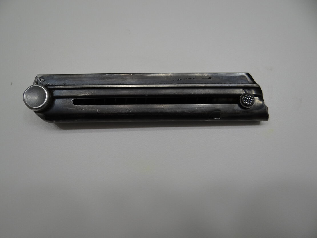

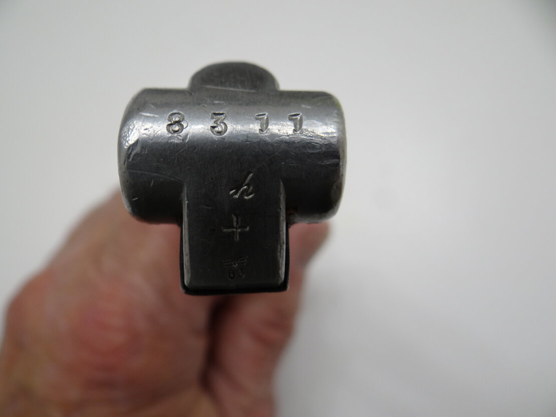

Hi all,
i have a Luger magazine that I am trying to figure out who made it and when.
The only markings are on the aluminum base.
The markings are:
1. the serial number (8311)
2. a lower case h below the SN
3. a plus sign below the h
4. below the h an eagle with 83 below it. The eagle and 83 are very small.
The body is steel, blued
Thoughts please !!

Look closely. I think you have an eagle-over-63, not 83. The lower case "h" is part of the serial number, so 8311h. The plus sign denotes that the mag is the 2nd, or spare, mag out of a pair of 2 that would have come with the pistol originally. 1930's manufacture.
Others will know more and better than I do.
-Bob

For S/42 1936 or 1938 .
