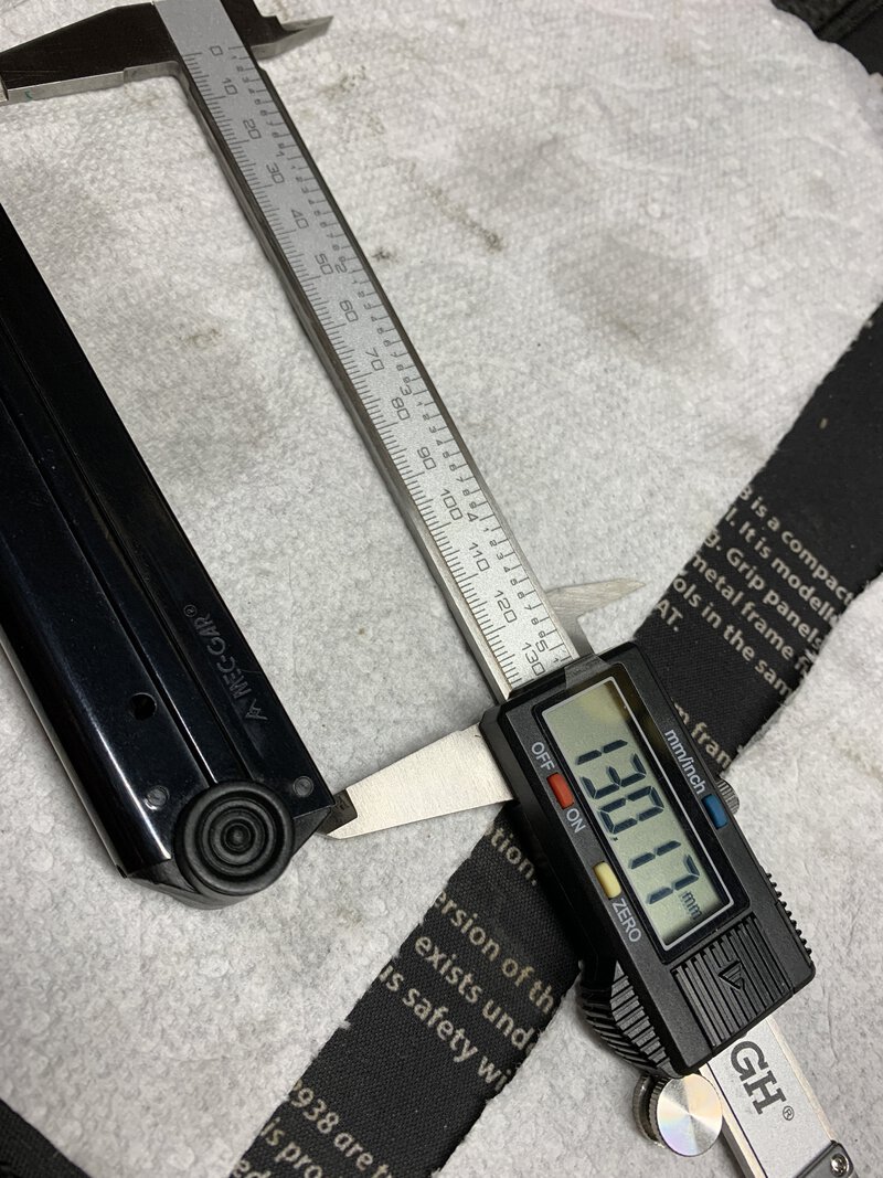

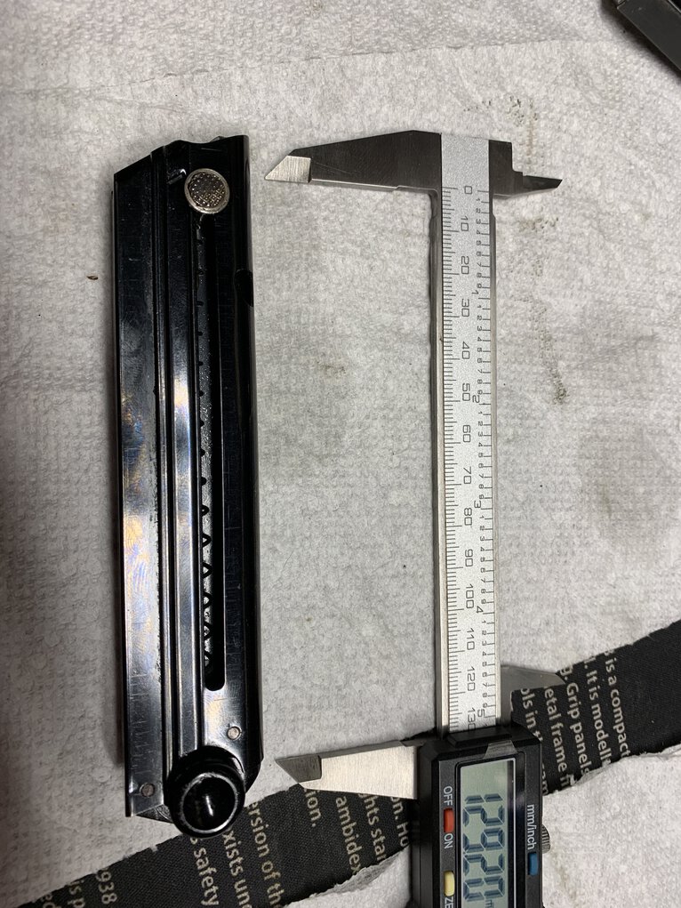

Speaking of 6” calipers…another oddity I’ve noticed is the OEM Mauser Original magazine doesn’t lock the toggle after the last round fired in the 29/70, but a Mec-Gar magazine does. The Mec-Gar magazine lifts the hold open latch considerably higher, as shown on the attached photos:
IMG_7553: Mauser Original 29/70 magazine in 29/70.
IMG_7564: Mec-Gar magazine in 29/70.
I measured the distance from the bottom of the magazine to the top of the follower button (empty magazine): the distance is about 1 mm greater for the Mec-Gar magazine. Sooo…perhaps another example of the Mec-Gar being designed to accommodate most Lugers?
IMG_7585: Mauser Original 29/70 magazine.
IMG_7587: Mec-Gar magazine.
Enjoying this discussion and really appreciate you taking the time to share your expertise.

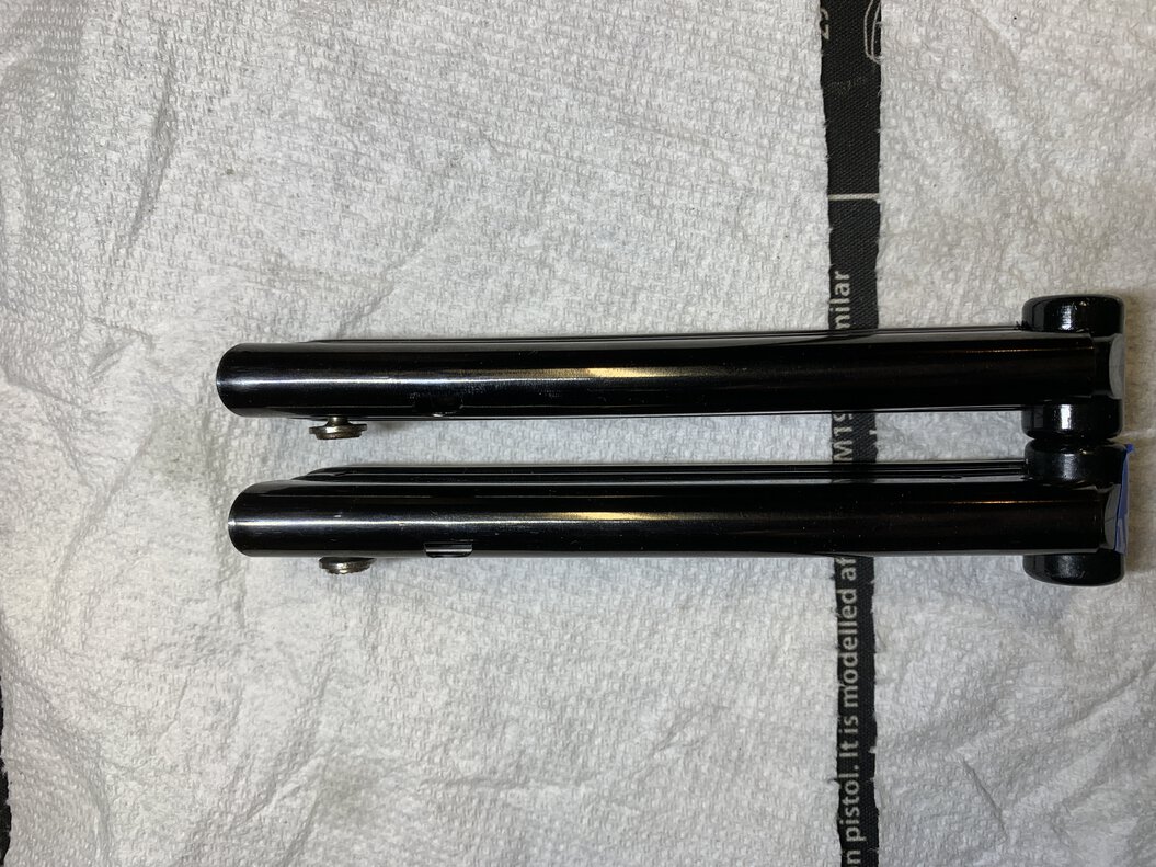

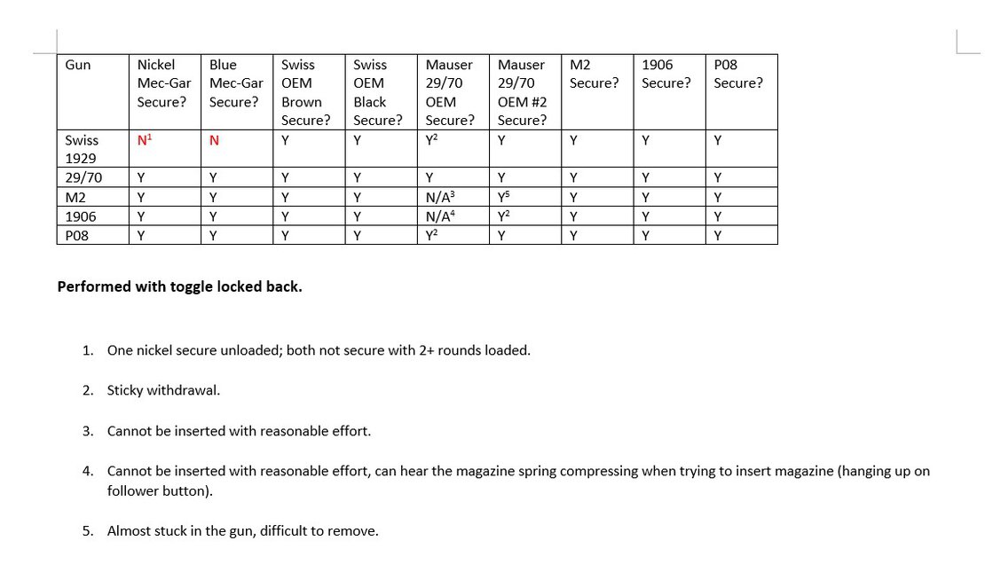

And, as a matter of completeness, and perhaps of interest to some:
1. A photo showing the follower button protruding more on the Mauser magazine that came with my 29/70, as compared to the recently purchased Mauser magazine (blue tape on the base). I believe this is what’s causing the difference in fit between the two magazines.
2. A photo of the table I built:
a. Columns are magazines labeled as "Mec-Gar" or by the pistol it came with it.
b. Rows are the five Lugers I own.
c. Toggle locked back.
d. Y = Magazine is secure, cannot be jiggled out of the pistol by hand.
e. N = Magazine is not secure, can be jiggled out of the pistol by hand.

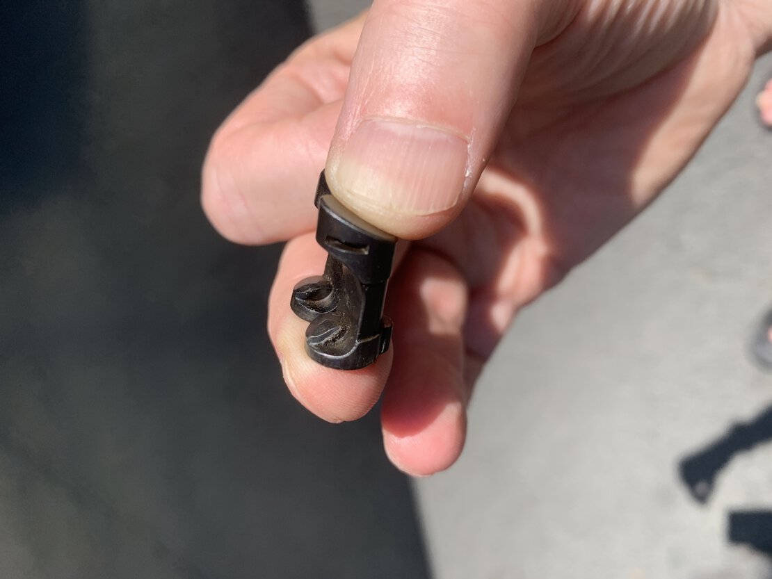

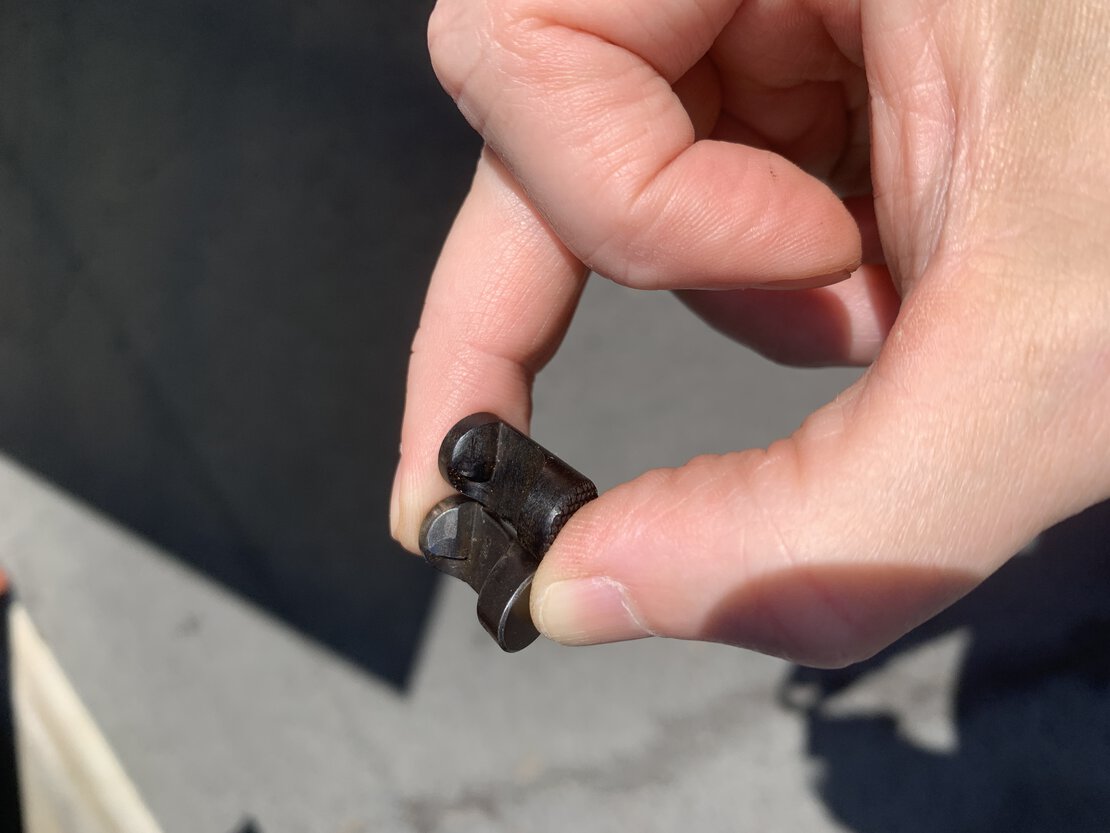

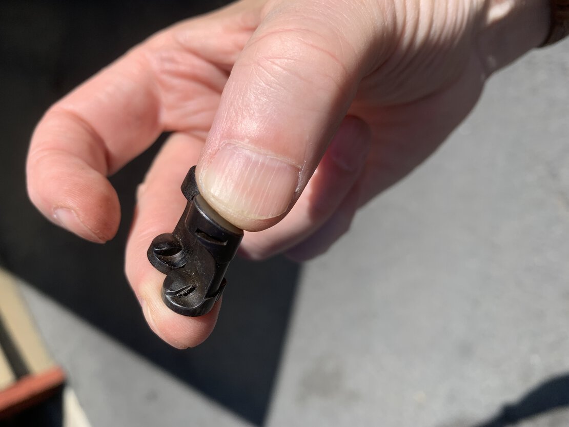

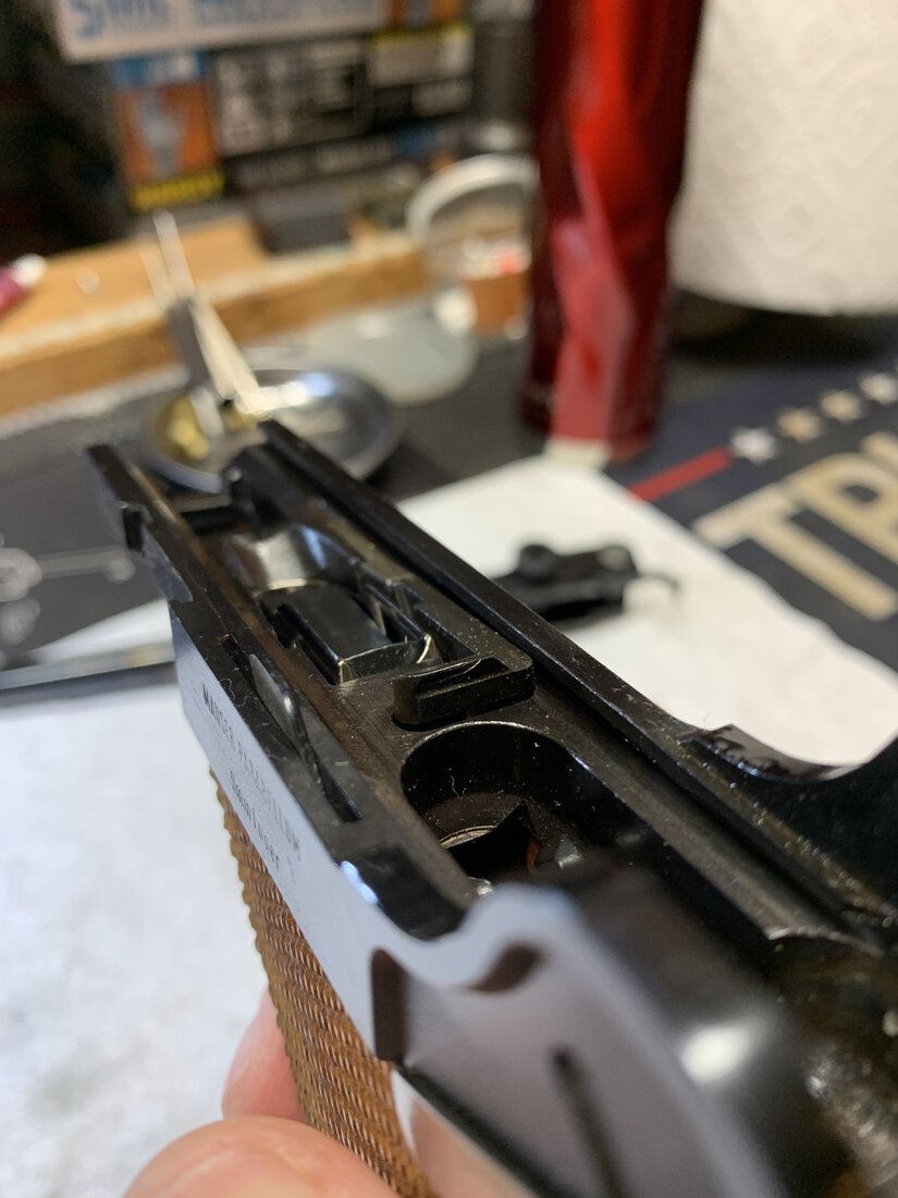

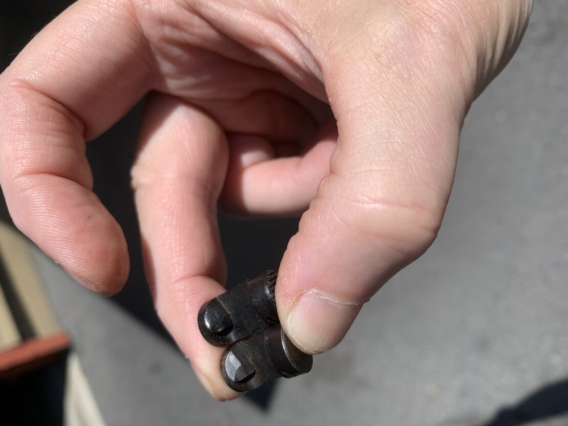

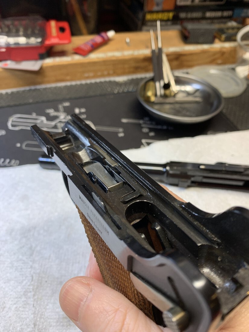

I few months ago, I ordered a parts kit from SARCO, which includes 2 original Swiss Luger magazine catches. Though, technically, they aren't specific to the Model 1929, as the catch is knurled.

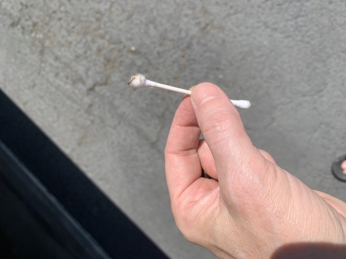

I just installed a "SARCO" Swiss magazine catch in my Model 1929 Luger. I can no longer jiggle a Mec-Gar magazine out of the pistol by hand. So, if I want to use Mec-Gar magazines in the Model 1929, I could leave the knurled SARCO catch installed. That said, since the pistol is working perfectly with Swiss magazines, and I want to preserve the original look, I reinstalled the Model 1929 catch.
I’ve attached photos comparing the Model 1929 and SARCO catches. I can’t say with certainty the Swiss catch is worn, or was originally machined with a different profile. But the profiles are clearly different.

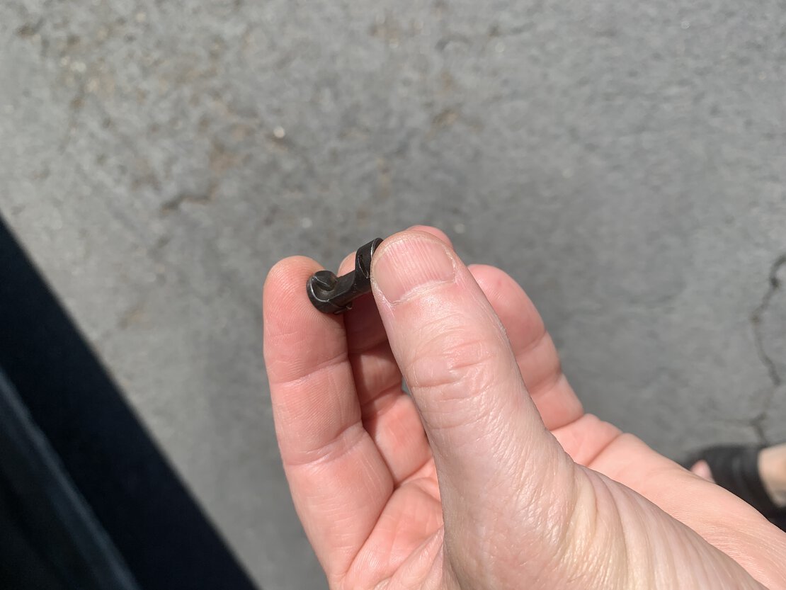

And a photo of the Swiss Model 1929 catch after wiping off the gunk shown in the previous photos.
