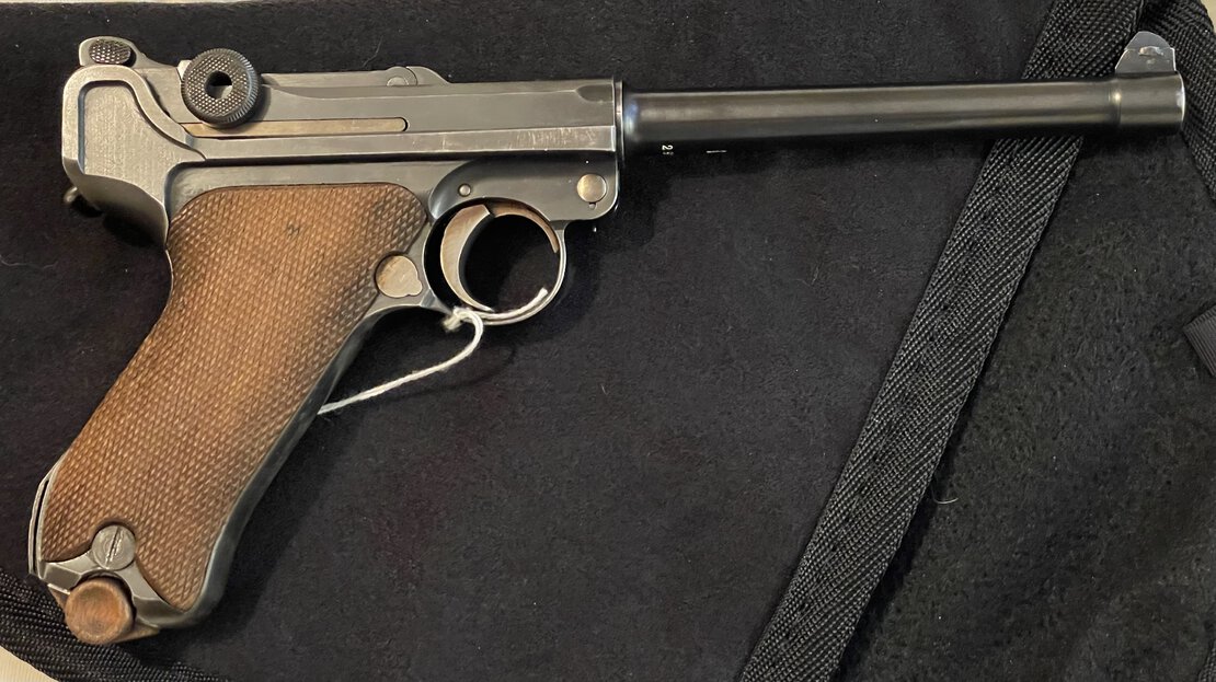

I *think* this is a k date code. Would someone help me put a date to this navy Luger? Thanks!

Need many pictures, since luger production started over every 10,000 guns.
Full top, full left, full right, full front.

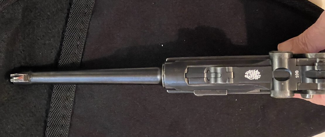

Default Additional photos
Additional photos

Very nice Navy Luger.
I'd say 1921-22.

Can you help me learn why 1920-1921? Do you read the alpha- as a “k” also? Are we looking first at the s/n to get possibilities and then seeing which ones were made in the k-block?

The change from 5 digit commercial serial numbers to the 4 digit with suffix letter - the "alphabet" commercial Lugers - began before mid-1921 according to Gortz & Sturgess. Commercial 5 digit production had reached 92000 which translated to the i letter suffix and that's the first letter used in 1921 when the switch was made. Once 10,000 i was reached, the next letter was k as they never used j because the i & j in written German was interchangeable.
If, as G&S suggest, production of the alphabet commercial Lugers began with 1 i or 2000 i as some think they did to match the 92,000 5 digit models produced, it's likely that your suffix k Luger was made in late 1921 or early 1922. Lacking specific production records, it's impossible to pin point the date more accurately.

You might want to buy a package of Snapcaps in 9mm (I don't think I have ever seen any in 7.65x21). It's a safe way to check the function.

My inside micrometer isn’t ideal for this, but the closest measurement I could get at the exit of the barrel was 8.865mm. Any error would have put me reading a bit low, so I’m comfortable saying it’s a 9mm.

Almost anything is possible with commercials made in the 1920s. My first question is why a 9m/m at a time when all new Lugers (DWM) were supposed to be 7.65? Although many Lugers were exported without barrels to have them installed (9m/m) in their destination countries, this gun, if original, and for this writing let's assume it is, has a barrel which is Berlin proofed, evidence it is original to the gun. According to the German proof law, to proof a pistol it has to be complete, assembled, and serial numbered. This Luger seems to meet that requirement. Although it being 9m/m as an alphabet Luger is unusual, it is not unique.
The next thing I'd look at is the Navy rear sight for originality. A few years ago, some aftermarket replicas were produced, and I believe sold by SARCO. Maybe they are still available, I don't know. Some where I've seen written how to tell them from originals, I don't remember where, maybe G&S. I would be surprised if you found the sight not to be original.
I had an alphabet Navy style commercial up until 3 or 4 years ago, "o" suffix range. Mine had an unnumbered Navy marked barrel and what I finally determined to be a repro rear sight. I sold it as a shooter. If I had the one you show I'd still own it.
Does the Luger you show belong to you? If it does, I'd suggest you keep it as the alphabet Navy style commercial it purports to be until someone convinces you otherwise. I don't see that its GERMANY import marked, so maybe it was produced for some domestic purpose.
Simpson Ltd has one similar for sale, also a "k" suffix, you might want to check it out. DWM 1920 NAVY COMMERCIAL - C26327
