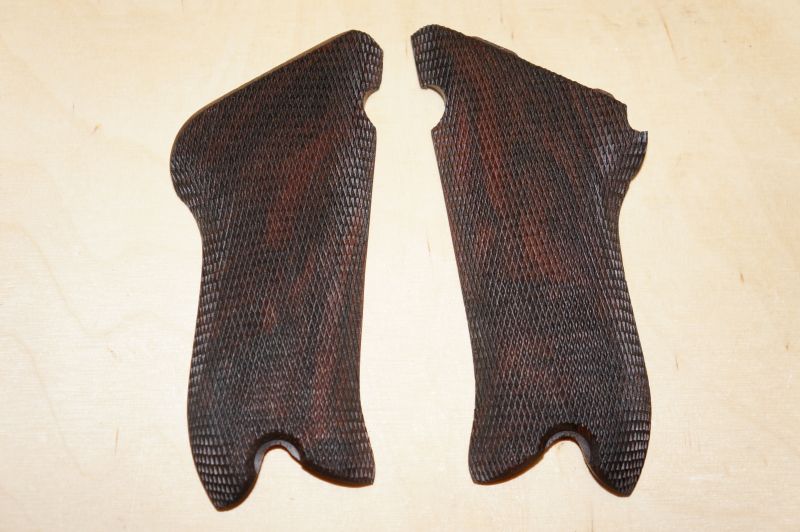

I received a couple sets of these among the things I ordered (another story all by itself) from CDS. They fit my 1917 DWM with no problem aside from shaving a hair from inside the bottom notch, just ahead of the grip screw. http://www.asamnet.de/%7Eehrenred/zu...iffschalen.jpg
60 Euros seems a fairly low/mid-range price. Adding expense of the export permit and a cut for my contact in Deutschland, plus shipping, brings them here for roughly $80. VoPo and those hideous, corrugated Russian grips also available. http://www.asamnet.de/%7Eehrenred/zubehoer/gs.htm

Hi David! I just might be your huckleberry on those grips? Do you have a spare set to sell as i would like to monkey around with them? Maybe if they work out, we could split an order... Best, til....lat'r...GT

I've been meaning to ship you a box of goodies/projects that could use your hand, so how about I put a set of grips in there and we can work something out?

Hi Don! I have been using and depending on the firing pin protrusion gauge you gifted me long ago! It is a perfect fast check, no mus no fuss! You are right about this forum, I think unique in its ability to share good fortune and info... BTW, the set of grips David sent me fit a DWM perfectly... excellent quality... best to all, til.....lat'r....GT..
