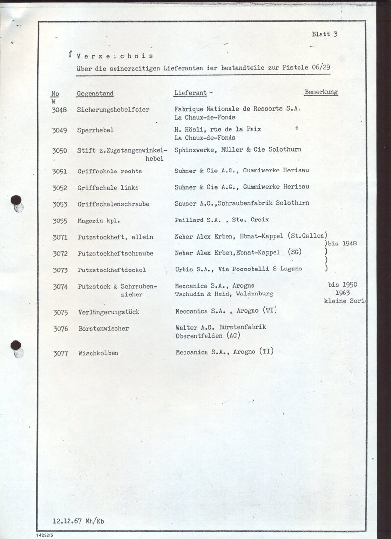

29 Swiss made by Paillard... documented.
Erma made Luger magazines post war, as well as their .22lr mags.
MFT in Tilburg, The Netherlands, made the post war Parabellum magazines (and HSc ones) for Mauser.
East German mags by Ernst Thälmann Werke in Suhl.

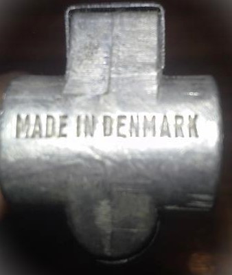

In the years 1951 to 1962, the Danish company DISA produced magazines for the P.08. Some are stamped Made In Denmark, at the bottom of the magazine. Magazines were delivered to the USA, England, Germany and Norway, in addition to Denmark.
