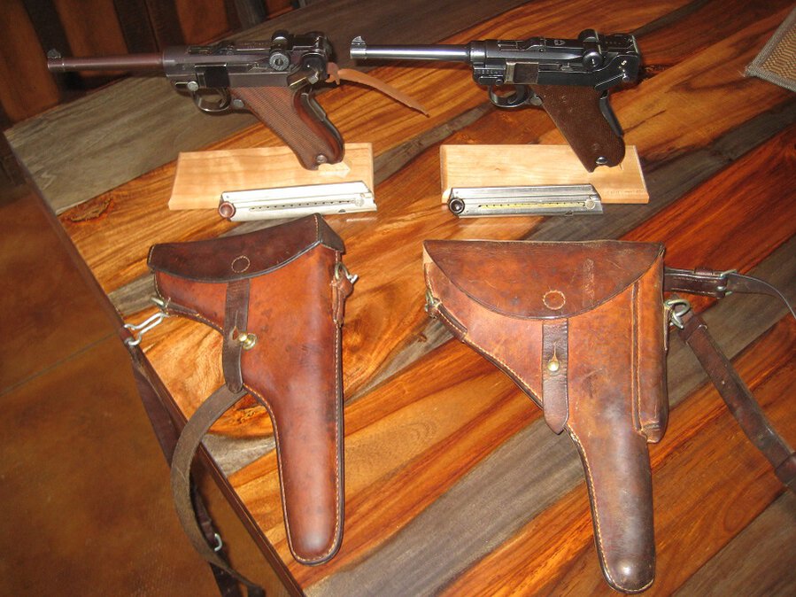

Nice Mac... that is the late Swiss pattern the earlier one with grip safety in .30 had the original styled PO 8 grip. Both Swiss.
