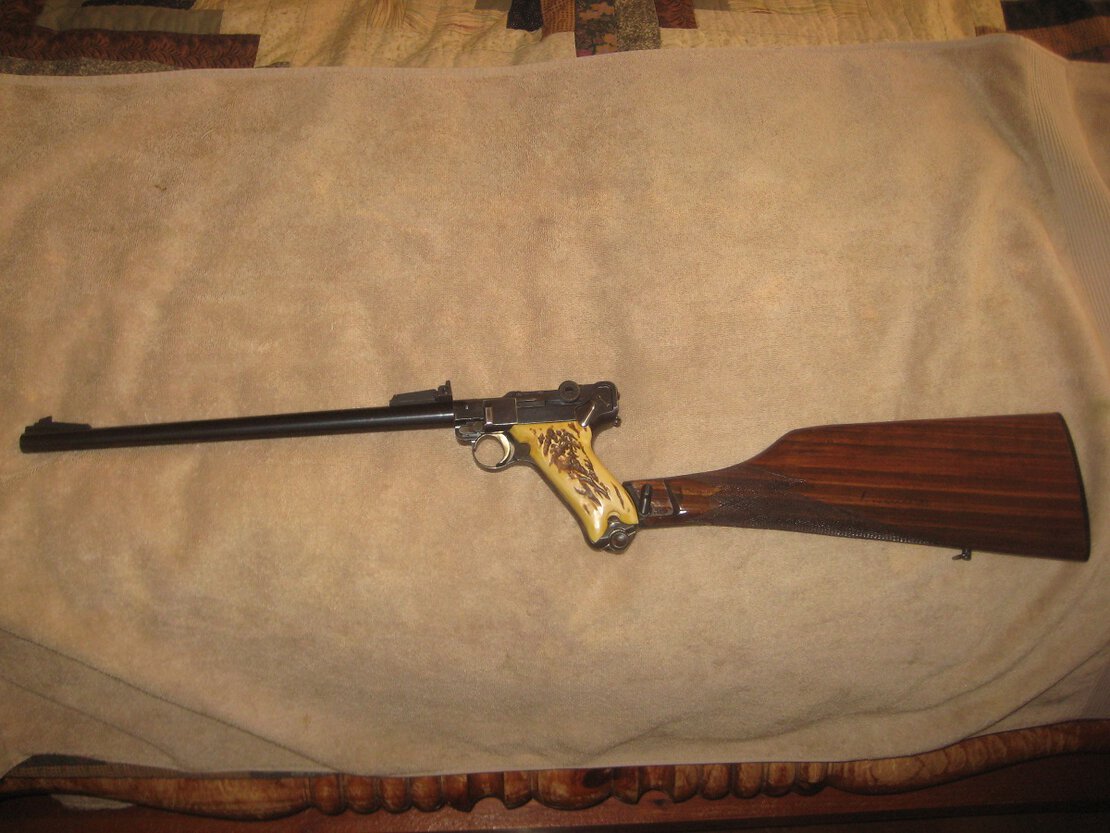

I've been told this is an original 1920 9mm DWM but I find the mis matched finish and the sights to be unlike anything I've seen from that genre.
The rear sight has roll pins and a 'modern' screw base...the front site looks very un German and very US.
I don't see any Germany import stamp....I am no expert but can't find anything similar in my reference books.
The barrel profile looks unusual too...so?
What do you think?

IMO someone has built a custom Luger intended for target shooting. The Luger can be an amazingly accurate pistol. I seriously doubt that DWM ever built anything like that.
Better pictures showing details, including the serial numbers, would help to confirm or disprove my opinion.

He only shows a few pictures and never the serial number nor the top of the sight/pistol. If you look closely, you can see roll pins in the rear sight and a modern screw base on the left. The front sight blade is also secured with a roll pin....Roll pins were 'invented/patented' in 1948.
I agree this was an after the fact barrel event.
The serial number is 91472
He is now saying it was a Stoeger build in the proper period.
reiver is offline   Reply With Quote

Highly unlikely IMO. While Stoeger offered barreled receivers in different barrel lengths, that is almost certainly a custom fit barrel by a gunsmith. I could be wrong but I doubt that Stoeger ever offered custom gunsmithing of that sort.
As is often said, buy the gun; not the story. If it appeals to you and the price is right, buy it but also ask for a money back guarantee if it doesn't function correctly.

"Back in the late 1960, early 1970s there was a place in Minnesota advertising that they would convert conventional 4" barreled Lugers to Luger Carbines. I don't recall prices but if you sent them a 4" barreled Luger they sent you it back with a long barrel. This looks like one of the conversions they offered. I kept one of their catalogs" "

I made an offer based upon a shooter/modified Luger as he says it cycles perfectly.... might be fun if he will seriously lower his 'buy now' price.
He accepted my offer that was a shooter price.... he's come to the conclusion it is simply an aftermarket job. Money back if it does not cycle properly.
On that cycling issue with the long barrels...this is 9mm btw. Was the ammo too weak or too hot that caused issues? That is a lot of 'mass' to move in the recoil mode. OTOH, the round is in the tube longer too...so could be either as a guess.

A Carbine luger has a forestock.
This gun has none, which I suspect would make it more difficult to aim.
I wonder if it was intended to work with a should stock, too.
It will certainly be an interesting gun to shoot.

I have a carbine shoulder stock and can't imagine shooting that piece without it.
Arty Lugers are fine either way with an 8 in. barrel but the stock with a two hand grip is a great platform...I suspect that same hold will be fine with the cannon barrel.

I have the pistol and the overall condition is very good...tight. I cleaned and inspected it

The barrel is actually 14.5 in. measured from the chamber...the owner measured 'outside'.

T/C Thompson Center rear sight. Pretty obvious. I've got a couple laying around the shop.
