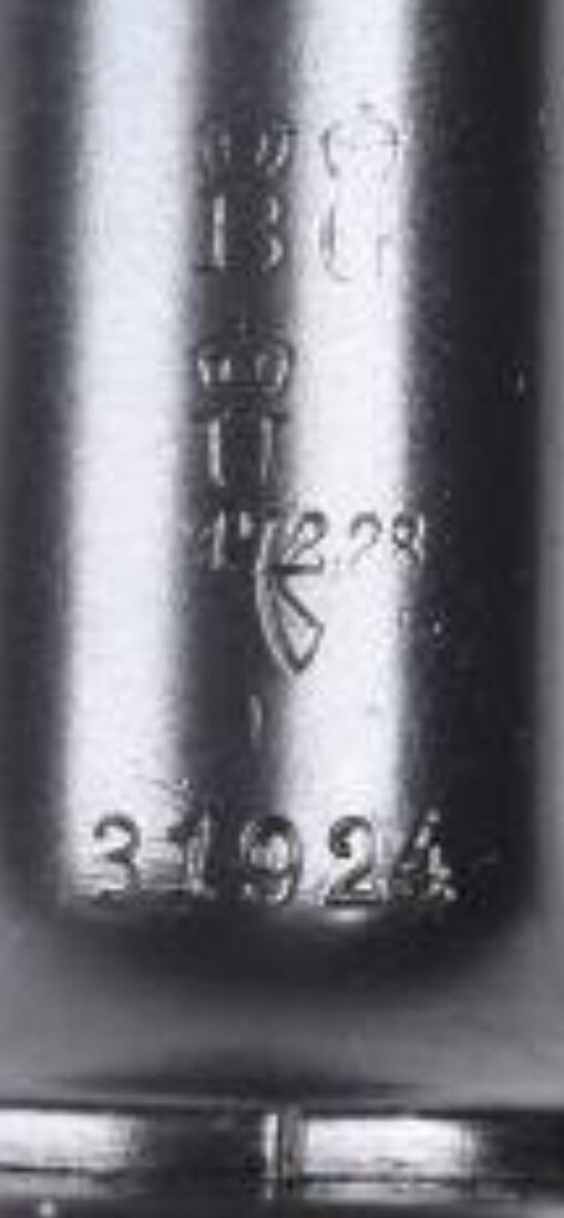

Hello
Are these stamps correct on a 1906?
File Type: jpg 42901749-26BA-40FB-813A-5E60E809FE6A.jpg (46.0 KB, 6158 views)

Pic
File Type: jpg 6014BF81-BBDF-4461-A243-770106034DCE.jpg (63.7 KB, 5740 views)

Yes. The crown/B, U, and G are German civilian proof marks; your pistol is appropriately in the range where that system was in use. The shield with diagonal slash is the mark of a DWM factory inspector. Your pistol is in a known range where these marks were applied.

This pistol isn't listed in Dwight's amazing Commercial Data Base, but would appear (by interpolation) to be among a group of American Eagle Lugers. Is the Great Seal stamped over its chamber?

Posts: 123
Thanked 50 Times in 16 Posts
Don’t see one
