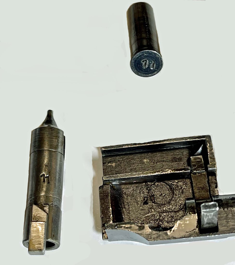

Hallock and Kant says the 41 byf (and 42) should have a numbered rear axel pin (p. 242).
They described small parts in 4 groups:
Group 1: Trigger, Safety Lever, Takedown lever, Hold Open, Rear axle pin, Side plate, Sear bar, Front toggle link, and Rear toggle link.
Group 2: Magazine release and Ejector spring
Group 3: Firing pin (flutted)
Group 4: Coupling link
File Type: jpg 1942 byf 42 2011 L pins and side plate.jpg (122.8 KB, 728 views)

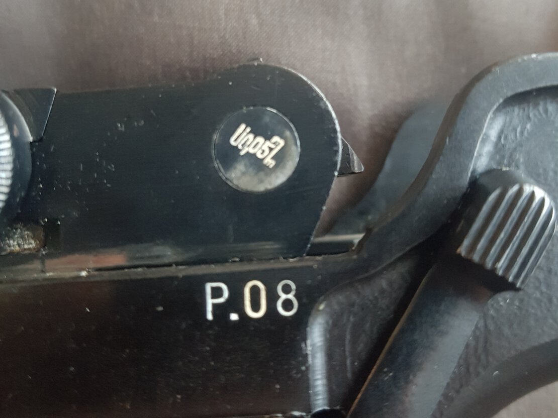

I would not worry too much. But try to get a discount.
Unnumbered pins are not uncommon and sometimes you find nice replacements:

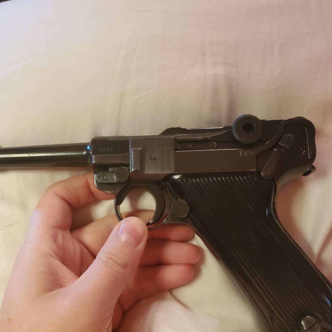

I am curious about the grips though. And I thought black widow also was used because byf 41 and 42 have no visible parts in the white

Iran the gun has a shiny unputted bore and has shot 100 rounds with no malfunctions so it's a great shooter, except for the slightly squishy trigger, it has no import marks and is an early q block, but I'm not sure about the vertical black grips I think they are Russian. IT is original bluing with oxidation visible under bright light and I paid 1600. It was my first luger but having learned alot more now im sure I paid too much. Although I'm happy with the gun

There is no Russian captured marks or force matched parts except for the unmarked toggle pin which I guess could be factory original that missed stamping, but that's very unlikely. The pin is a nice snug perfect fit not too tight and doesn't fall out either.
