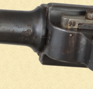

I saw a 1906 Navy come up for sale at Simpson's. Looks like an honest Navy #2693 no suffix. It is not on Norm's list Didn't say if internal #'s match. I noticed that the Navy proof on the barrel was overlayed on the serial #, is that something that happened on occasion? I would think the German's would be a little neater. Anyway, thoughts?

I do not know Navies, however, I have seen police that were commercial with the serial number stamped over the Crown N

I didn't see that one (#2693).
D16517 is S/N 2793 and listed for $5,750
They say it has good rifling and some oxidation (whew, glad it wasn't rusted).
It has a grip strap marking "WD 579" which they say is Danzig Dockyard.
It looks nice, but no mention of matching parts internally.
You should ask.
I would expect they are, though.
Simpson's has a stellar reputation and an impressive inventory.
They are on my Bucket list for a personal visit one day.

Barrel close-ups from S/N 2793

P.S. I see no issues with the gun in question.
