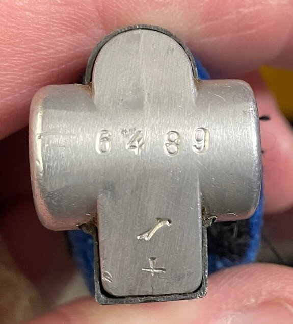

I am trying to determine the character on a luger/magazine.
The character doesn’t match any of the reference material, I have my opinion of what letter it is. I was hoping to get some feedback from some more experienced collectors, all help is welcome.

Thanks: 3,206
That is an X IMO marksluger

Thanks: 120
It's a "r" from 1941.

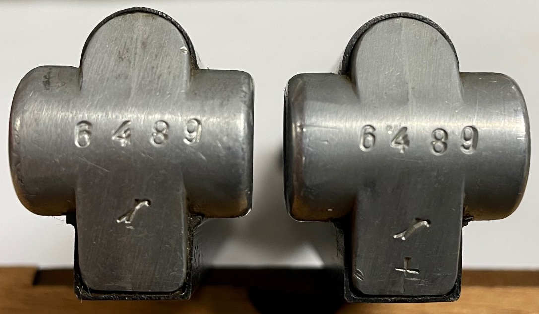

Unread 01-02-2022, 03:42 PM   #4
I agree it's an "r" over a spare mag "+" sign. TH
Unread 01-02-2022, 08:47 PM   #5
Thanks: 2,079
I agree, an r, it is stamped off a bit, like slightly sideways

gunbugs
gunbugs's Avatar
Join Date: Sep 2013
Posts: 683
Thanks: 375
Here's an "r" suffix '41 BYF for comparison. Matching mag. http://forum.lugerforum.com/attachme...1&d=1641182647 http://forum.lugerforum.com/attachme...1&d=1641182647

Thanks to everyone for your input I though it was a “r”.

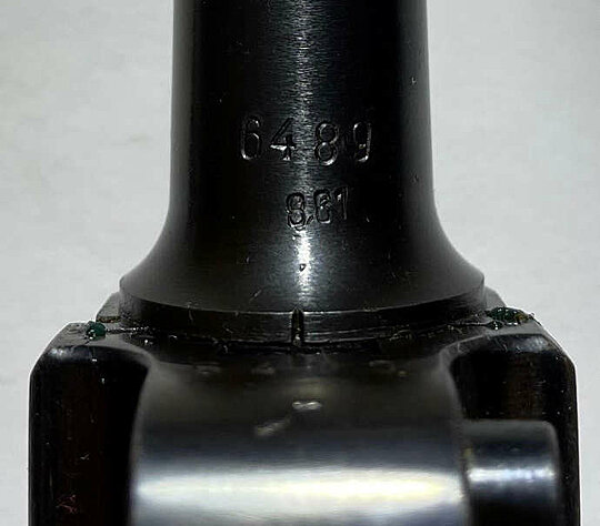

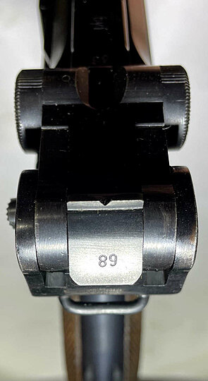

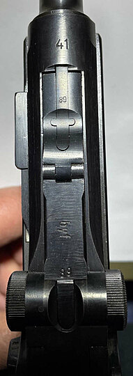

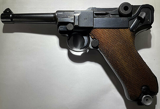

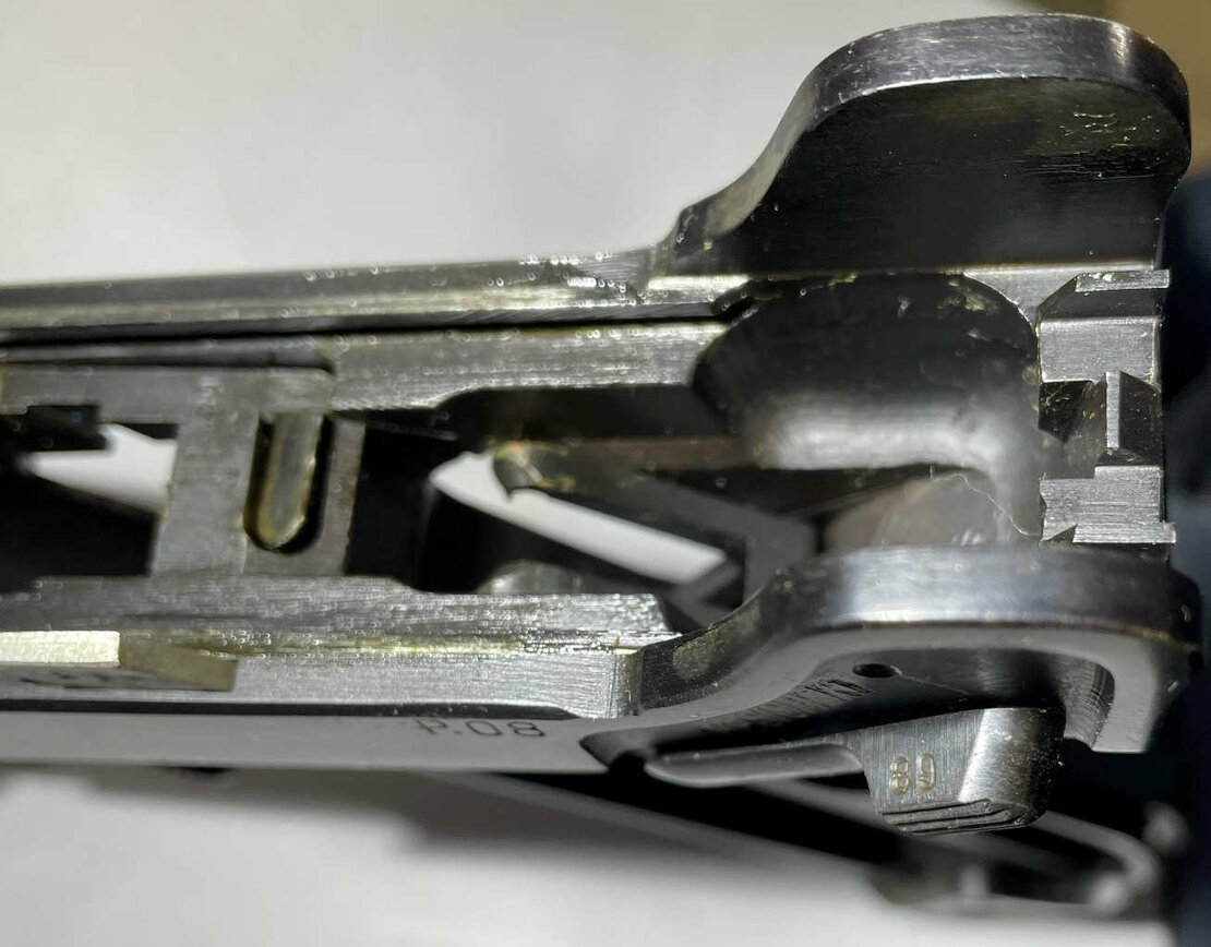

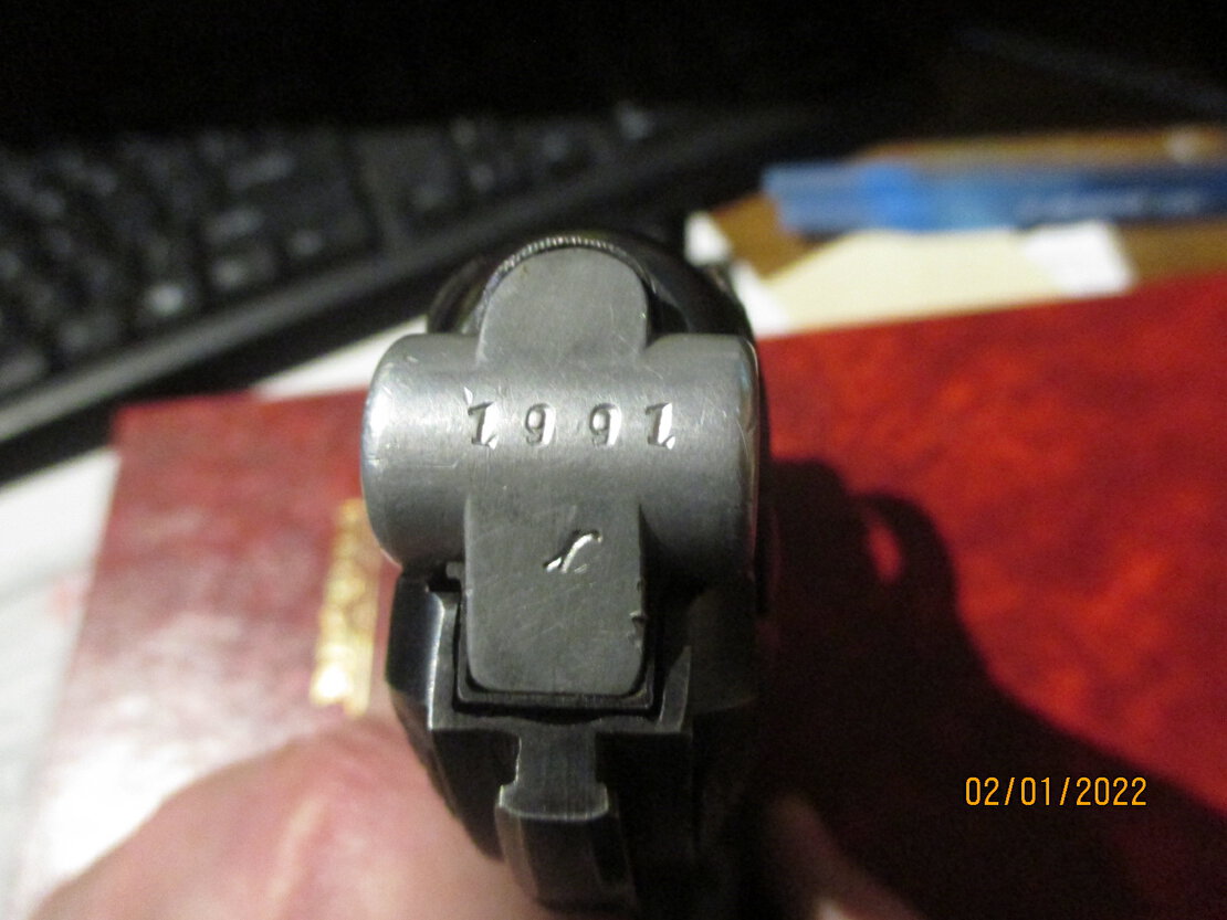

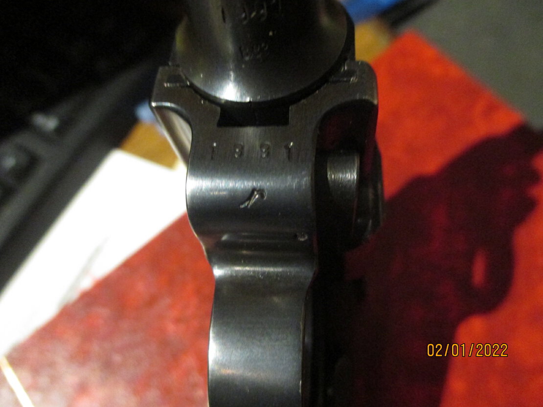

Here are some pictures of my byf 41
marksluger is offline   Reply With Quote

Unread 01-03-2022, 07:48 PM   #8
Mac Cat
Mac Cat's Avatar
Location: Austin, Texas
Posts: 772
Thanks: 2,197
It's a beautiful Luger.
The matching magazines are really special.
I think it has been nicely refinished, because it has no signs of wear.
Your toggle where "byf" is stamped looks very scraped up and doesn't have beveled edges.
And, I agree that the suffix letter is an "X".

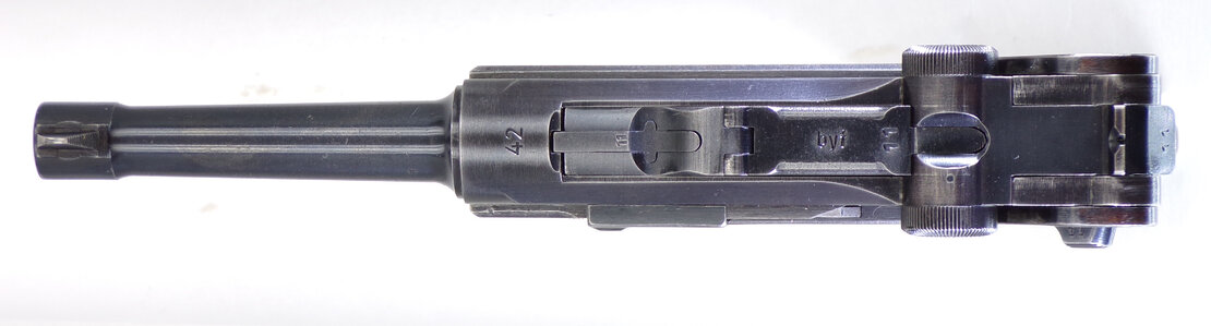

I have a 42 byf that looks very similar (below), except that it has holster rash on the muzzle,
the frame sides, the side plate and scrape marks from the thumb safety.
File Type: jpg 1942 byf 2011 L left with magazine.jpg (140.9 KB, 118 views)
Unread 01-03-2022, 08:49 PM   #9
gunbugs
gunbugs's Avatar
Join Date: Sep 2013
Posts: 683
Thanks: 375
I don't think it has been refinished. It's just an exceptionally nice example. They do exist. I don't see any of the typical signs of a reblue.
