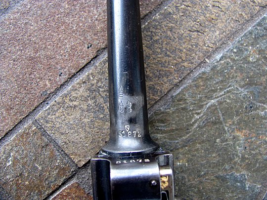

I have yet to see a fake or refinished gun with convincing halos, sometimes the faker even halos the wrong marks or numbers!
Norm
The following 8 members says Thank You to Norme for your post:

I was curious if halos could be replicated after talking with a buddy about certain things to look for in a refinished pistol and the question came up about fake or replicated halos. I didn't know for sure but thought it was possible. Just how good they could be was more of what I wanted to know. Looking at Norm's photos they don't look too good.
