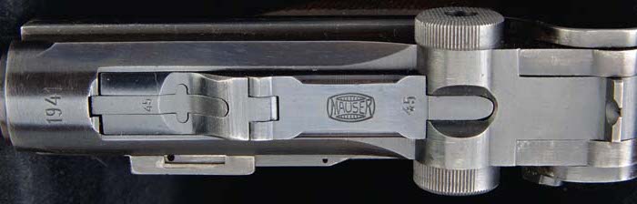

hansfischer, I think the most common Lugers with the Mauser Banner on them are Police issue from 1938-1942. The are "v" suffix foreign contacts with the Mauser Banner that start before that. There are also commercial Banners during Mauser production. I would think a Police Banner would be the easiest to find.

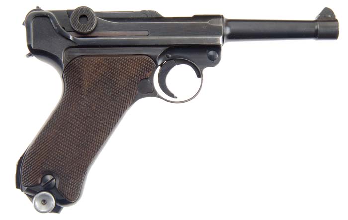

I think he's interested in the earlier banner Mauser.
Here are a couple of pictures I found on Morphy's Austin web site from 2007 (never heard of them before)
