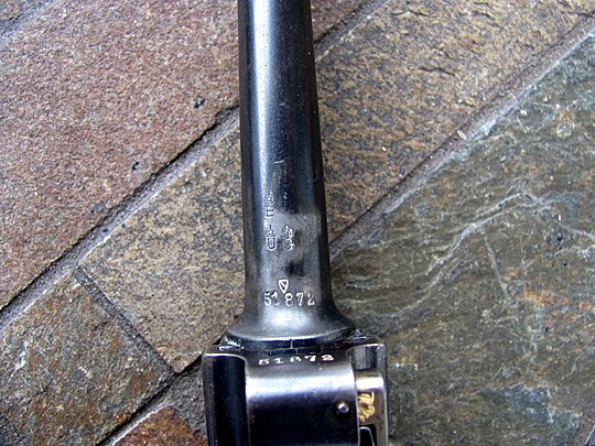

I can see no evidence of a halo around the unit markings and having been stamped through the bluing, the letter and numbers would almost certainly display a halo after 103 years such as seen around the unit markings below. A re-blue will not have a halo around the markings.

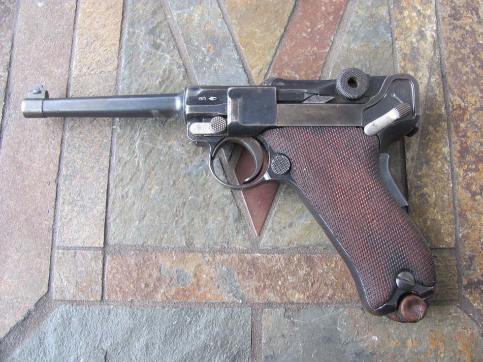

Example of massive halo on 1906 French Contract~

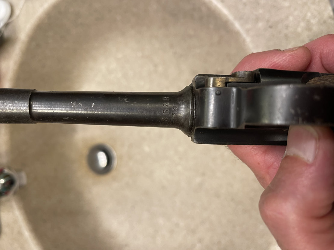

Post a photo of the barrel serial number
Unread 05-14-2021, 07:32 PM   #29
That Is The Barrel serial number #5182, 1906 7.65mm

Here’s a couple of better pics. The markings seem to have a halo.

Much better pictures and there does look to be halo around the unit marking and the barrel serial number indicating original finish.
