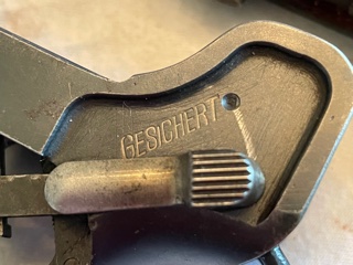

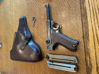

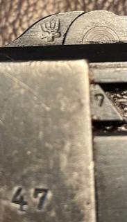

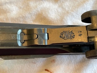

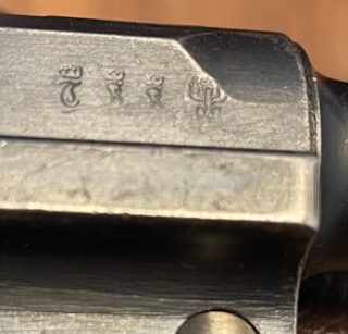

Thank you for your feedback. Here are some pictures that I hope will be helpful. Thank you again!

Judging by the acceptance stamps, it's either a 1917 or 1918 dated DWM.

Thank you for your feedback. The date has been filed off. Would that make the sale value, as I intend to sell it, significantly less? Thank you.

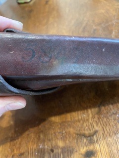

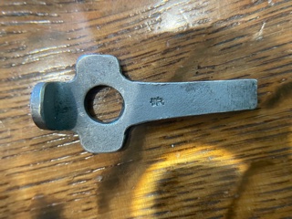

Any numbers or stamps on the holster? Is there a date on the front? Can you provide a photo of the front of the loading tool and mag bottoms?

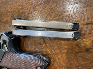

Here are additional photos. Breakdown tool with Symbol; Holster with number stamped; Holster with 5847 stamped; Clip with 5847 stamped; clips' rear view; top of gun date filed. Thank you all for your feedback! Patrick

Unread 07-20-2021, 03:42 PM   #19
You have a shooter grade Luger Filing the date pretty much eliminates collector interest in your pistol. We get a lot of "what's it worth" posts, and many new owners are disappointed.
I really can't make out much detail from your photos. They are too small and some lack focus. I'll assume it's been refinished or left ground and unfinished.
In any case, you may expect $900-$1100 for it all. I would expect to see halos on the barrel gauge stamp so it's likely this pistol has been refinished.
The manipulation is unfortunate, since a unmolested original finish pistol like this with original accessories and matching magazines would go for well over $2500...
