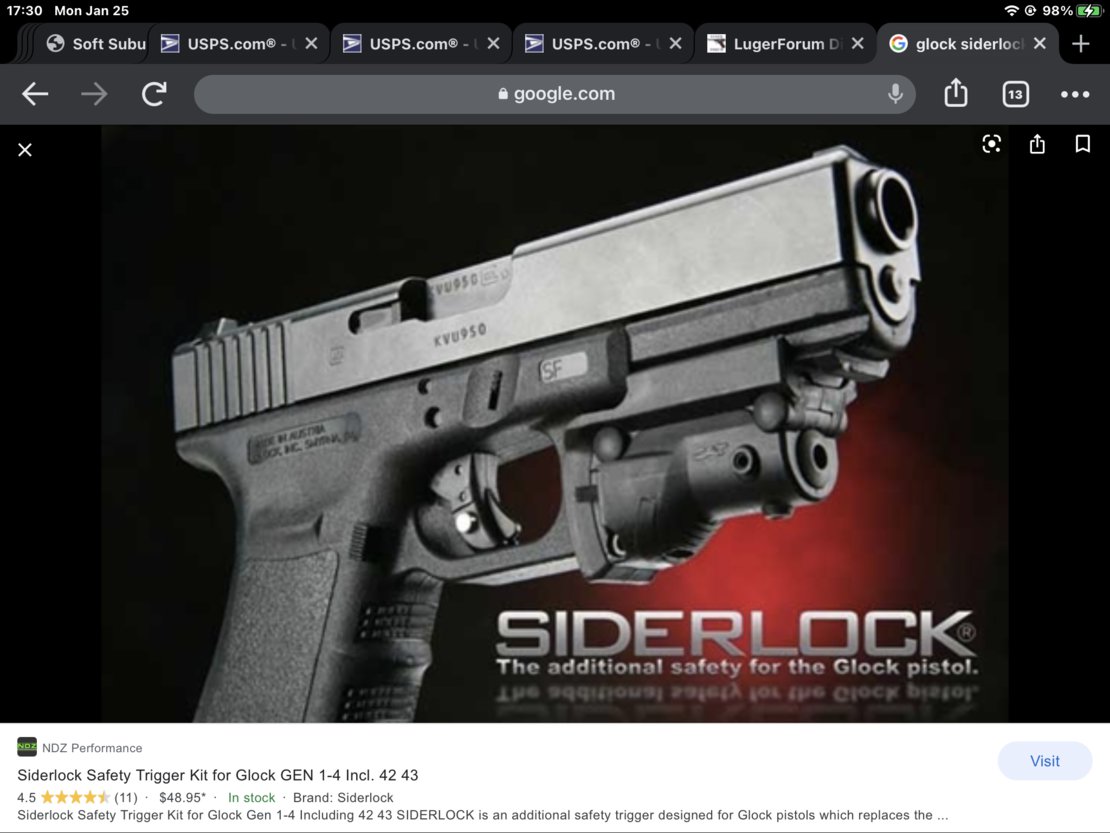

Default Can there be too much safety?
I can somehow see a fearful point of those who insist on multiple layers of safety installed in guns.
Training or not, accidents happen even with the best.
But I would like to be able to see the point of the opposition to having safety devices installed, especially those a shooter can chose to not to engage.
For instance”perfect Glock” and I believe an elegant extra manual safety device called Siderlock.
What is a reasonable argument against having it on the gun?

The reasonable argument, if you have been trained on Glocks, or gone to Glock Armorers class, is that Glocks have plenty of safeties already. And, as we are taught in the most basic safety classes, at the beginning, to NEVER have our finger on the trigger unless we are going to discharge the weapon. If you don't pull the trigger on a Glock, it won't go off. Conversely, if you pull the trigger on a Glock, you can rest assured that it will discharge, if there is a live round in the chamber. No additional safeties are needed on a Glock, unless you are stupid enough to pull the trigger on a live round, when you don't intend to, which I don't understand. But an additional mechanical safety won't keep you from doing that.
