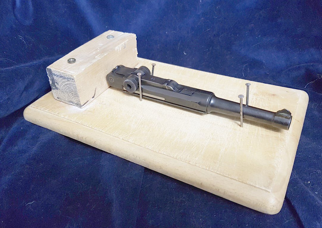

Building the retainer (see image 19):
A wooden slate Q will be nailed to a table top at the rear end. It will absorb the recoil. Close to both sides of the barrel 2 sets of nail are hammered in (N) to prevent sidewards moving of the barrel.
The front pair is to be bent over the barrel to prevent it from jumping upwards.
The rear pair serves to limit sideways movement, but most not block the toggle from jumping upwards.
The test performed this way is harmless
(his words..).
If I would demonstrate it, I'd use an empty primed case instead, but I guess that the sight of a bullet tearing through 2 dummies was also very convincing at the time...
A small interpretation of the original 1928 design I knocked up to show the basic idea of the demonstration setup is added below. Note that the original document described to bend the front two nails over the barrel. I decided not to ruin the finish on the demo upper, so I skipped that part.

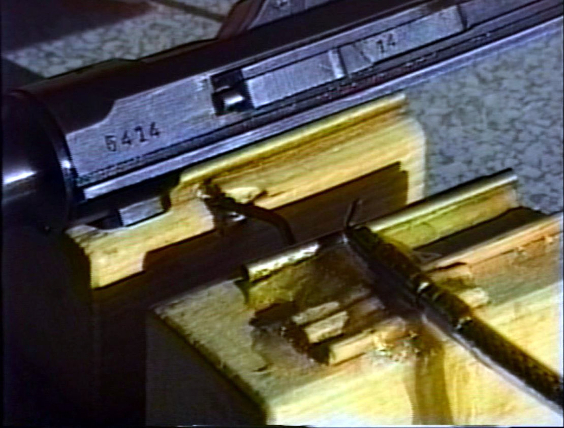

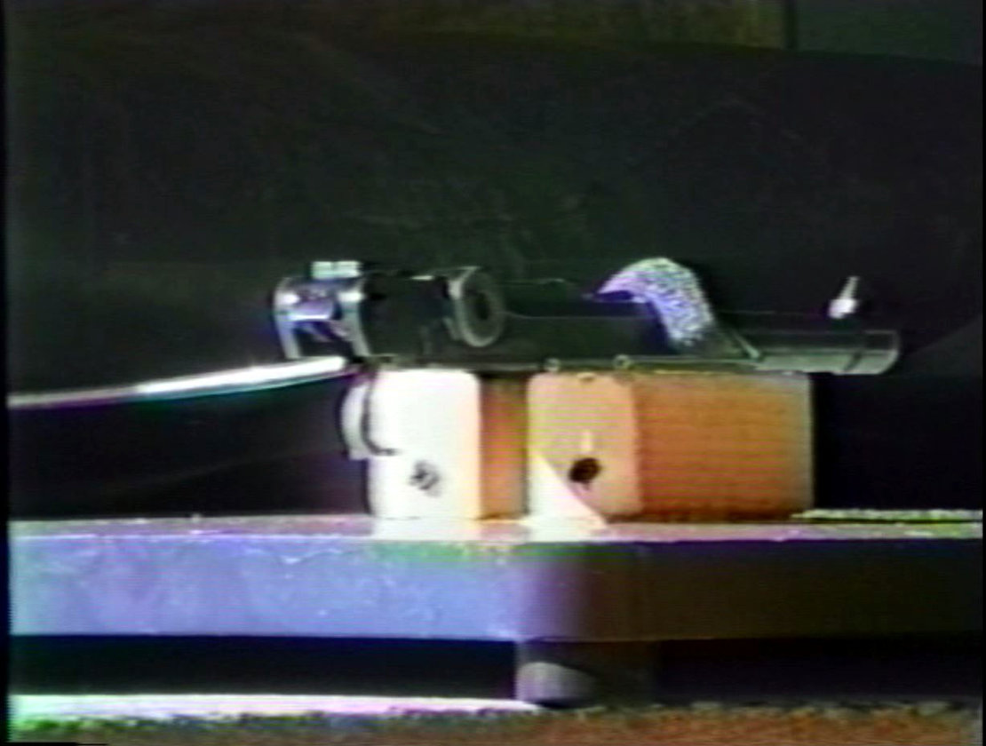

A little over 30 years ago I made some firearms videos, one on German machine guns, one on the Enigma machine, one on Lugers.
I actually did the test you mentioned for my Luger video-screen shots attached.
You can see I used a camera cable release to fire the unit.
The key point-the toggle remained closed.
My jig was just epoxied together and failed on the first test, but that was enough.
About that time, a collector/dealer in our local club mentioned that as a guard of German POWs he had heard or seen that fanatical Nazi prisoners would shoot collaborating POWs with concealed Luger tops.
(I could see holding it in my hand and pushing the sear with my thumbnail.)
