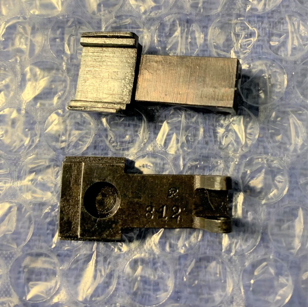

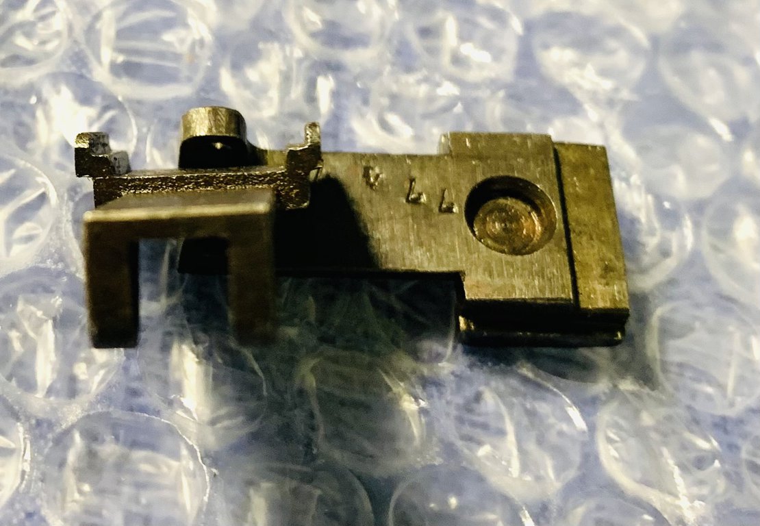

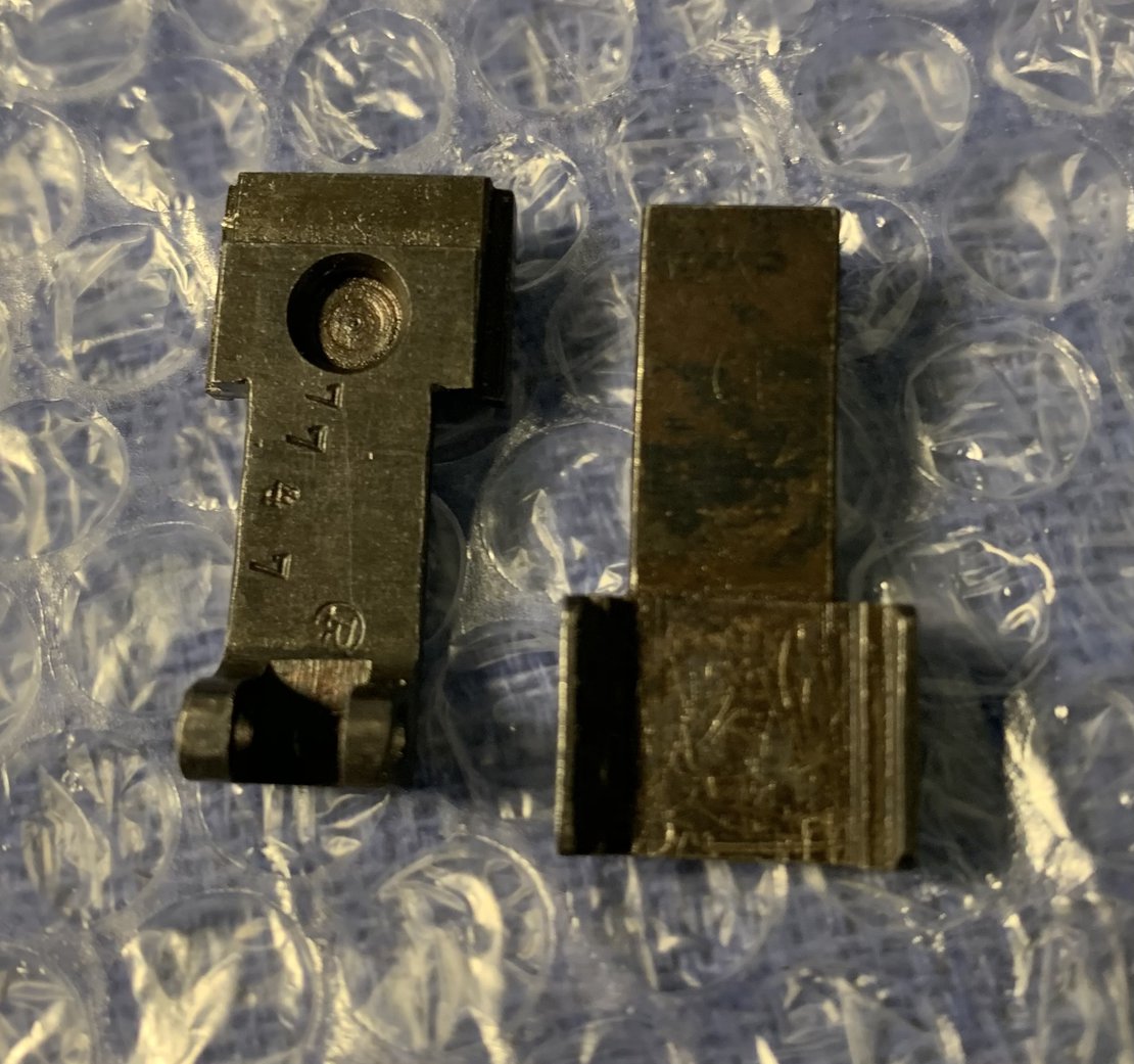

These two "things" came in a lot of luger parts, and they are not for a luger- but what are they for. But I am curious.
They have an assembly or serial number, what looks like a depression for a spring, ears for a pin, one has a script "R" and the other a script "R" in a circle.
Likely a gun part, but I have no idea what for!
Info or guesses welcome.

maybe for a 22 LR version

It isn't a part from an Erma .22 conversion kit.
To me, it appears to be an adjustable rear sight base. The depression would hold the end of a coil spring, and the thing would pivot on a pin through the 2 "ears." But this does not solve the mystery of what gun it would belong on.

I was thinking not a conversion kit but one of these luger lookalikes, perhaps even a metal die cast type?

Seems like a magazine catch to me.

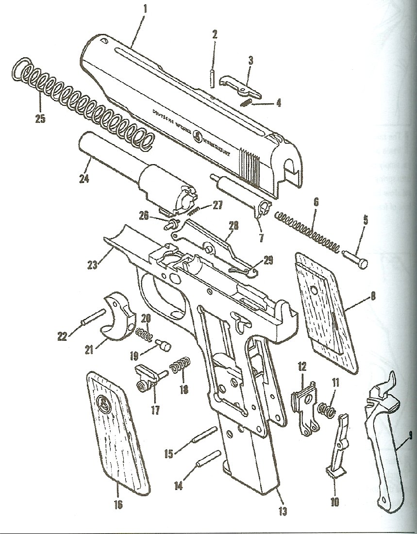

At least one of the parts shown is for a 7.65mm Ortgies pistol, which holds the wood grips to the frame. TH
Tom has nailed it, as usual!

Yes,
It surely appears Tom correct! (and they are both the same).
Thanks Tom.
