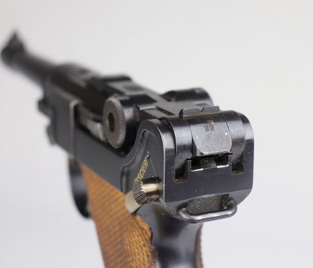

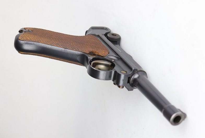

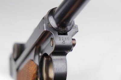

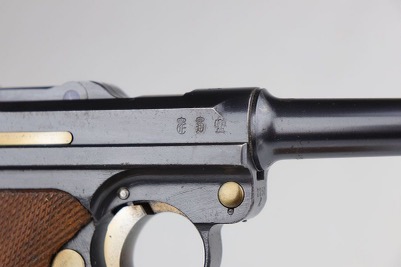

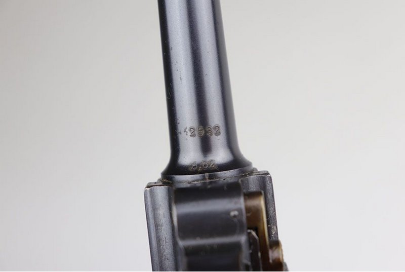

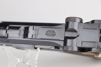

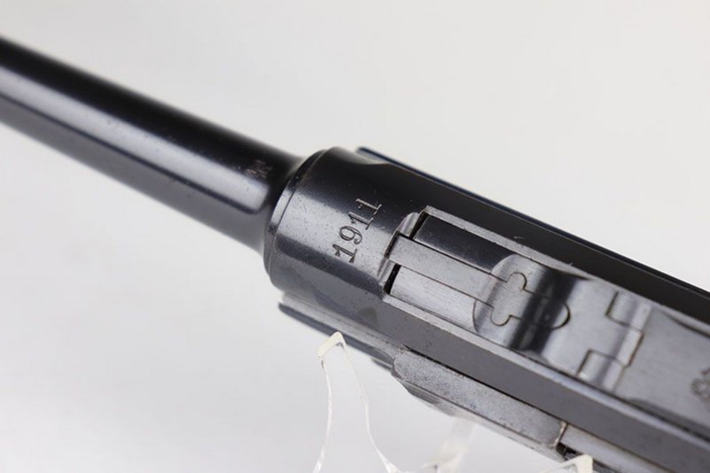

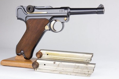

Hello everyone. I’m new to the P08 and I’m considering making my first purchase so I’m here to ask for help from those more educated than myself. This P08 is advertised as follows...
"This is a DWM Luger from WW1 with both original matching magazines. This lugers upper and lower are mismatched but period correct. The receiver is dated 1911 but the frame has a stock lug. the gun is 98% of the original blue but there are a few areas of light oxidation."
My concerns are that it is advertised as mismatched and that the wear is much less than I would expect for a 100 year old gun. Also, if you could give your opinion on price that would be appreciated.

From what I can see, you have a complete 1911 upper mated to a 1913 or later frame. The stock lug appeared late in 1913 production.
You do not show a good side view of the left side of the pistol so I can't see if the side plate is numbered on the side or underneath. If the take down lever (locking bolt) is numbered, it must be on the side as it's not numbered underneath as a first contract locking bolt would have been. First contract Lugers were made in a continuous serial number run from 1909 ~ 1911.
The finish looks awfully good and I see no evidence of a halo around the barrel or frame serial numbers. I may be wrong, but this pistol may have been restored. If so, the work was excellent.

If you are buying a shooter, and the seller guarantees proper function it may be a good choice. Many things make it look refinished to me.
Value, perhaps $900-1000...
Unread 12-12-2020, 06:59 PM   #4
The finish, top and bottom, looks all original to me and if it weren't for the mismatch it would be a valuable gun. As it is, its just a beautiful shooter, worth about $1,200.00 not including the extra mag.

I would expect a realistic market value to be 1000 to 1200, since it is two different guns that have been "married". (A mismatched gun). The finish looks nice to me.

Sooo...what do the "two matching" magazines look like? The bottoms that is.
So just to clarify...it’s not as valuable as some (others like a matching gun that has not been refurbished in the past.) because it’s not a matching gun and it has probably been refurbished in the past? YES!

-He shows one mag bottom.
Numbered, but don't look original.
A pretty shooter for $1000-1200.

Mike, Thanks! Don't know how I missed that! After seeing it I think some monkey business be going on here..

This one is shiny, but I doubt it is original finish , partially because the top and bottom match so closely when somehow both of the originals had something bad happen to their respective missing component. But, it is hard to tell on those photos and if you look close there appears to be some pitting, but I cannot tell if it is under the blue or just ageing.

Thanks: 2,750
Look at the rear of the frame. This Luger has been shot VERY little if at all since the refinish......no/maybe hint, of toggle train marks. If one were looking for a shooter, I would want the seller to warranty that this Luger performs correctly because of the mismatched parts. To me, that price is too high for what you would be getting. That mag number font looks incorrect to me.

That mag number font looks incorrect to me. Yes, since It was made last week with modern number dies.

Thanks for all of the opinions guys. I think the seller feels it is more valuable than it actually is. As for me I had my reservations and now you have confirmed them. I'm really looking for something that is nice but not a museum piece and that I can take to the range every now and then.

I assess this pistol as a quality refinish/restoration. Wether it is worth what the seller is asking depends on the buyer.
If a basic shooter costs roughly $1,000, and a quality refinish/resotration costs $400 (that is what Charles Danner quoted me a few years back, before he stopped doing the work), then there's a dealer premium of $200 here.
For that $200 premium you get a return guarantee and delivery in a few days and are spared having to spend additional time searching. There is a risk to get burned on any Luger transaction and dealers decrease some (not all) of that risk. So the dealer premium may have value to some people. Probably not to experienced collectors, but not all Luger purchasers are experienced collectors. Every Luger collector was once a newbie.
To me this pistol is ballpark-OK priced for a quality restored/refinished shooter from a dealer. For $1,600 an original finish collectible can be found. But that takes time, effort and some combination of knowledge and luck, and a willingness to wear certain risks. So it depends on the buyer if this gun is worth the asking price.
