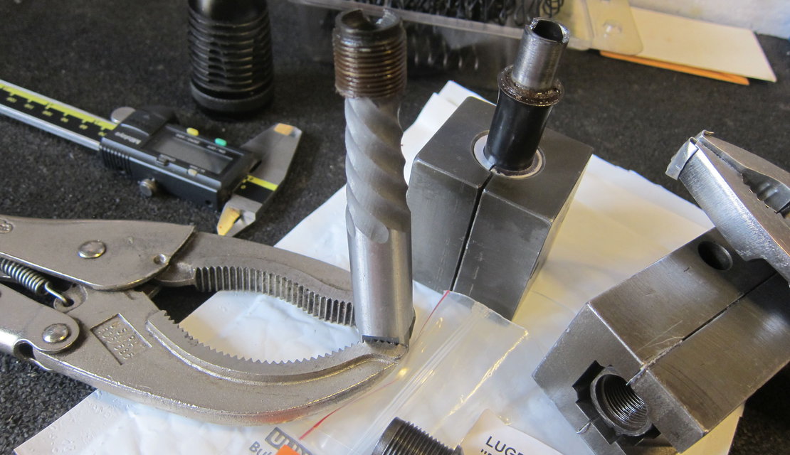

Hi To all! Well, it's out, and all is well! At least we're onto the assembly leg of the barrel replacement sprint! A picture is to follow, as I'm not adapt at putting them / it, onto a forum post?... I'll see if Ed or Don, can make it so, should explain all.. .... Best to all.....til.....lat'r.....GT....
BTW, it's a No. 7 spiral Easy out, approx. .560" hole
posted ebt

So you cut the barrel and used an easy-out....
Looks like the barrel broke..No need for an easy out if you can grab hold of a good solid barrel?
Unread 07-21-2020, 07:08 PM   #19
Was an adhesive originally used to hold it all together?
Unread 07-21-2020, 07:13 PM   #20
tomaustin
Lifer X5
Join Date: Sep 2008
Location: texas
Posts: 708
Thanks: 87
what happened to the pin ???
