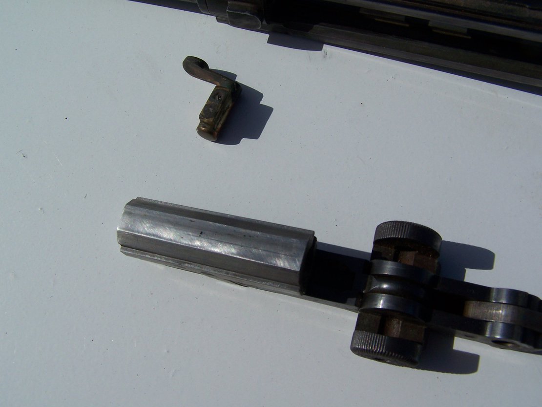

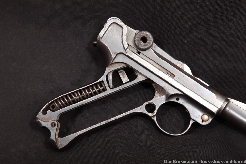

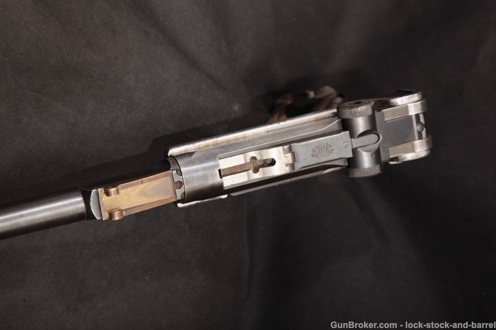

I bought this pistol at auction without knowing about the strange things that exist in this Luger . i was aware that it is a 1906 Commercial frame and mis-matched 7 inch shortened barrel . The two toggle links match the frame . Obvious good project gun or parts gun . I have no idea what to think of the oddities ?
First is the receiver / barrel extension does not have a hole in the back for the toggle axle pin , and there are no proofs or serial number . This part also has a small flat across the chamber from front to back . This part is also fully period type blued and does not look like it was scrubbed of any old markings .
Second is the breech block is in the white and not completed in the manufacture / making machining , and no markings .

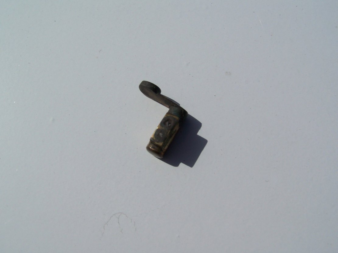

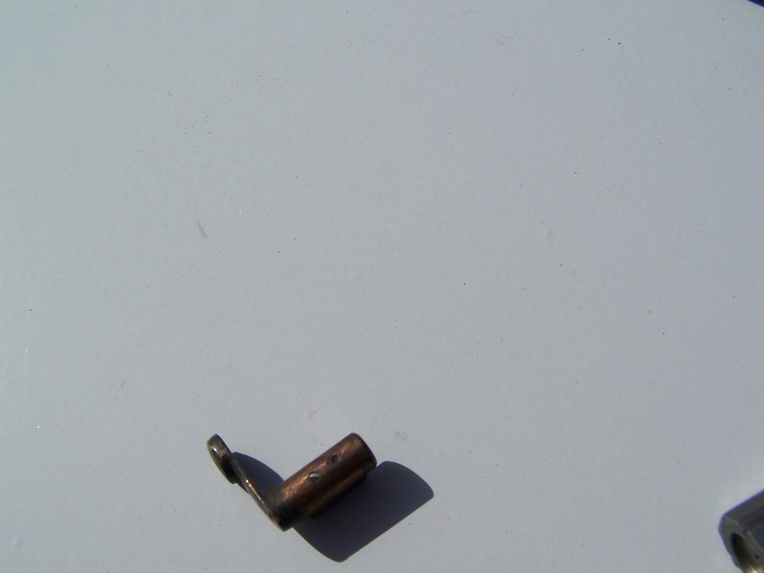

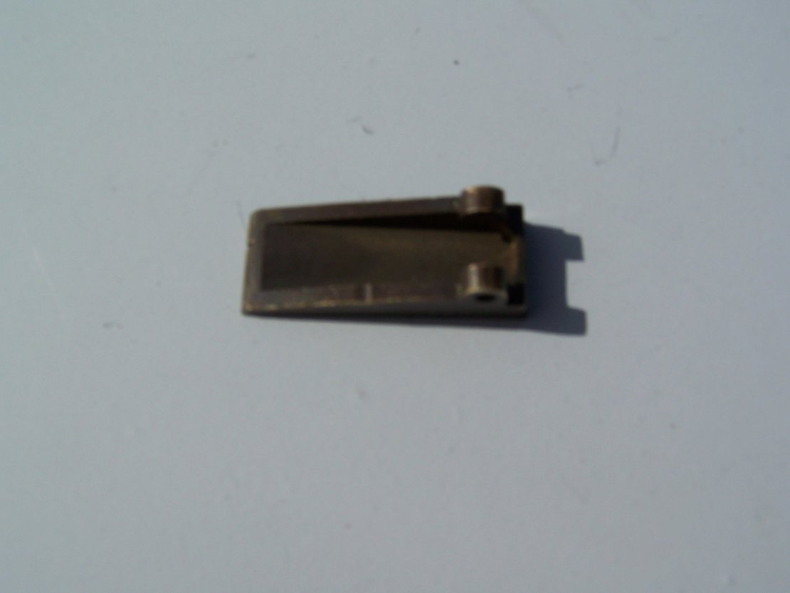

Third is the brass rear sight base and the locking bolt that is a composite piece of copper and brass pinned together ; also the breech block pin is brass . These parts all show quality manufacture .

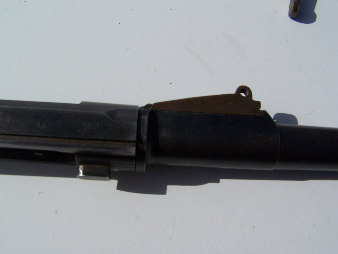

I've seen several LPO8s that originally had a fine tune front sights that froze up and it seems the standard Weimar era repair was to cut off the front of the barrel at the rear of the sight base and either weld on a C96 fixed front sight or sleeve on a new standard P08 front sight & base, which appears to have been removed from this one. TH

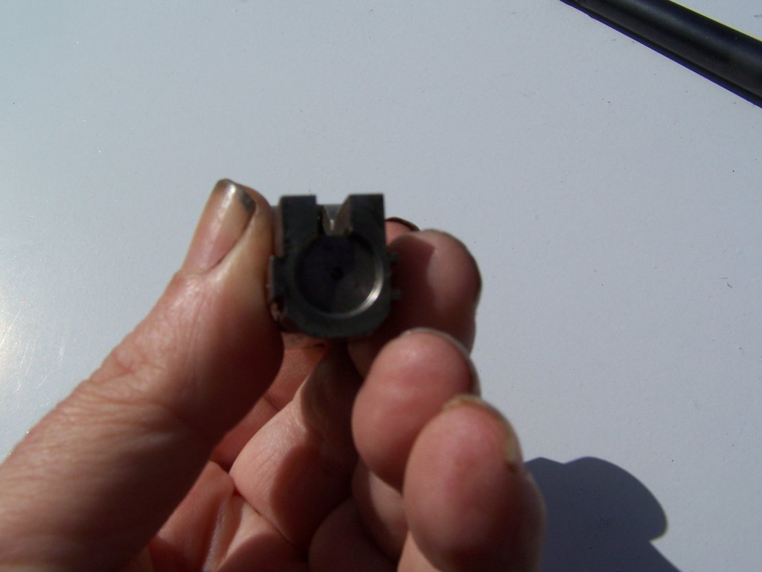

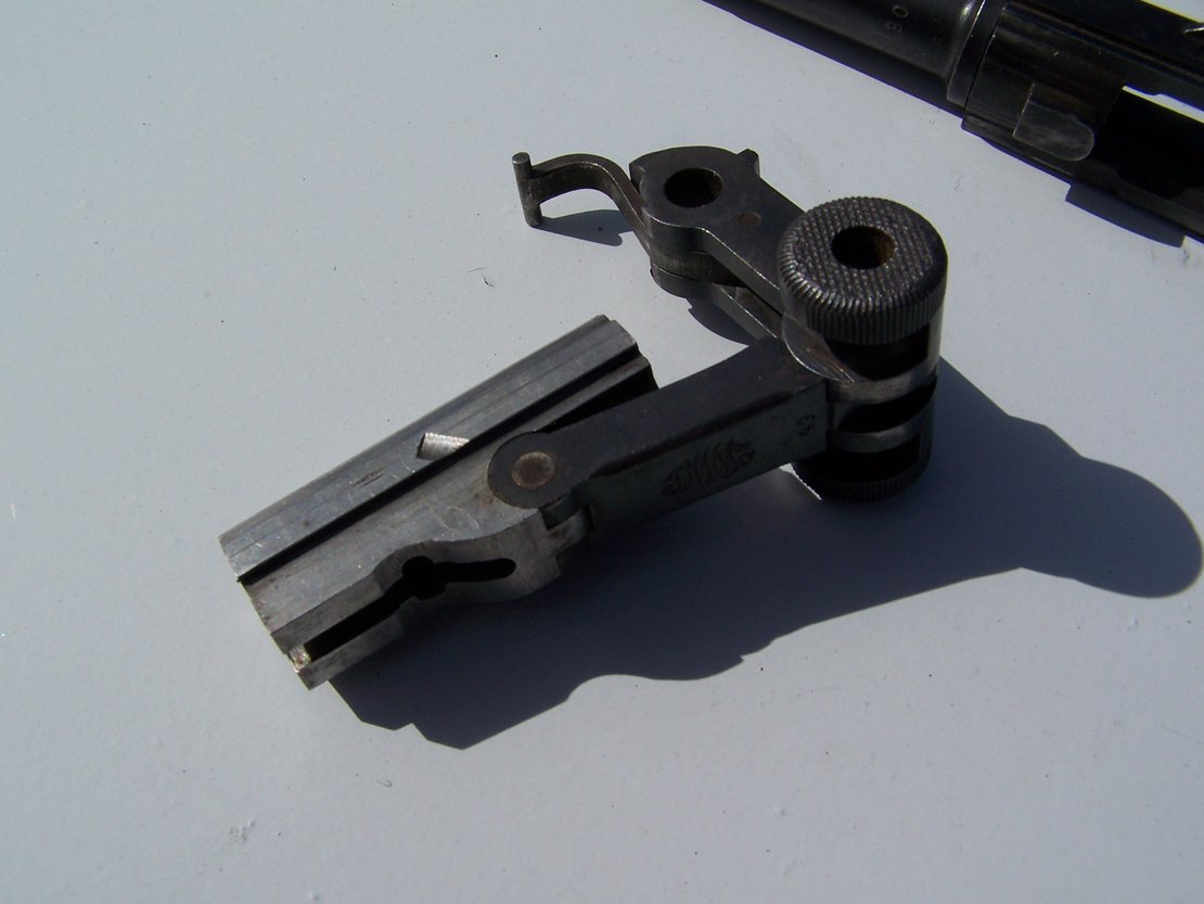

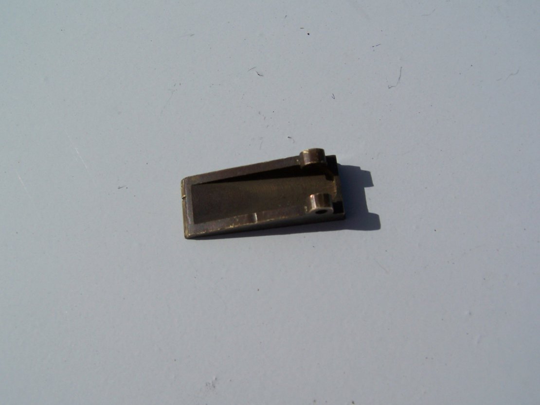

I am just a beginner in taking pictures so I hope this will give everyone a idea of the strange things that I mention describing this Luger . Please note that a firing pin can not be installed in the breech block and it is not fully machined on the top and bottom .

Yes, the breech block is not "finished" and pretty much worthless.
Ditto for the receiver.
The take down lever is not complete, and non-functional.
I'm sorry to say that only the frame and the rear part of the toggle, maybe the barrel would be useable.
If possible, I'd return this purchase.

here is some more pictures that might show the issues that I describe better .
