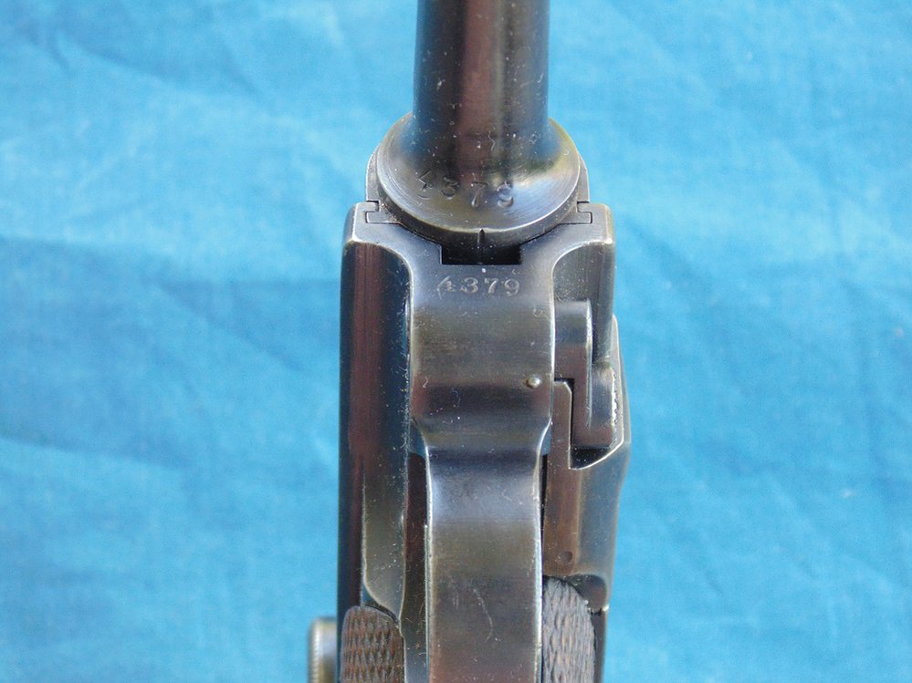

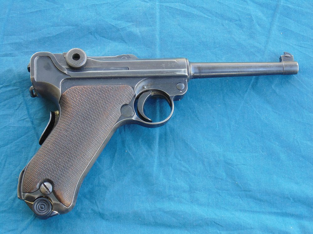

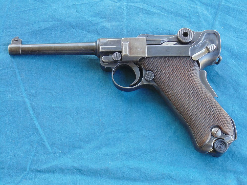

I named this Swiss cheese because I thought some of you knowledgeable people might shoot holes in what I was told when I bought this pistol.
The story was that this is a 1920 rework that was sent to Switzerland, The 7.65mm barrel was then installed by the Swiss and has no proof marks.
The numbers match but some parts have no number. The magazine is unnumbered with a wooden bottom. I had a 1920 rework before with the typical 3.75" barrel, and the chamber date and stock lug ground off. I know if this is a 1920 it is not typical.
So is this as I was told or something put together by Billy Bob and associates? I bought it for a shooter price. I am sure I don't need to say I am new here and am no photographer. Thank you.
I am somewhat of a weirdo because I am only interested in 7.65's with 4.75" or longer barrels. They are beautiful to me.

It is truly a mixmaster.
A grip safety with a lug almost has to be an ex-Navy pistol; commercial grip safety pistols had no lug at all- they were "slick backs". There appears to be evidence of previous safety markings that have been altered, which could indicate a modified first type Navy frame.

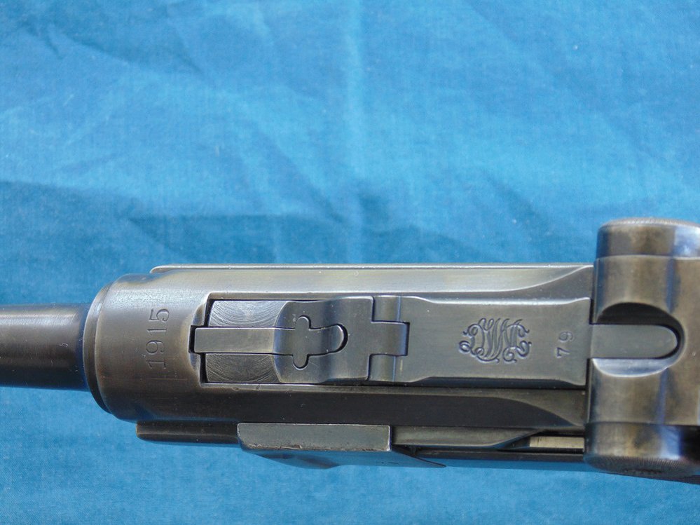

The 1915 dated receiver is military and would have been in 9mm when made.
When or who put it together is not likely to every be known with any certainty; I'd discount completely the Swiss story; though anything is possible. JMHO.

It‘s possible that the pistol was converted to „Swiss standard“ sometime in Switzerland. I know e.g. from byf 42, which was converted in a similar way. The grip safety was added in the Waffenfabrik Bern and the barrel was changed in a gun shop in Bern.

I'm going agree with Stucki's reply as being the most plausible. Had the frame been from a Navy with a stock lug and grip safety it would have been a long frame. This frame is short to fit the short 1915 receiver. I agree it's most likely Swiss modified with the grip safety added. The non-military Swiss barrel doesn't have to be proofed.
I'd like to see beneath the safety lever to see if it is now an up-safety with the lower area marked or polished.

The safety is on with lever up and lower area of frame is polished just like the rest of the pistol. I thought it must be a P08 reworked, but I definitely don't qualify as an authority. Anyway it sounds like the story could be true, even if we don't know for certain.
I actually wish the stock lug was ground off when the rest of the modifications were performed. The ones without just point better. Don't worry, I'm not planning any alterations. I have a 06/73 in 7.65 with a 6" barrel and one of these days I'm going to get a "real" 1906. They are the ultimate to me.

The 1916/1917 navy frames were short; many long frames have been shortened over the years also.
Of course if the frame was modified by the Swiss by adding a grip safety it could just as easily be any P 08 type frame and not necessarily a Navy frame with original grip safety.
Close examination of the grip safety installation should discern whether it was added or not.
