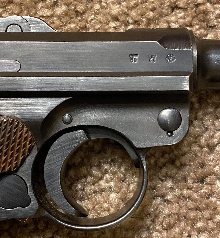

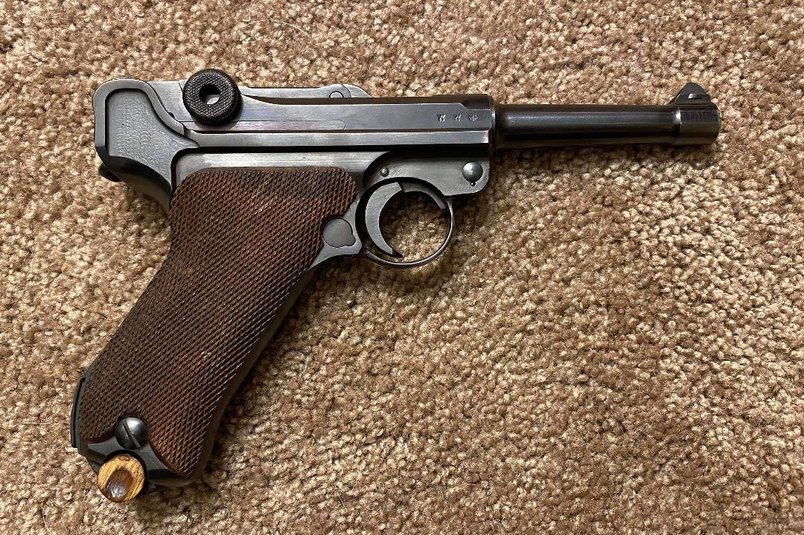

I have an opportunity to purchase this 1939 S/42 Police luger. Can I get some opinions are what you think and a fair price to pay?
Thanks all

Maybe just me, I don't see police acceptance marks.

Your right Mike. I did some research and I'm pretty sure this is an army Luger...It should have a Police acceptance stamp IMO.
The one I'm looking at is #9877N
1939 DATED S/42 CODE ARMY LUGER
Figure 5. S/42 code,1939 dated Luger, serial number 9078n. Left slant view. Note the exposed style of serial number placement and Mauser hump at rear of frame. An Army Luger. Note: the reddish receiver. This was the result of an in balance in the bluing chemicals. The hardened receiver took a more reddish hue.
corby34 is offline   Reply With Quote

Wouldn't the sear safety still be an indicator of police use?

The magazine in not correct for the year; should have an aluminum base.
Otherwise it appears to have the original finish and is in really nice condition. The lack of police acceptance stamps will effect value.

John, Very nice looking pistol but it is not a Police per se. it was born an Army and accepted as an Army. It shouldn't have any police markings except perhaps on a replacement aluminum Police magazine. If these Army examples conscripted into Police usage indicated by the sear safety bar have any police markings, I am not aware of them. But even with some sort of Police proof..that isn't worth any kind pf premium to me.
By the bar over the sideplate..we know it was used by the Police at some time somewhere. As a straight Army in this condition it would be more valuable than as a Police IMO. Police in most configurations like this are not as desirable as an Army. I don't know why, that's just what I see.
The mag is improper & broken. Is it the only one?
Too there are other considerations, is it ALL matching? Bore condition?
Personally $1,500 would be top of the mark for me. $4,500 will buy you a WHOLE LOT of Luger..and this ain't a WHOLE LOT of Luger worth $4,500. Although the condition from the pics is dang nice.

John, This is not confusing at all. Re read the posts. Born an Army gun conscripted/drafted into Police use. We know this because of the sear safety. Not any more complicated than that. There is little else to discover...

The book "The Mauser Parabellum"(pages 193-200) estimates 2,350 1939 S/42 Lugers were redirected to the Police in Berlin. Most of these are in the "n" suffix block. These all have military acceptance stamps, sear safeties, and no Police markings. The original matching magazines may have a 1 or a 2 added to them.
