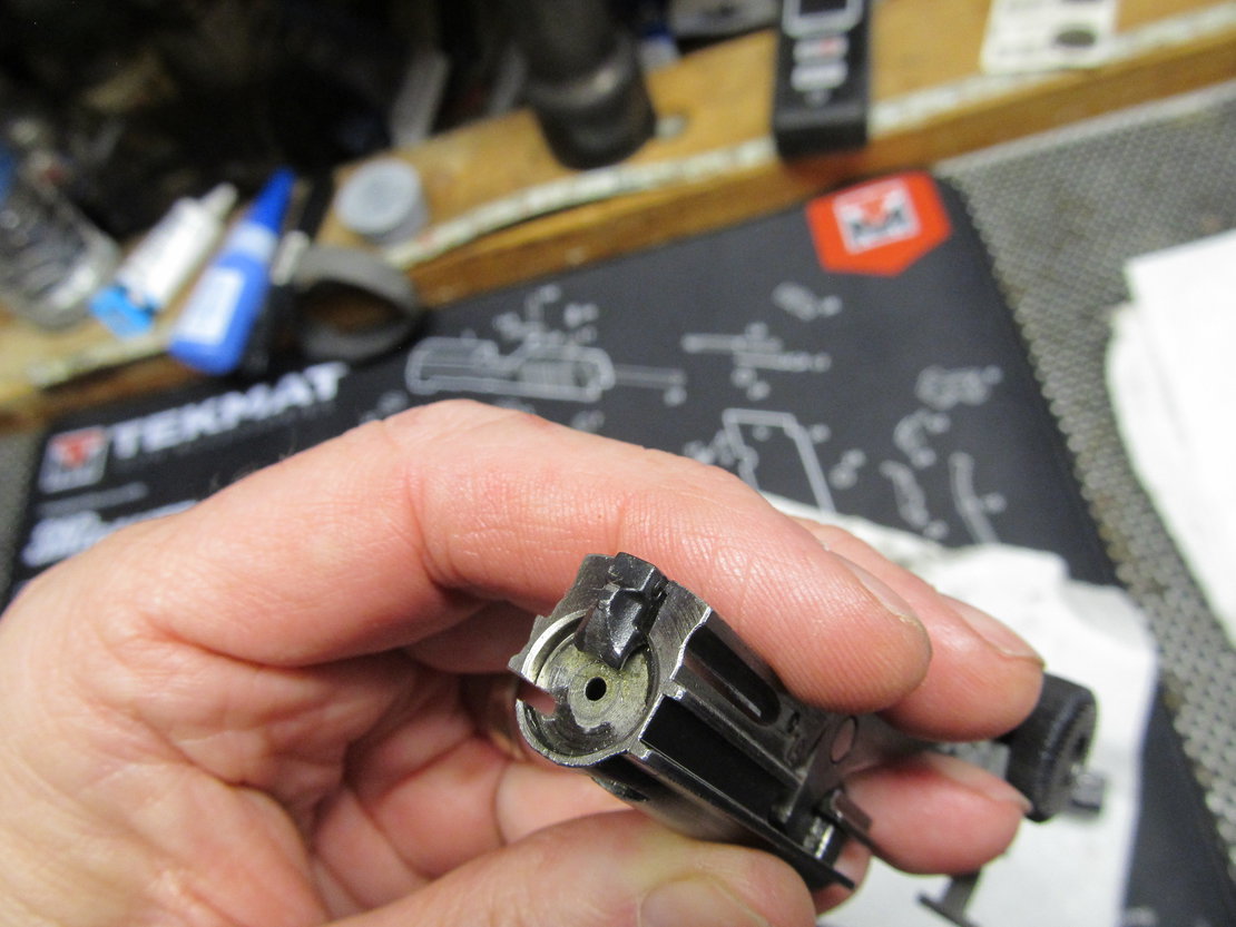

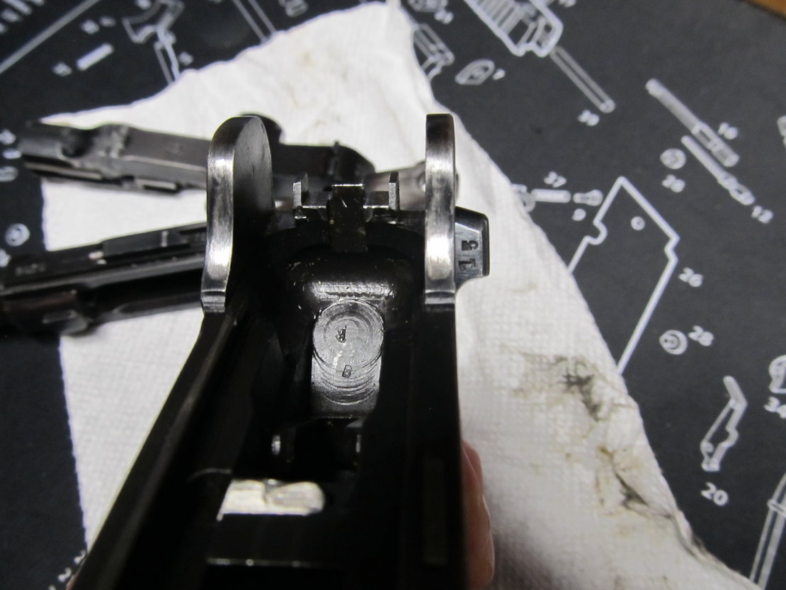

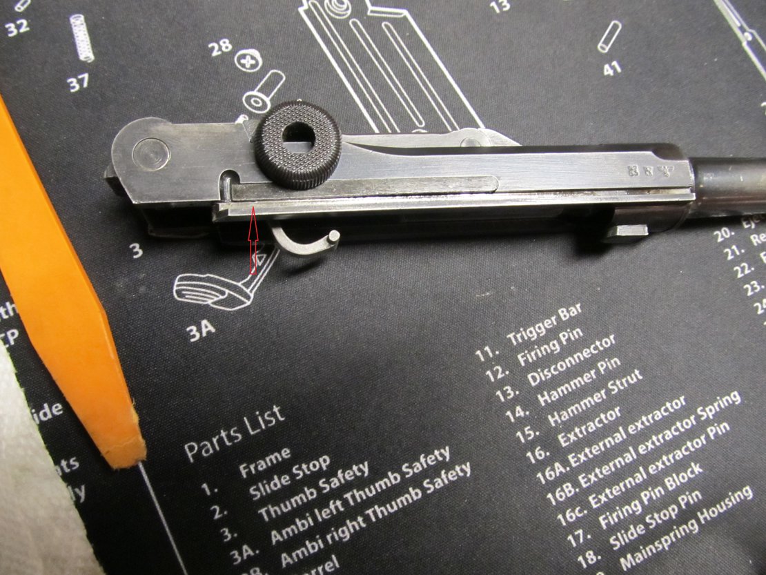

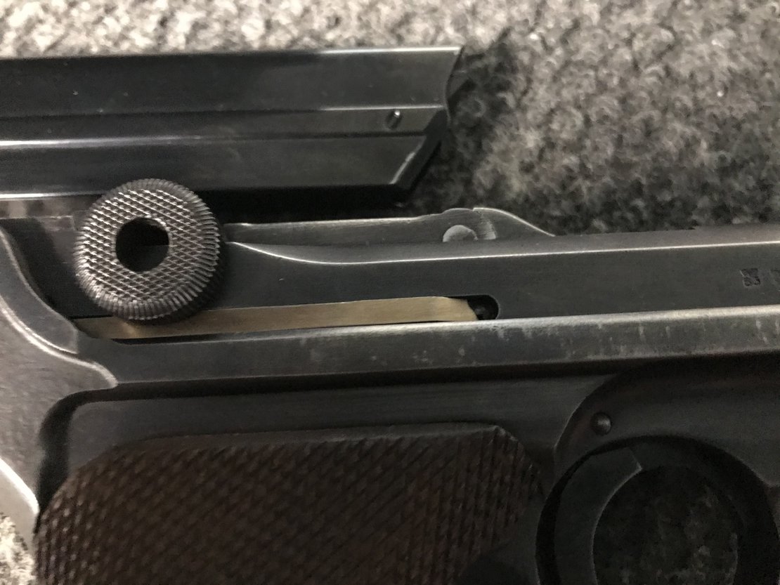

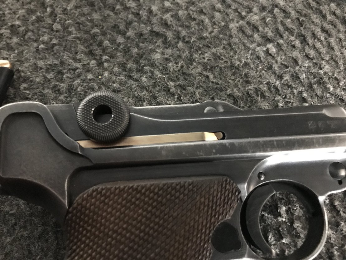

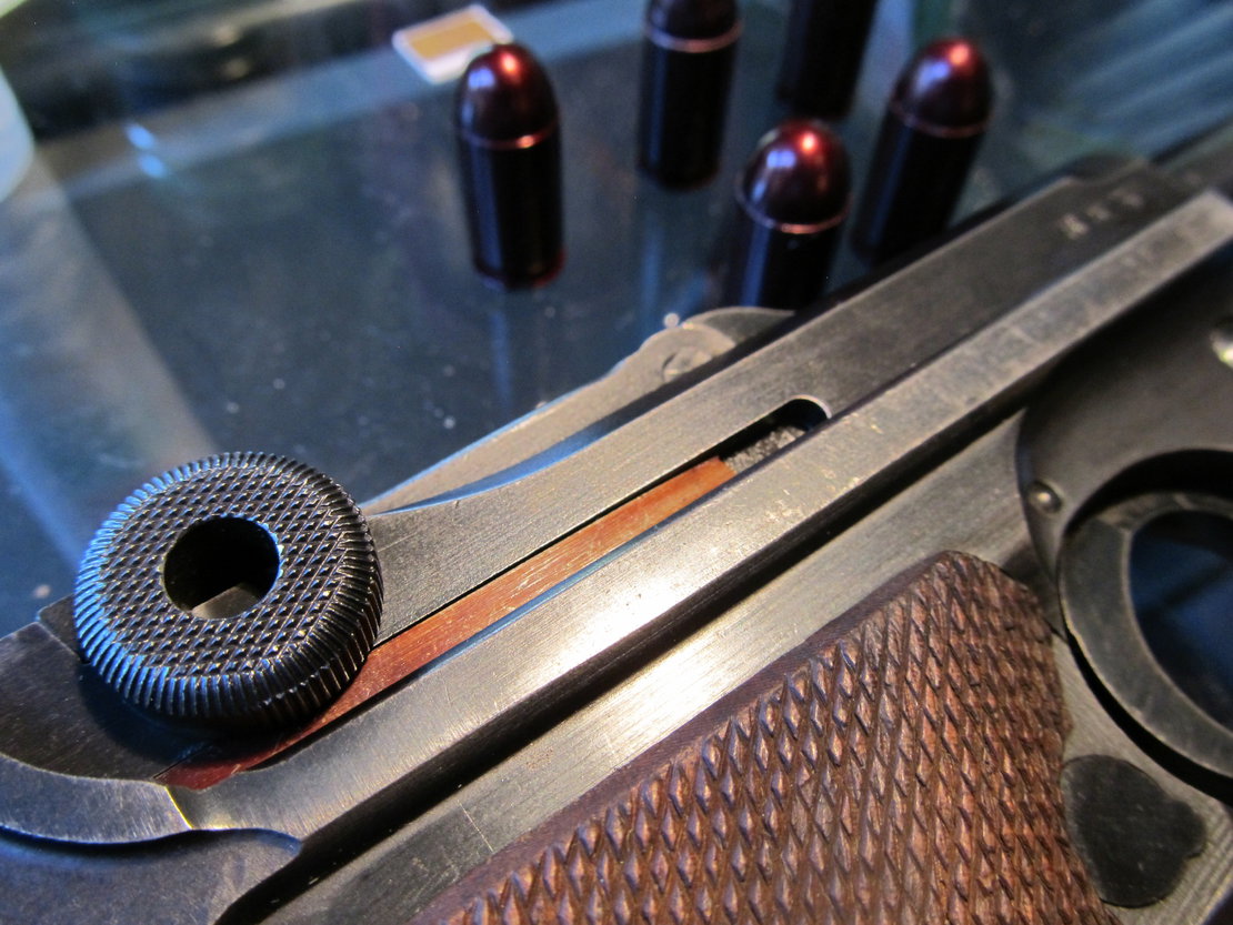

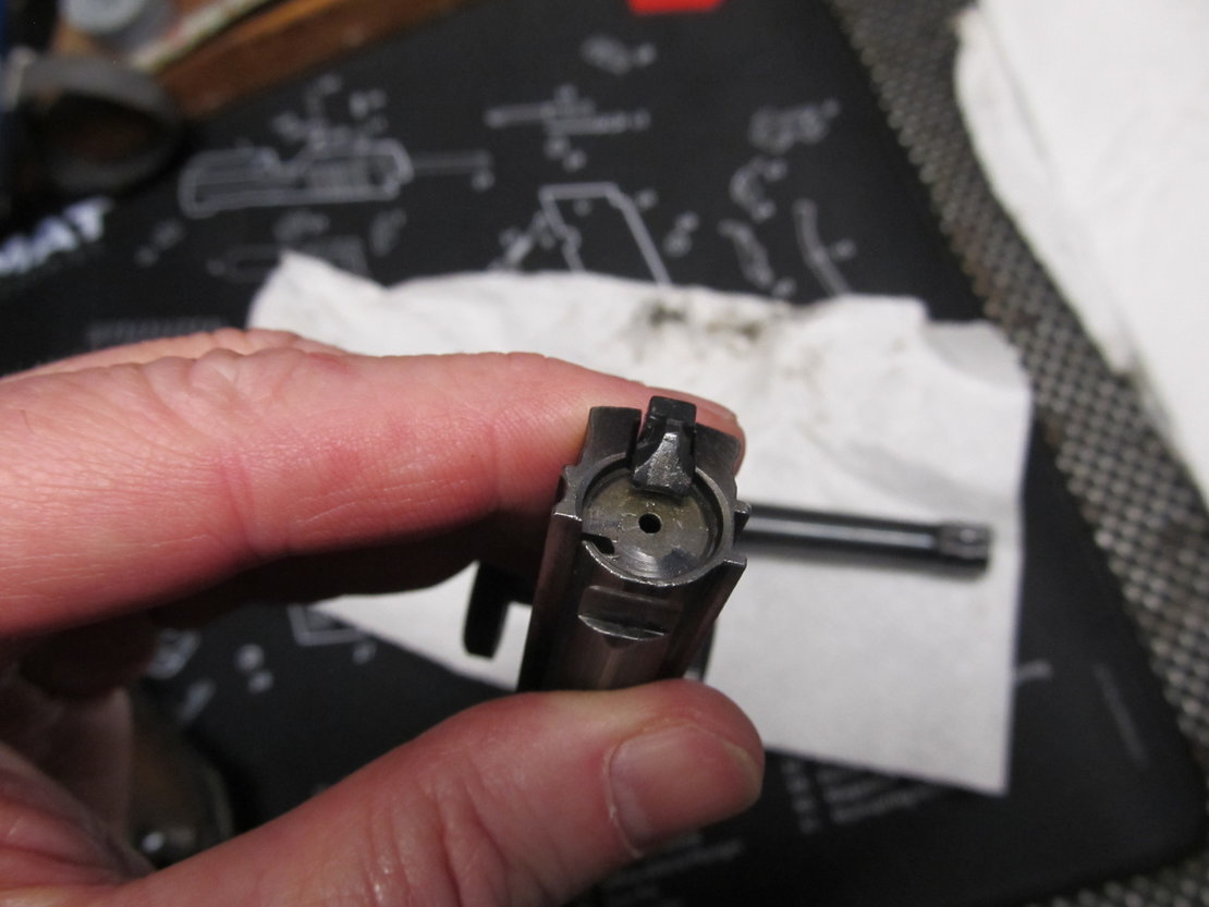

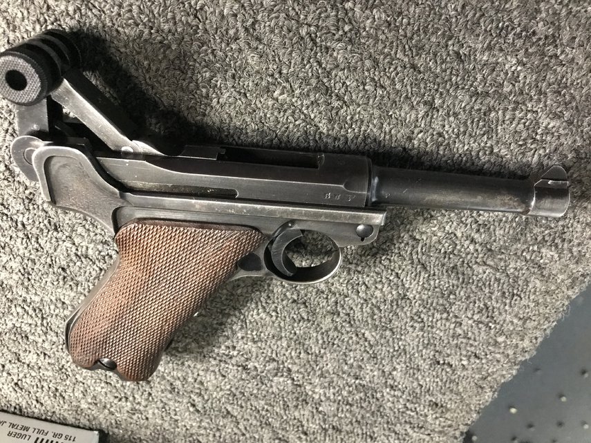

Hello,
I purchased the P08 in the spring of 2018. The original plum ejector failed the first time I took it to the range (image 8798), after maybe 18 rounds. I subsequently installed an ejector purchased from SARCO; this ejector lasted about 25 rounds (image 8840txt).
Next I installed a strawed ejector purchased from InterArms. This just failed today, after firing some 53 rounds (image 0582).
One anomaly: the original matching-number breech block is chipped, as shown on the attached photo (image 8666). I replaced this breech block with a WWII (non-matching) breech block, but by the time I did the strawed ejector was already noticeably bent/deformed (as shown on image 0581).
I’ve been shooting WWB 115 grain exclusively.
Thoughts on what could be causing the ejectors to keep failing? I’d like to be able to shoot the gun (say) once a year, without having to install a new ejector.
Other than the ejector, the pistol is functioning properly.
Thanks!

It would seem that the rear of the breech block is catching the front edge of the ejector, and bending/breaking it on the rearward stroke. It may require some fitting to the ejector to get it to clear the slot in the breech block correctly. I would disassemble the breech block from the toggle train, and see how it slides past the ejector by itself. Try to see how it is getting caught up and bent. There should be a slight amount of spring travel to the ejector as the breech block slides past, but it shouldn't be catching on anything.

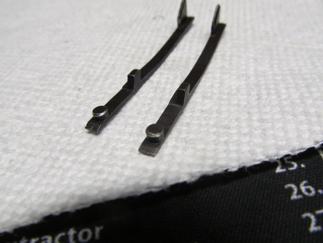

Maybe just bad luck on the ejectors, as they failed in different ways.
The ejector must fit the receiver correctly, and they can be too long at the front - which interferes with their movement.
While they are "supposed" to be interchangeable, there is enough tolerance shift to create the occasional problem- especially with reproduction/replacement ejectors.
I think the lower one was too long, and should have had a file or stone stroke or ten to achieve sufficient clearance at the forward curve of the ejector/receiver - they should not contact there, so you have to create clearance with some combinations.

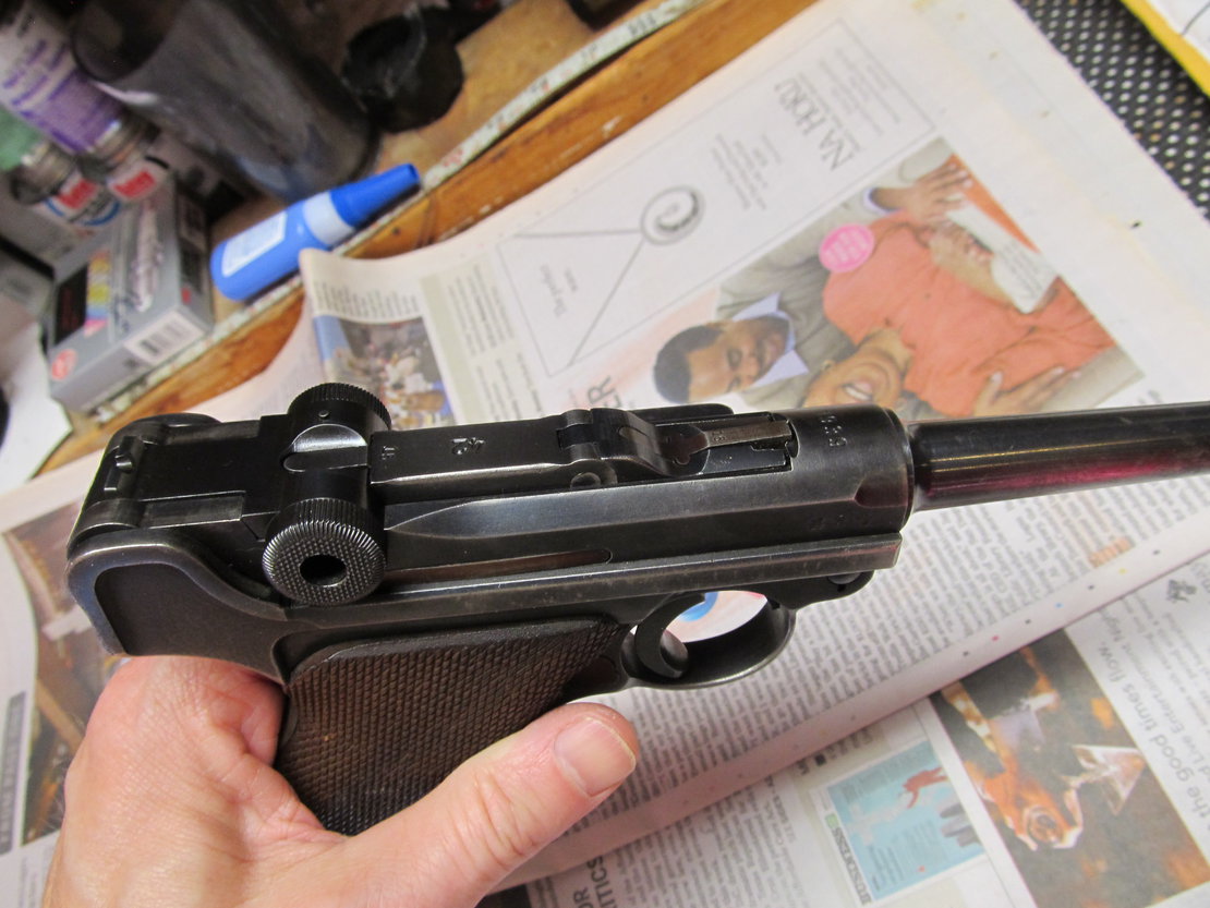

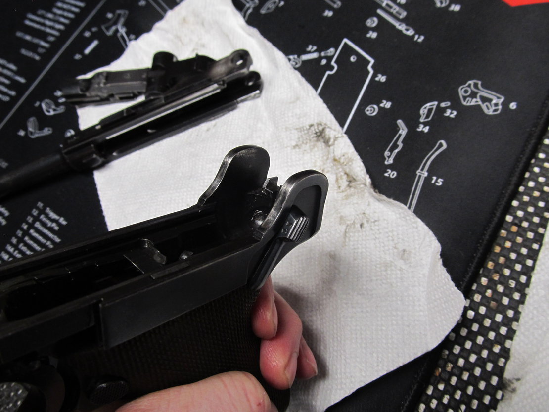

Thanks guys!

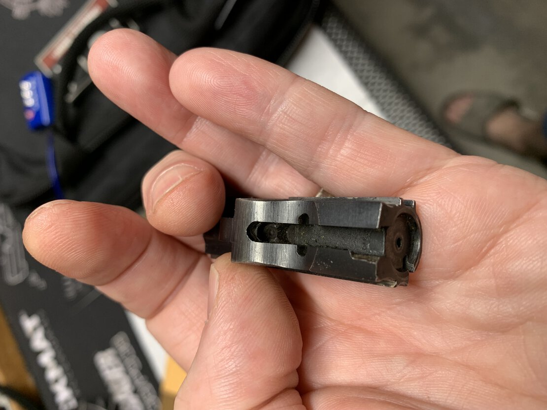

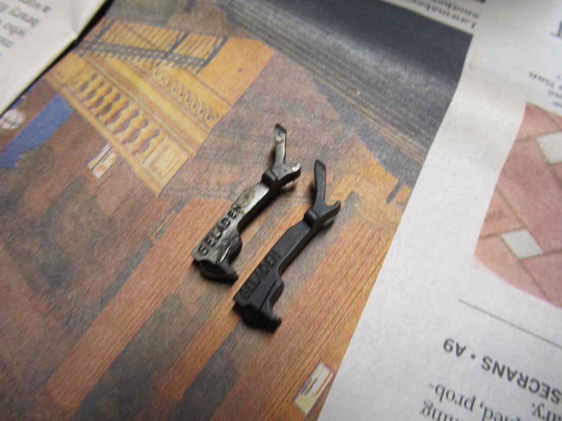

The strawed ejector was noticeably misaligned with the slot in the breech block--had to push a little harder to slide the breech block over the ejector. And, it's scuffed up pretty badly (see attached photo).
The replacement ejector seems to be properly aligned with the slot in the breech block. I took the pistol to the range and fired 18 rounds of WWB 115 gr. No issues, the ejector still looks good (see attached photos).
My current theory is the chipped, numbers-matching, breech block was just a hair out of alignment, or loose, causing the plum ejector that came with the gun (which I presume was fit to the gun) to break, then broke the SARCO ejector, and perhaps bent the strawed ejector, such that it wouldn't align with the replacement breech block I installed. Or, maybe just bad luck, as Don suggests.
If I continue to have issues, I'll update this thread. Likewise, I'll try to remember to update this thread if I experience no further ejector issues, after the pistol has more run time.

I bought the "original" ejector here, from Poland:
http://www.stg44.eu/wpis.php?jid=3&katid=7&postid=361
You have to request a part and pay via Paypal. The part fit well, needed only a gentle tap from a rubber hammer to seat the round tab. I needed a machinist buddy's help to get the Interarms strawed and SARCO ejectors to fit.
I also have two plum ejectors I bought from Legacy. I'm saving those for when I'm sure the ejector issue is sorted, as I think plum is period-correct for my 1939 Luger. At least that's what was on the gun when I bought it.

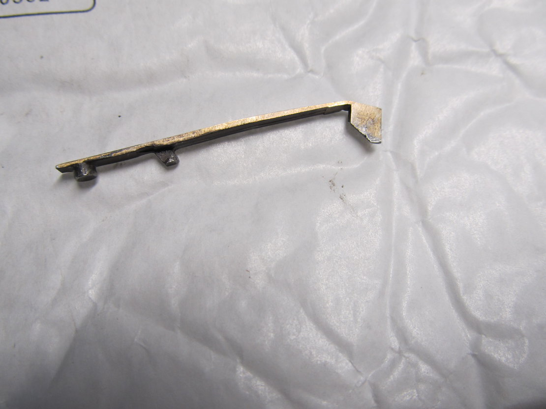

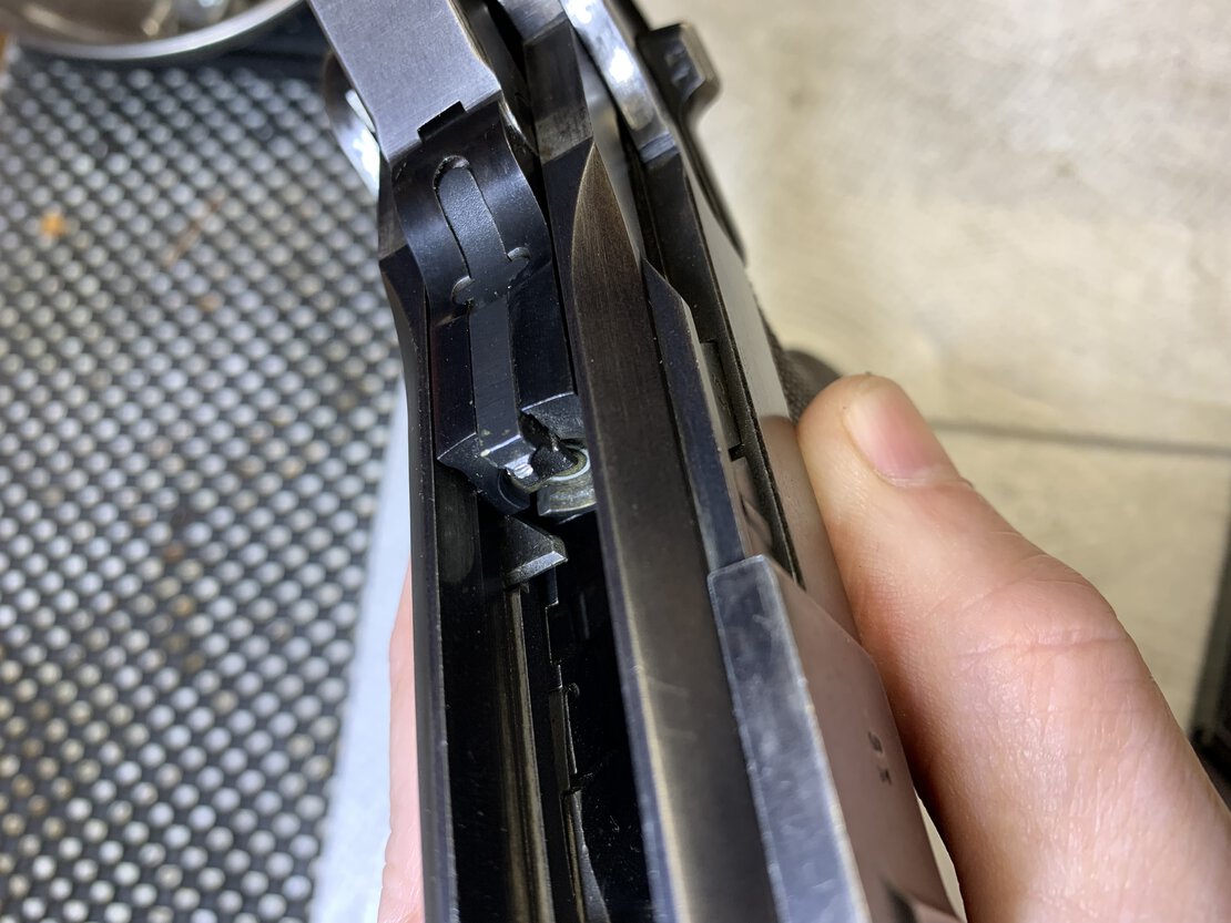

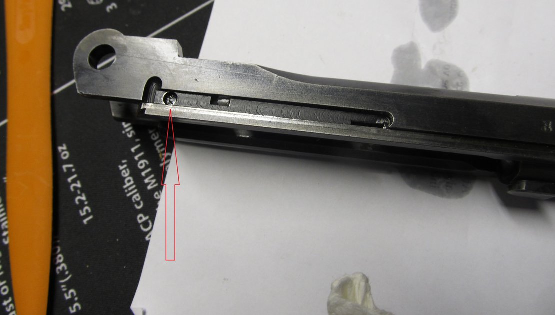

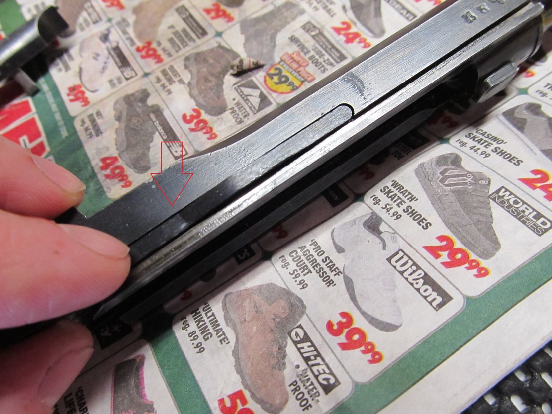

Another thing I noticed is the ejector drags a bit on the frame. Without an ejector installed, the receiver slides effortlessly on the frame. With an ejector installed, some effort is required to slide the receiver along the frame.
Looking at the design, this seems inevitable. As shown on the attached photo, the hole for the round tab is truncated (just barely) by the slot in the receiver that engages with the frame. Also, the bottom of the hole is (barely) visible beneath the installed ejector.
When the receiver is fully inserted, with the toggle engaged, I cannot discern the drag between the ejector and frame.
Is the ejector rubbing on the frame normal?

Unread 01-01-2020, 09:59 AM   #14
No.
The ejector can be "fit" using a file; or a different one selected.
Some are too "high" and can rub on the inside of the "ear", leaving a rub mark that can be seen on the outside of the ejector.
A little contact makes no difference. Some ejector are so far out of tolerance in thickness or in the shape/size/ location of the projections that they will not snap into their recess.

As it turns out, I had a hard time just getting the receiver on the frame with the first "Polish" ejector I installed. You can see in the attached photo how much the ejector protrudes into the slot. As you suggest, needs to be filed down. I replaced it with the second ejector, which fits better, as shown in the photo in my previous post (1139txt). Still some drag, though.
Both of the Polish ejectors are sitting pretty flat, so rubbing inside the ear is not an issue.
Perhaps my problem is ejectors that are being forced to snap into their recess. I can't speak for the ejector that came with the pistol, but--as I wrote earlier--I needed help from a machinist buddy to fit the SARCO and InterArms ejectors, which included some filing of the tabs. The Polish ejectors did not require any filing to snap into their recess.
Oh, and I tried to install the plum ejectors I bought from Legacy. Same deal--no matter how hard I tried, I could not get the ejector's round tab to seat. In fact, I looked closer last night: upset/shiny metal is visible (see attached photo).

Yes,
the round tab is in the "wrong" spot; judicious filing will make it fit.
Keep the edge perpendicular to the outside, and go slow, use a file with a safe edge so you don't score the body of the ejector- or it will create a likely spot for failure.
You may have to work down the forward, inside angled, edge of the angled tab to let the ejector go slightly forward, it may not have enough clearance to fully enter its recess.

An update, as promised way back in December of 2019!
Just returned from the range, now up to 72 rounds on the current ejector. Looks the same as when first installed (see attached images).
Shortly before installing the ejector, I replaced the original breech block, which has a chip in the extractor area (see attached image). I can't think of a common cause for chipping a breech block and breaking ejectors (any theories?), but my best guess is the chipped breech block was causing the ejectors to break.
Incidentally, the 72 rounds has not included malfunctions of any kind. The pistol is running well. Moving past the paranoia of another ejector breaking, I need to shoot it more!
