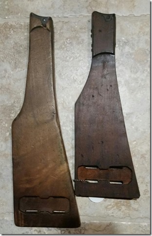

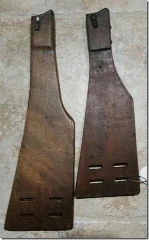

I have a Luger shoulder stock that is shorter than normal. It is 11 5/8” over all length. The short stock appears to be a very tight dense grain heart walnut. It would fit a 4 inch holster just fine If it had the two loops on the back as artillery holster do. The iron is correct in every way but no number. It is not marked anywhere. I’d like to know anything about it. Could it be for a Finnish M/23, or other country to use with a 4” holster? Any ideas?

IMO, you have a hand made copy of a board stock, perhaps intended to be in the Navy length.
The cuts at the neck of the stock are not "normal" for sure; and the inletting for the strap slots are
also different.

The Navy stock I have is much different and 12 ½" OAL.
I've been at this for 60 years and I recall a article somewhere lost in time referencing a stock and holster made for the 4 inch Luger. It could be home made, and well done. That is possible, but a lot of trouble to go through.
