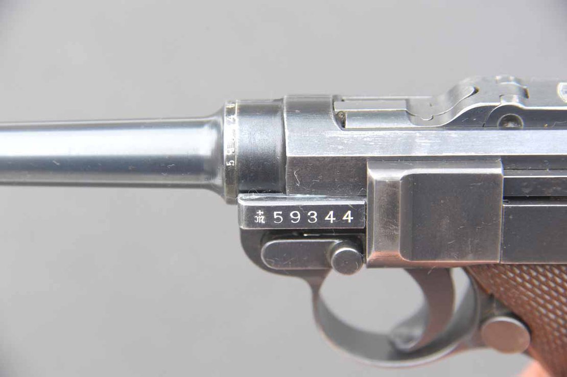

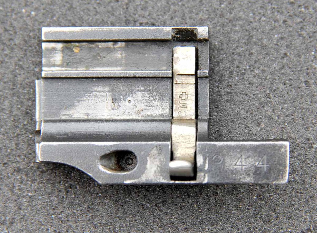

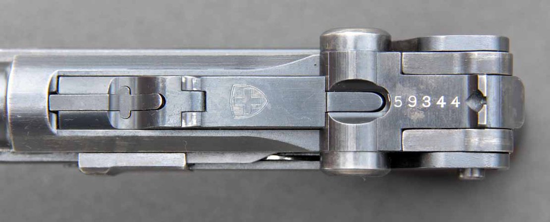

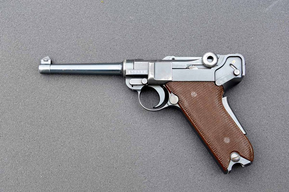

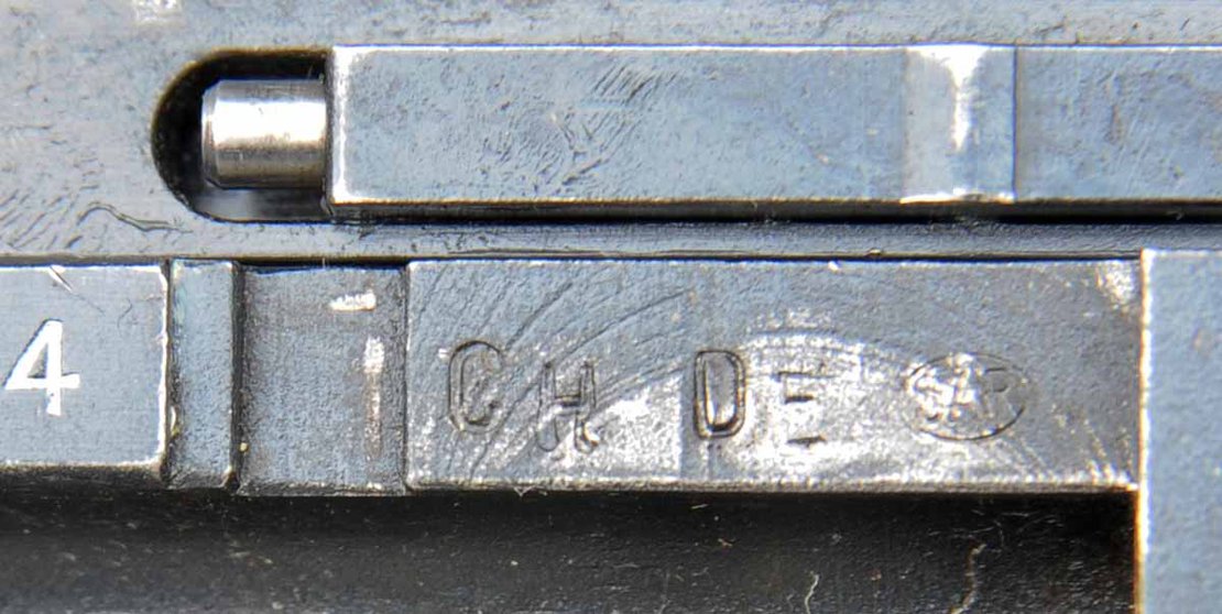

Hi All,
Then promised photos below- thanks rhuff for your comments on the FMJ versus soft point...
What difficulties did you have with the soft point?
We have a good LGS here which specializes in reloading- I'm sure I can get details from them. I'll bring all this info to them to be as close to it as possible with the powder, heads and primers available here.
Thanks!
