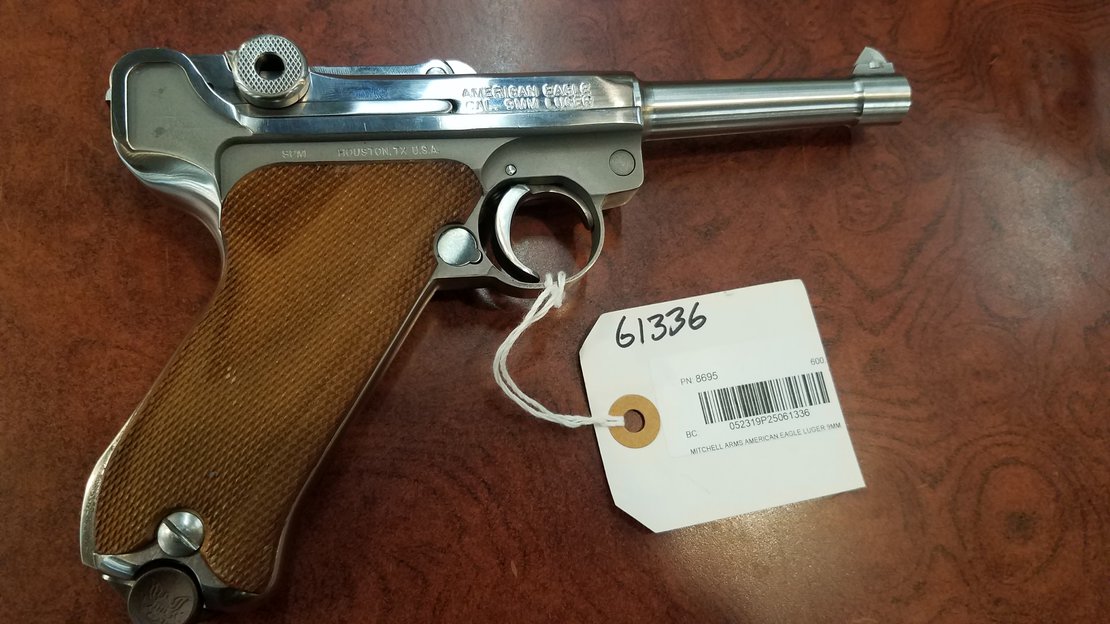

Hello,
I have purchased this stainless Luger from my local gun store. I do not see any manufacturer mark on it. It does not say Stoeger, Mitchell, or Aimco. Does that mean it is an Aimco? The only markings i can see are the words American Eagle, the spm on the frame and the serial number. I realize they are all made in the same place. My questions are: is this considered Aimco (rather than Mitchell's or stoeger) what year was it made? (1993?) Is it better worse or the same quality as any of the others? Is it more or less valuable than one marked Mitchell or stoeger? I'd love to hear from someone that has one exactly like it.

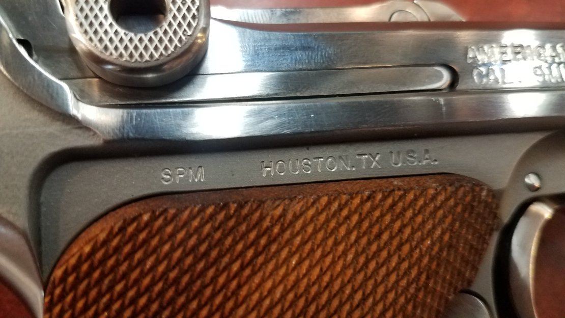

They're all from the same Houston shop. Different runs were made for different distributors, who evidently contributed to the specs for the guns each one bought. I say this because there is variation in the fit and finish among those brands. Unless I'm mistaken, SPM is likely the name of the shop that made them, and all the rest are brands (I perceive Aimco to be the "house brand."). Serial numbers seem to appear in different sequences, and are probably specific to whoever ordered/branded them.

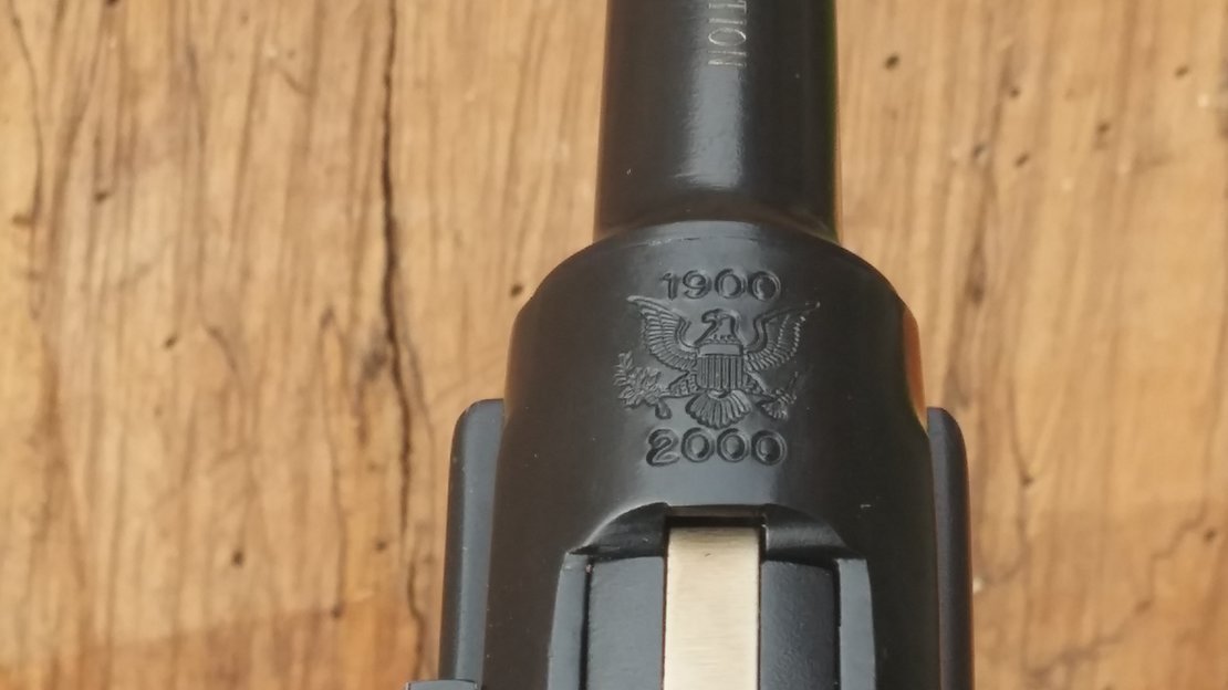

I still have the other, a "1900/2000" which was Cerakoted black over the stainless at the factory. It has dished toggle knobs (no toggle lock), pencil-taper barrel, and is chambered in .30 Luger. serial number "AE 040 of 350)." I figure this 100-year commemorative series was probably the last of them ever made.

So here's what I got. The owners manual says Aimco. The frame only says SPM which my reading tells me is the company that made the frame. There is no other manufacturer markings at all. Not above either grip. Not anywhere. The magazine leader saysMitchell. The 1993 seems odd to me as this would be during the Mitchell time frame but the gun is not marked Mitchell at all. What say you? Did Aimco brand them simultaneously with Mitchell? Is it a Mitchell with no stamp? Certainly someone must know or have one like it. thanks for all the info

Aimco was branding with 3 or 4 names all at the same time.
The 1993 is not odd.

The manufacturer was Aimco. Later changed their name to Orimar Manufacturing Co. Or OMC.
Mitchell and Stoeger did not manufacture anything, just had their names put on the things.
I believe the manufacturer was mainly into dentistry tools and made the lugers as a side project.

By comparison, the one sold to Ithacaartist by me had OFM Corp as the manufacturer on the frame where yours says SPM. Mine had no “Houston, TX USA on the frame.
