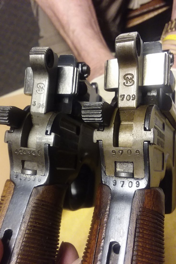

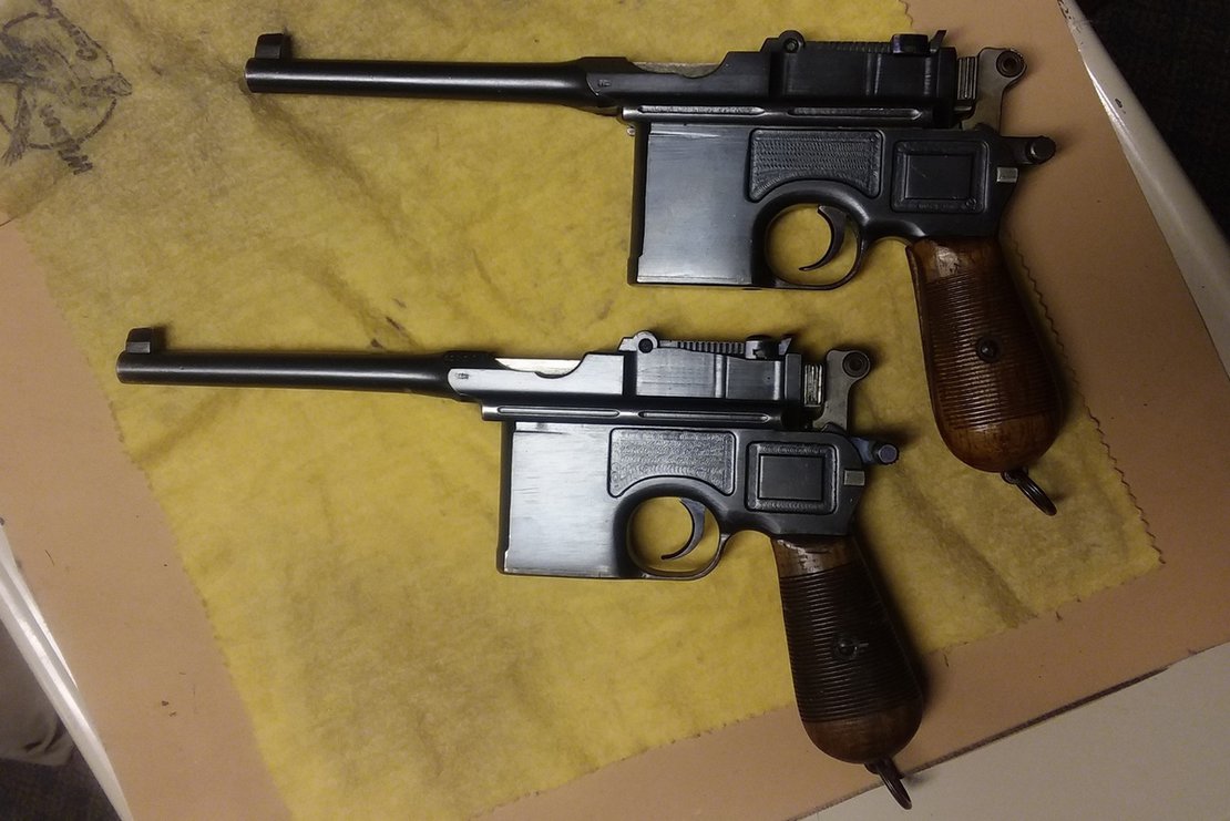

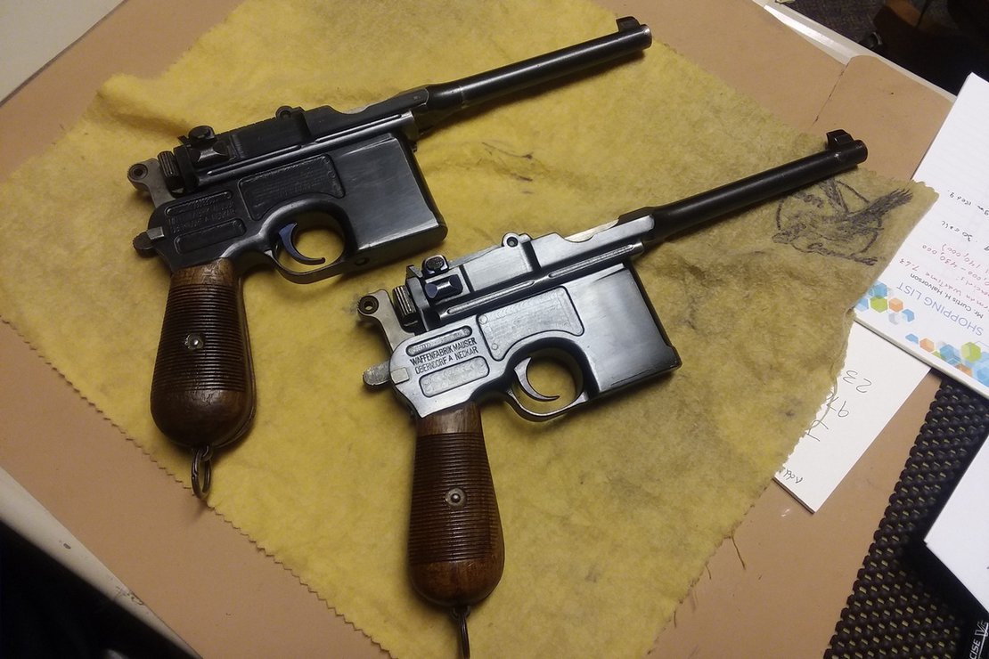

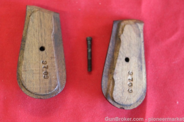

I just took delivery of a .30 Mauser broomhandle just like any common "WW1 commercial" except it is s.n. 9709, which would seem to place it in the s.n. range of the "Red 9" pistol contract. I've seen that some Red 9's were relined and reworked as .30s-but there is no evidence of relining, also the pistol has the correct 2-curve .30 cal sight ramp, etc. I took the pistol to a fellow collector and Korean war veteran, he has a lot of broomhandles and took out 419386-we set it besides 9709 and both said "they're twins!" Could a 9mm have been reworked so completely and still look exactly like it's unaltered .30 cal twin? Do any fellow collectors know of other seemingly legitimate .30s in the 9mm s.n. range? Thank you all, best wishes, Joe

Mauser was very sloppy when it came to serial numbering. Many smaller contracts had their own ranges. So basically anything can be expected.
They did not care and did not register C96 numbers, only contract volumes.

Thank you Vlim!
I'm glad you are not saying "fake" or "rework", the pistol looks so authentic I could not imagine it was a rework/conversion of a used Red 9.
May I please ask two follow up questions?
First, if I understand you, number 9709 could have been from the "Red 9" serial number range or some other, perhaps unknown contract during the period of "WW1 Commercial" production?
Second, from your reply I imply the serial number oddity is not especially rare or valuable, not that I care, I plan to keep the pistol, but is that your view-no big deal?
Thank you again! Joe
