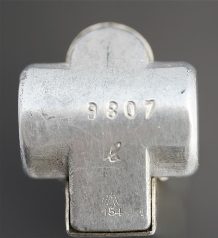

What is the correct magazine type for a 'G' date S/42 pistol? I've been unable to find any source which would answer the question, thusfar. The pistol came with a badly battered nickel plated magazine with an aluminum base, which I don't believe is right. I'd like to have at least one proper magazine for the pistol (and already might, actually), but I need to know what to look for. The pistol itself is in pretty nice shape and matching - except for the magazine...

Rolled sheet metal held together with a crimp, slant cut aluminum base secured at the base with a pin through base and tube. Tube is nickel plated. (credit to Jan C. Still's "Third Reich Lugers" page 125.) And of course serial # and suffix, and acceptance mark.

A mid-b block gun would probably have an Droop Eagle 154 magazine, with full serial number and suffix , and with, or without, a plus sign.
The magazine you have is a later armorer's replacement as indicated by the 42.

The magazine would be nickel plated. S/42 and 42 are Mauser codes. The base would have the serial, suffix, and inspection stamp' and a + on the spare. The code S/42 appears on the toggle train only. 42 was an armorers replacement code. Cheers!

Here is what a correct G date magazine with a "b" suffix looks like. This magazine has a shiny plated body.
S/42, 42, and byf are codes for Mauser but these codes were not stamped on the matching magazine bottoms that came with the gun.
The exceptions are that S/42 and 42 were stamped on replacement magazine bottoms.
If you could post a photo of your magazine it would help.
