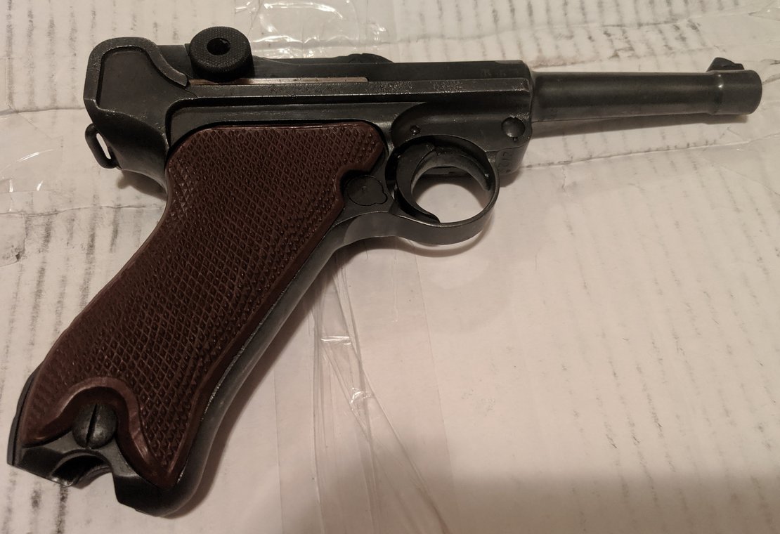

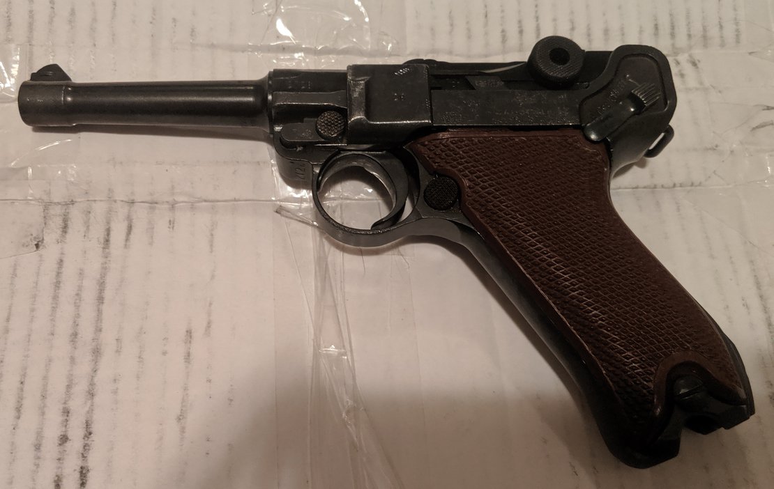

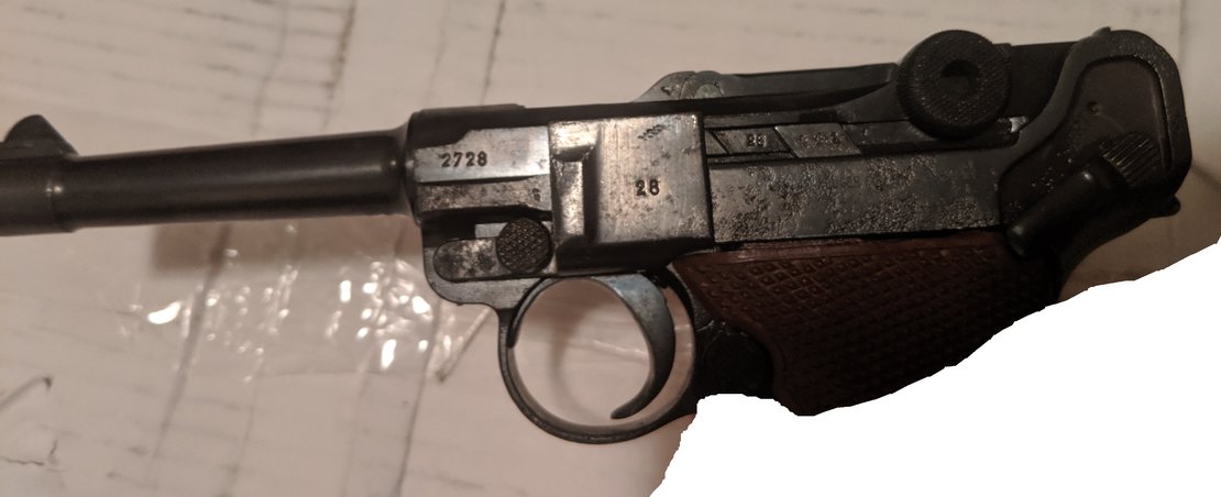

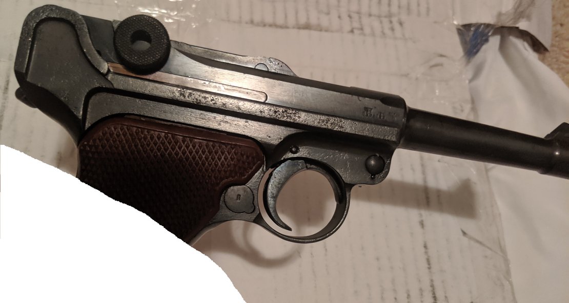

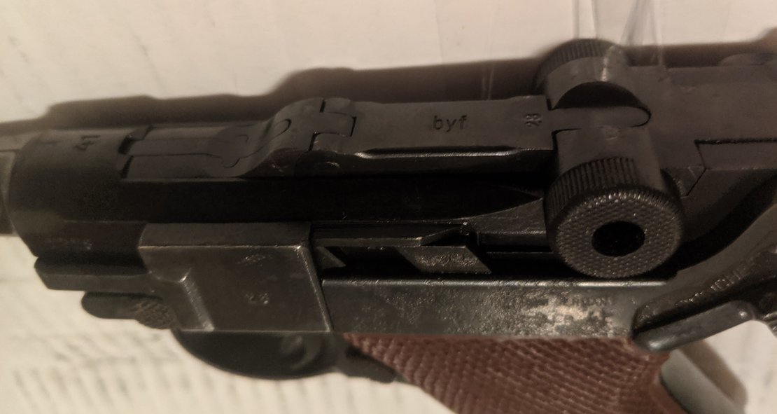

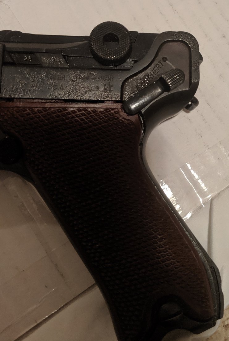

Here's pictures of it, the frame is somehow significantly worse than the receiver. That price range isn't bad for a frame. If this one is already a little bit of a Frankenstein itself, I figure why not make it look better and have a few different barrel types for it.

Unread 05-28-2019, 09:05 AM   #8
That's the kind of corrosion typical of storing a Luger in a holster in a humid environment.
Do you draw back the toggles / receiver slightly before trying to disengage the take down bolt's lever? The receiver/cannon has to be pulled back first.
Try and determine where the take down lever / side plate has excessive friction. There is also a small retention spring just below the takedown bolt that might be incorrectly installed (it has a small curve milled out of it to allow the takedown lever to function).

It looks like there is a two-line import stamp on the side of the frame, and the pitting is on top of that. I think it is a Century Arms stamp, looks like LUGER PARABELLUM GERMANY / CAI ST. ALB VT.
Also, I don't see the Mauser hump. I do see what looks like a proof mark on the front of the trigger guard, suggesting it may be a pre-WWII Erfurt frame.
KFS

The top line reads Luger P#####M (Parabellum?) Germany.
Bottom line is C.A. ##%#%# L(?) B(?) V.T. The periods on the bottom may also just be from the pitting.
-QM
Unread 05-28-2019, 10:23 AM   #11
That is not a Mauser frame, but as Karl hints- it is an Erfurt frame.
The import marking is the typical Century Arms International of St. Albans, VT.

So if I am to understand correctly, this is a Mauser receiver with an Erfurt frame? Does that increase my chances of finding a frame in better condition? Does this also mean that Erfurt frames and Mauser Receivers are compatible?

In general lugers are remarkably interchangeable but they also were also built to close tolerances and required hand fitting to function well. Your mismatched gun is apparently one that was reworked by a Russian or East German armorer and may function well despite the mixed parts.
In my opinion, if it works well enjoy it as is. It is a shooter: replacing the frame will not make it into a collector grade Luger and it just might cause problems with proper functioning.
I suggest that you shoot and learn from this Luger and save the money you might spend on a replacement frame as a down payment on your next Luger.
