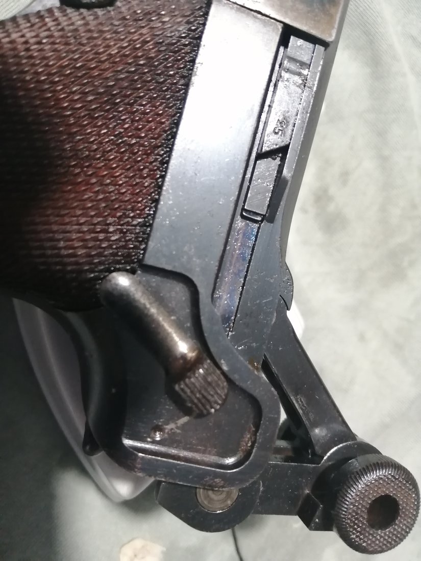

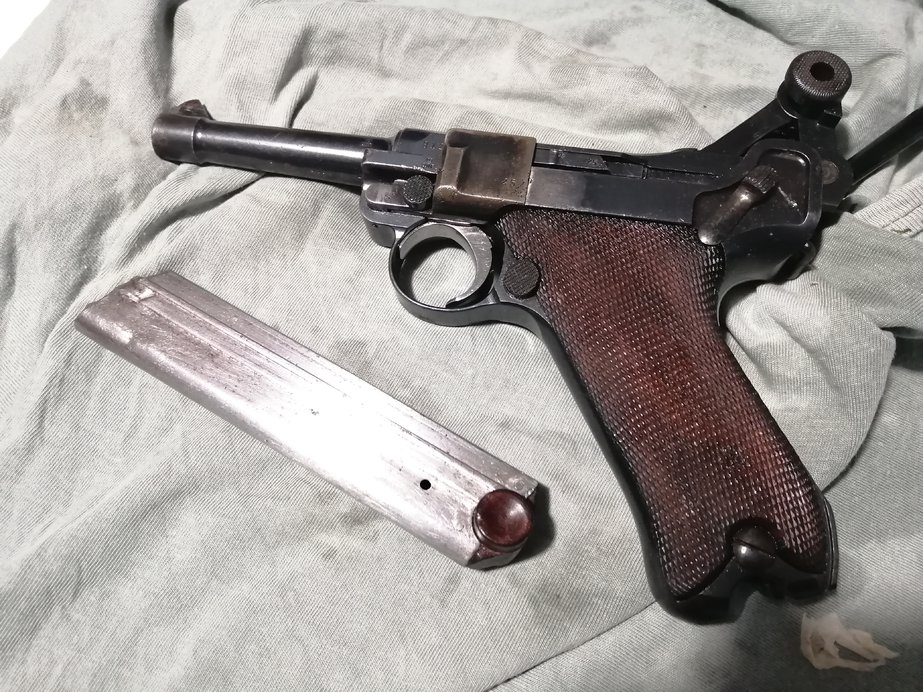

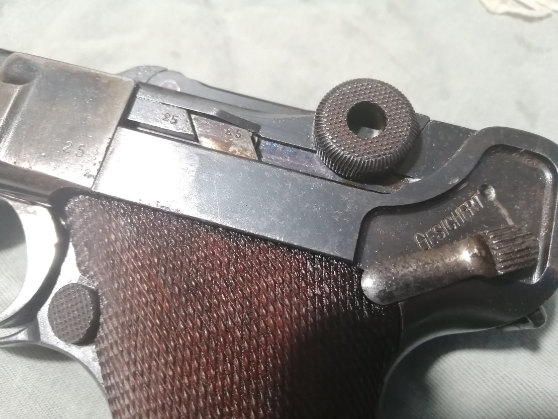

Default DWM 1914 from Italy. another fake?

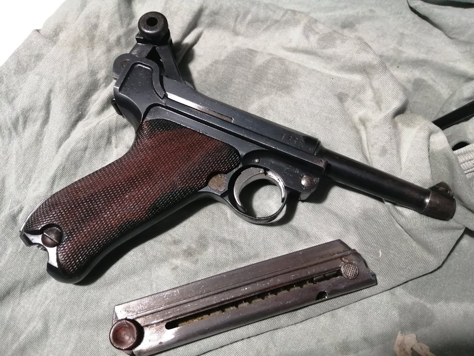

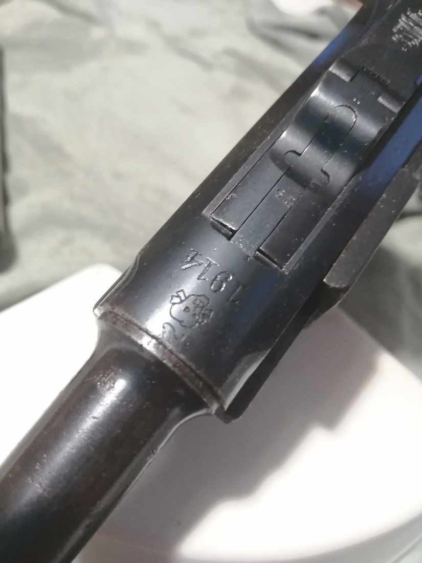

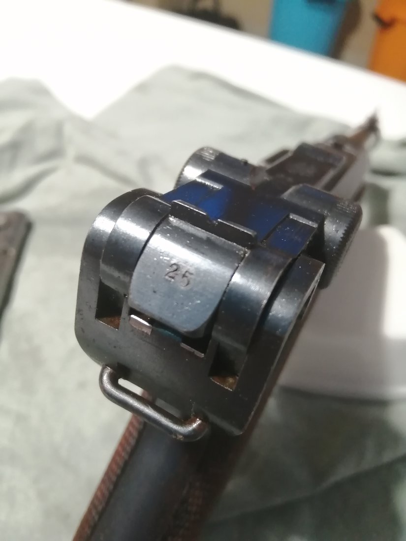

I'm new to the forum and I'm writing from Italy: I apologize for my poor English.
How did I get here? let's start from the beginning: I always dreamed of touching a Luger and recently I bought P08 1914 DWM from an old collector, not passed off as a rare piece or captured by an officer, so much so that I was sold together with other pieces (including a bomische cz27) at a price that I consider paltry.
I tried to document myself asking for opinions on social media, probably the fastest way, but as often happens, conflicting opinions have emerged about the originality of this 1914. Mind you, criticism is welcome, but an explanation to a neophyte whom I am, would also welcome.
The general condition as you will see in the picture, worn, bruised, scratched, rusty, and I like it, lived, like presenting a gun that has served in 2 wars.
In any case, I would be grateful to all of you if you could express your opinions and give me clarifications regarding the authenticity of the components and perhaps history.

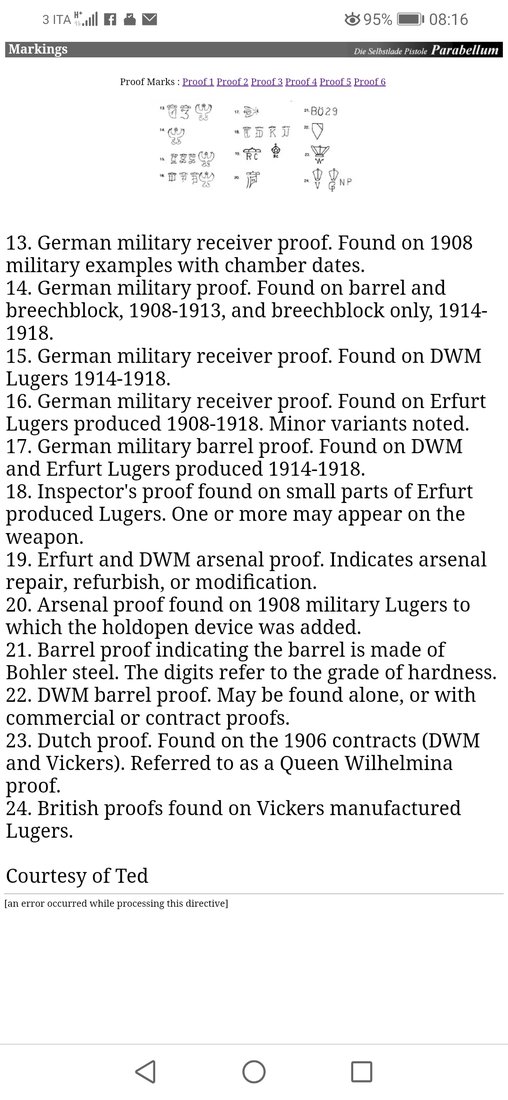

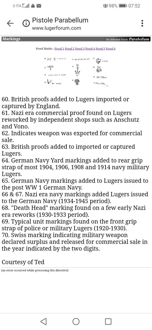

I searched on the precious indications present in the forum database and I noticed that the pantograph-engraved totenkopf is present in the archive reported as reworking on imperial lugers in the Nazi era but I did not find photos to make comparisons.

I also report the references of the various marking in the forum

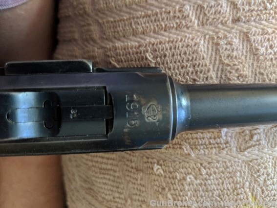

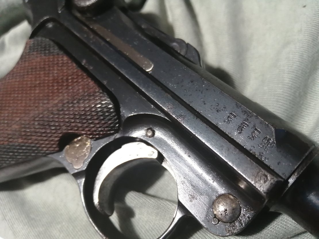

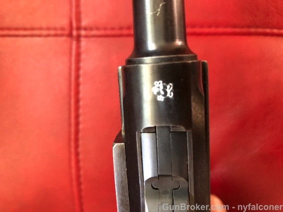

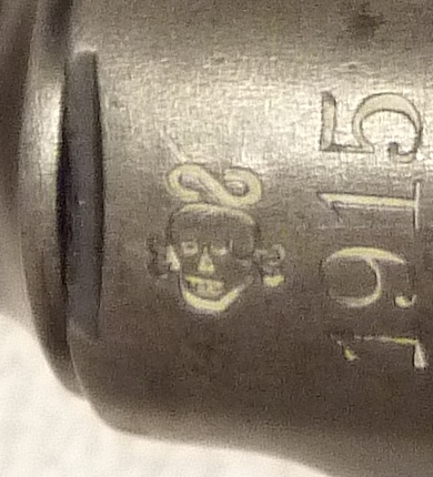

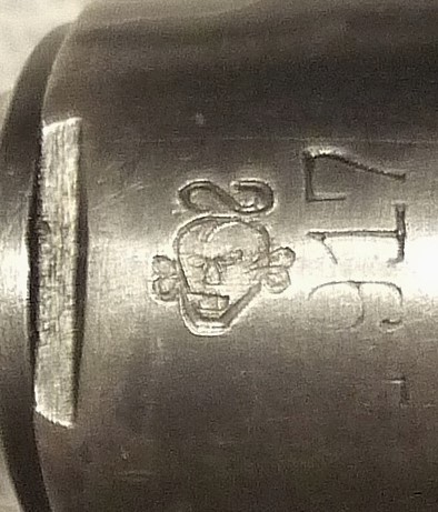

I believe it is a genuine 1914 military luger, it obviously spent some time in the UK and gained commercial proofing there.
I also believe the Totenkopf to be a later and spurious addition. The Death Head marking opens an entire new or really old discussion as to whether the DH marking is original or fake. There are a number of threads with pictures on this forum discussing the DH lugers.
I found one for you:
http://forum.lugerforum.com/showthread.php?t=39442
This particular DH is orientated in a different direction than (all) others observed or pictured, and is obviously a pantograph addition, and somewhat crude to boot.
It is "safe" to assume that DH markings are fake- as to prove originality would require provenance other than just its presence on the pistol. JMHO
A couple other pictures of DH lugers, note these markings all appear to the stamped, rather than pantographed:

Unread 05-26-2019, 05:11 PM   #6
Hi Dennis,
Welcome to the forum! There are two schools of thought regarding the Death Head markings. One school insists that they are all fake, the other that some few are authentic and the rest fake. For some reason all the folks that own one of these guns firmly believe that their's is one of the genuine ones. As a non-partial observer I have to agree with Don, yours looks fake.
Regards, Norm

the 1915 Death Head in my post does belong to me, and I still think it and most(if not all) DH lugers in circulation are fake!
It is surely odd that no DH lugers have surfaced in Europe, all have been found in the US(at least that is the "report").
I strongly suspect they were made by the luger Mafia, though I have heard the story that some dozen or two were created in Germany for export to the gullible US collectors.
Unread 05-26-2019, 07:19 PM   #8
k98mike
Join Date: Mar 2018
Location: Newnan, GA
Posts: 141
Thanks: 280
Thanked 48 Times in 30 Posts
Default Luger mafia?
Luger mafia?????????????
k98mike is offline   Reply With Quote
The following member says Thank You to k98mike for your post:
Unread 05-26-2019, 07:44 PM   #9
Norm and others,
The O.P., and the gun, are in Italy.
The following 2 members says Thank You to Norme for your post:
Unread 05-26-2019, 08:30 PM   #10
Thanks Norm, but really- I did realize that; maybe I should have said "stamped" DH.
But for sure this pantographed one is in Europe- but looks nothing like the "usual" DH; maybe it is a
"real" original!

a derogatory term for craftsmen faking scarce or even fantasy lugers for profit. "They" appear to have been in existence and operation since the end of WWII!
Since the term"mafia" is not PC, my apologies in advance to anyone offended.

At least the 95% of the Lugers in the hands of collectors in this Country has been imported from Germany, the collectors here are very few, and Luger collectors fewer still; so in my opinion Italy would be of no interest for any faker, especially of Lugers.

I wonder if we need a new more "politically correct" term like "decorated Lugers"?
After all, the Luger itself is a real pistol, generally coming from one or more of the Luger factories.
All these supposed value "enhancer" markings are intended to deceive collectors and buyers. Some are, I supposed, intended to celebrate things that are now discredited. And many of these markings are actually prohibited by law in Germany itself.
Since collectors look for Lugers that are as close as possible to the original state when the pistols left the factory, collectors are generally not interested in "decorated Lugers" unless we want one for some reason other than it's supposed rarity. After all, with these, there is generally just one - making it extremely rare.

Unread 05-28-2019, 04:46 PM   #18
Hi Dennis,
The finish appears to be original, the barrel serial numbers exhibit the halo effect, a pretty good indicator of original finish.
Regards, Norm
Unread 05-28-2019, 04:51 PM   #19
If the pits in the surface are BLUE, then the gun has been refinished... If the pits are IN the blue, then the finish is likely original... Sorry I can't tell by the photos...
Unread 05-29-2019, 01:42 PM   #20
What John has said reflects my exact point of view.
Photographs are not always a good indicator of what the actual finish looks like, I' afraid there is some cause for doubt as to the originality of that pistol.
As far as the death head mark is concerned, so far all the so called "Totenkopf" Lugers that I've seen looked as if somebody had tried to "improve" them ... and even more I would think about this one with a pantographed D.H.
