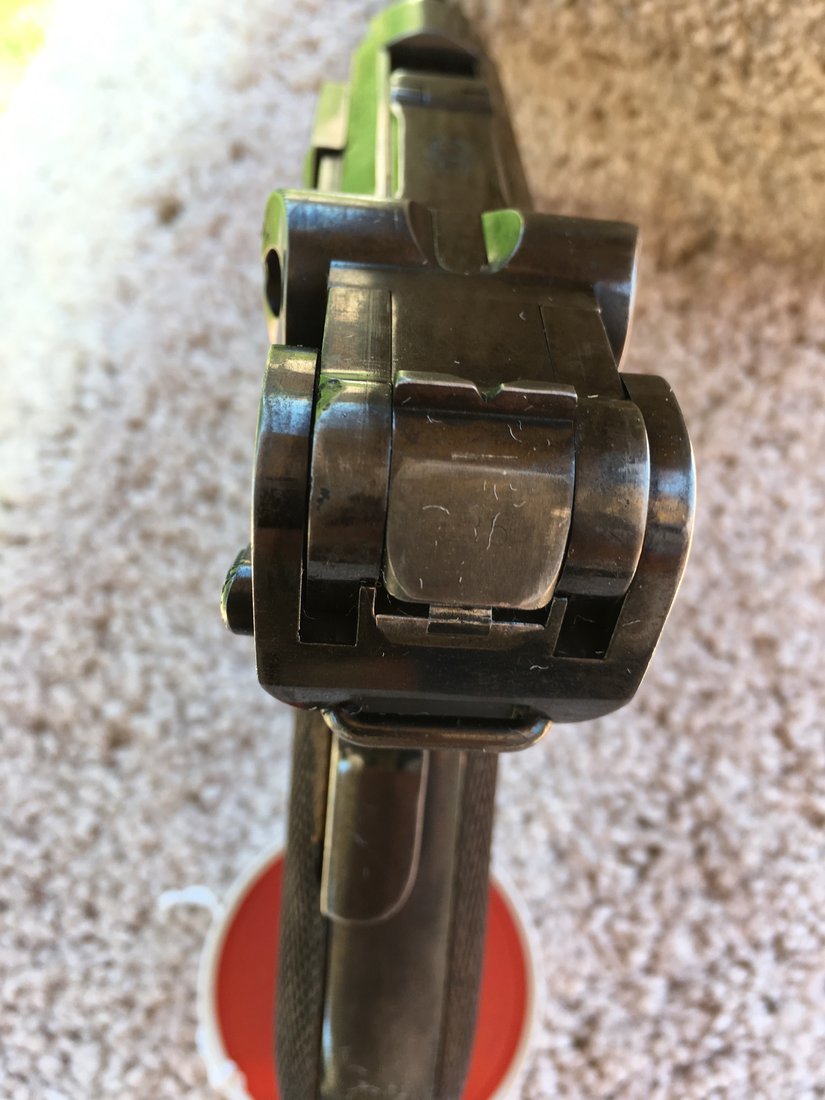

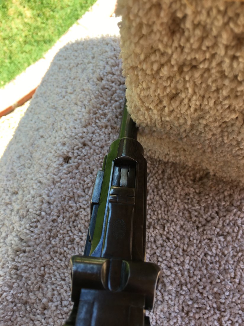

Default picture test early luger
See if this worked?

Glad it did! That is an odd piece...need more photos!
Unread 05-14-2019, 09:23 AM   #4
Try taking your photos without flash and in soft indirect shaded sunlight. They will look better.
Use a camera with adjustable focus and a tripod You'll need to get closer to show details.

Tried to magnify your picture. That looks like an interesting piece, I'm sure several of us would love to see better close-ups taken in the shade, natural lighting without flash.

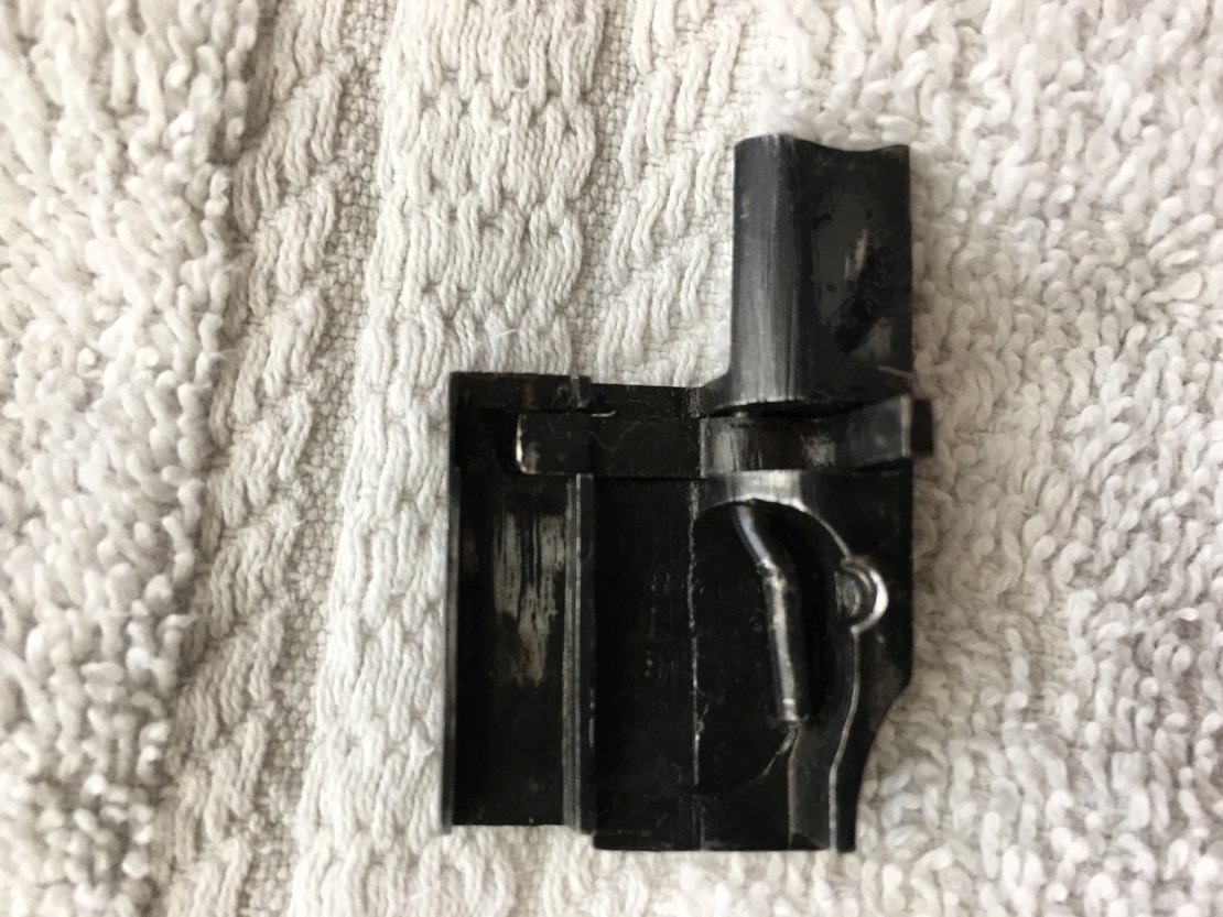

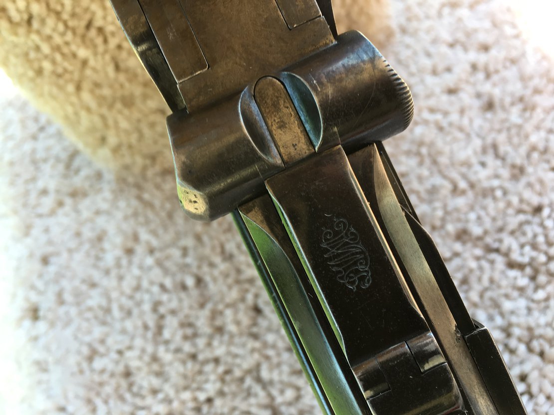

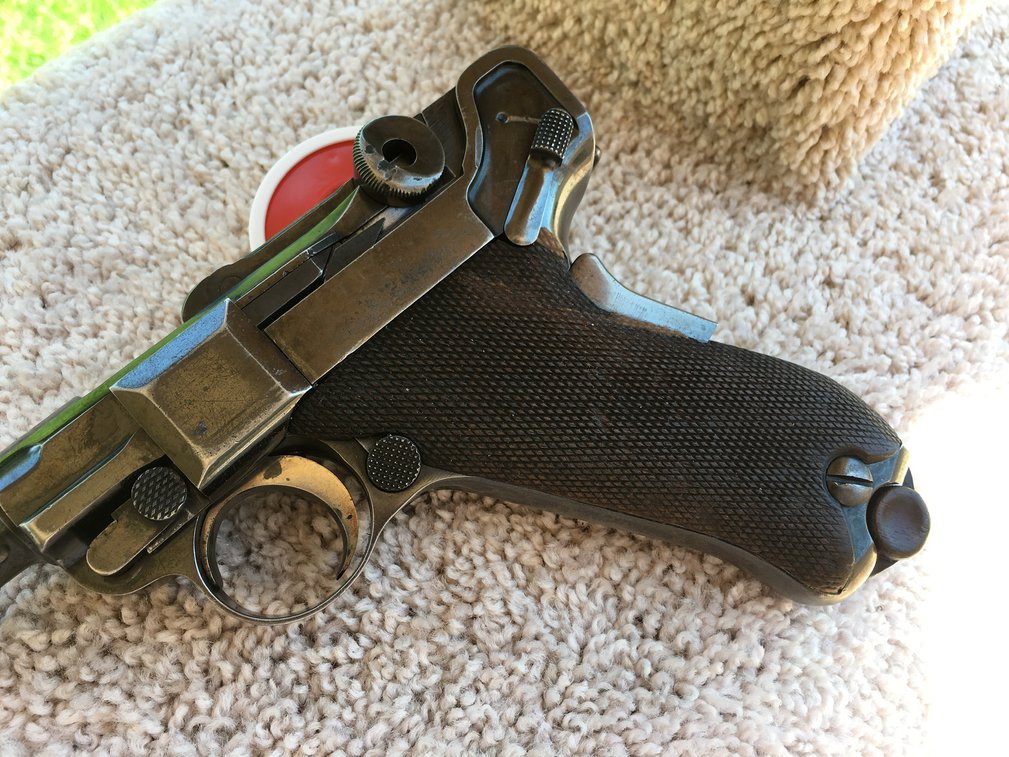

Here are a few pictures ,what throws me is the lack of serial numbers and inspection stamp etc. this Luger simply has the DWM scroll on the toggle and the serial number with GERMANY stamped on the frame beneath the barrel.
Maybe disassembled i might find a couple but most pictures I’ve seen seem to show a profusion of stamps lol.
Understand after going through the forum that this should be a very early model with the grip safety and the dished toggle knobs.
Other than that I’m in the dark.

Side plate may have an "8", but it is not original DWM manufacture.
By serial 8008, production was well established.
Your example has been significantly buffed and refinished, probably removed a few numbers.
The original side plate would have had a number along the bottom edge.
The take down lever should have a number on the bottom also.
The mid toggle link may have a number on the bottom inside, the breech block should also have a number; the number on the rear of the toggle may have been polished away- but I think I can still see residual numbers there.

And those residual numbers do not match. Looks like an 8 or a 3 followed by a 5.

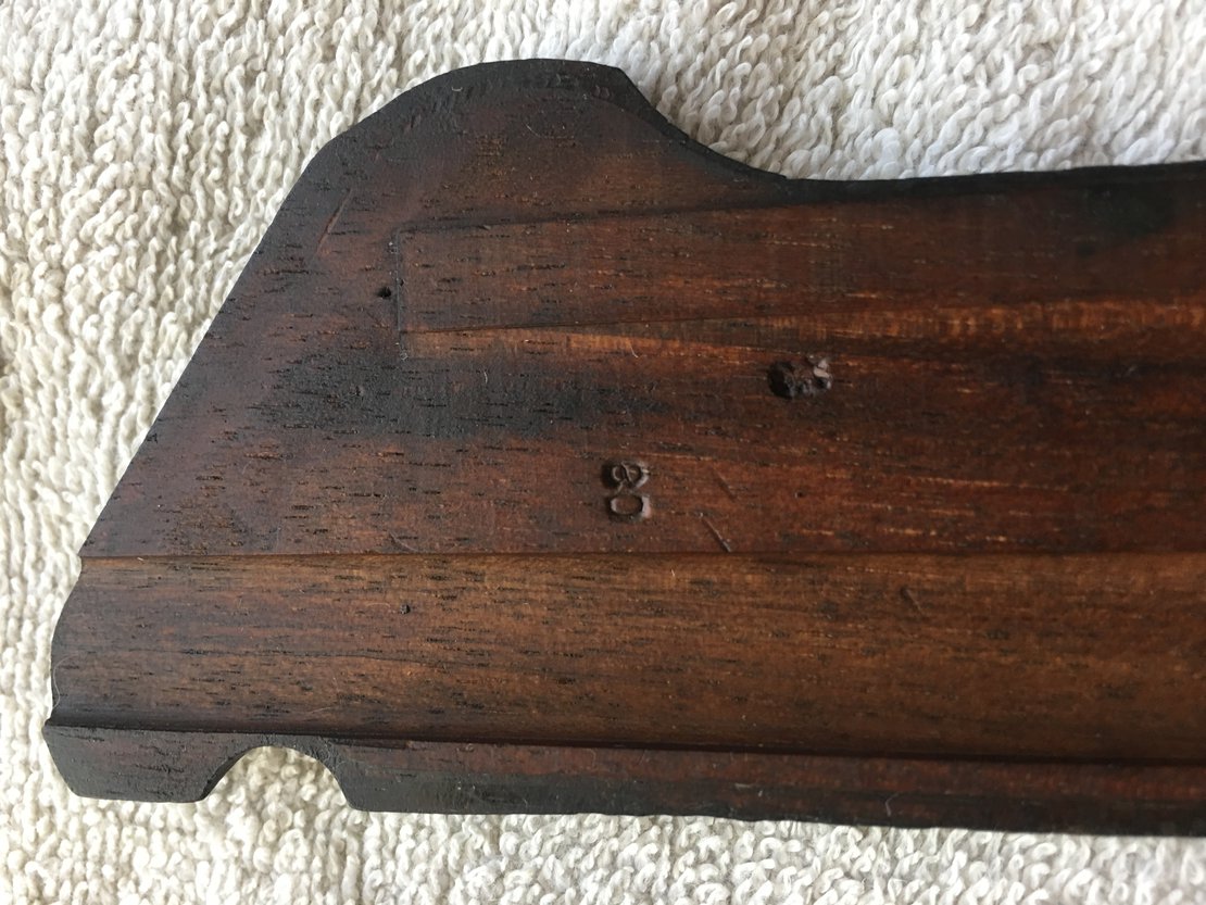

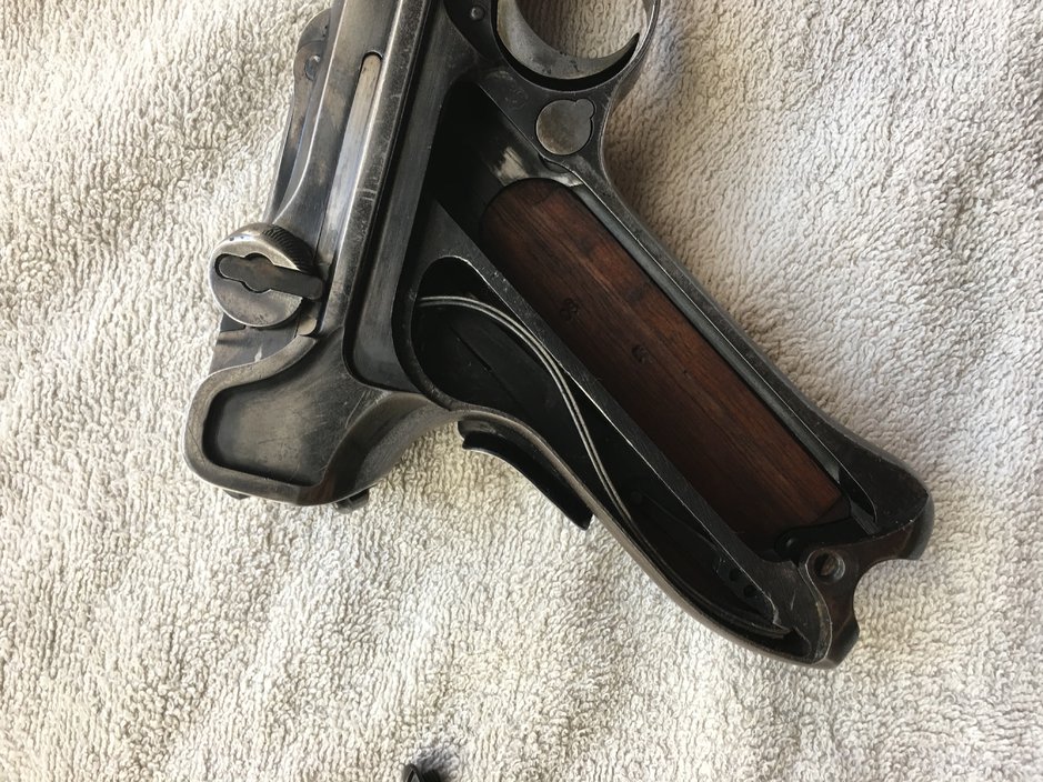

Seeing as this seems to be a non- matching numbers gun I’m thinking of replacing the side plate with a authentic DWM plate that would at least give it a correct look.
Just out of curiosity what would a ballpark value on this Luger be?
I did field strip it and found a number 76 on the bottom of the barrel extension. Also the recoil spring is the early type not the coil spring.
Oh,and the grips were correctly numbered 08.
