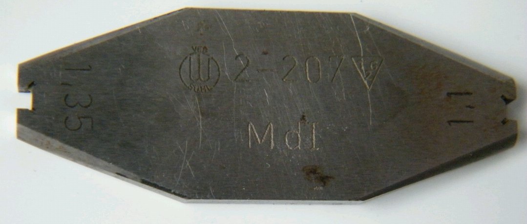

GDR 'comrades' said between 1.1 and 1.35mm.
