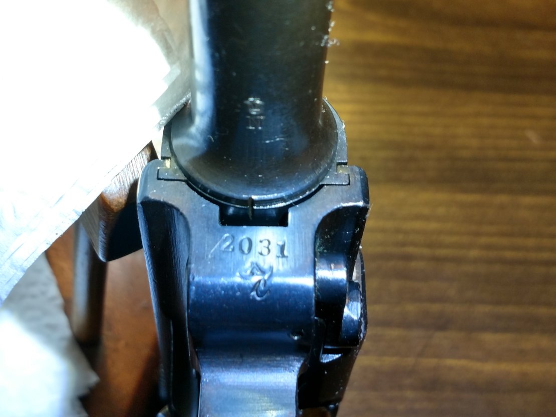

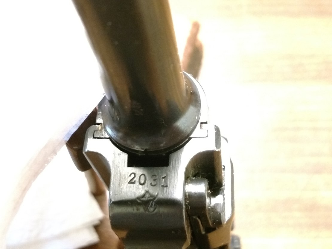

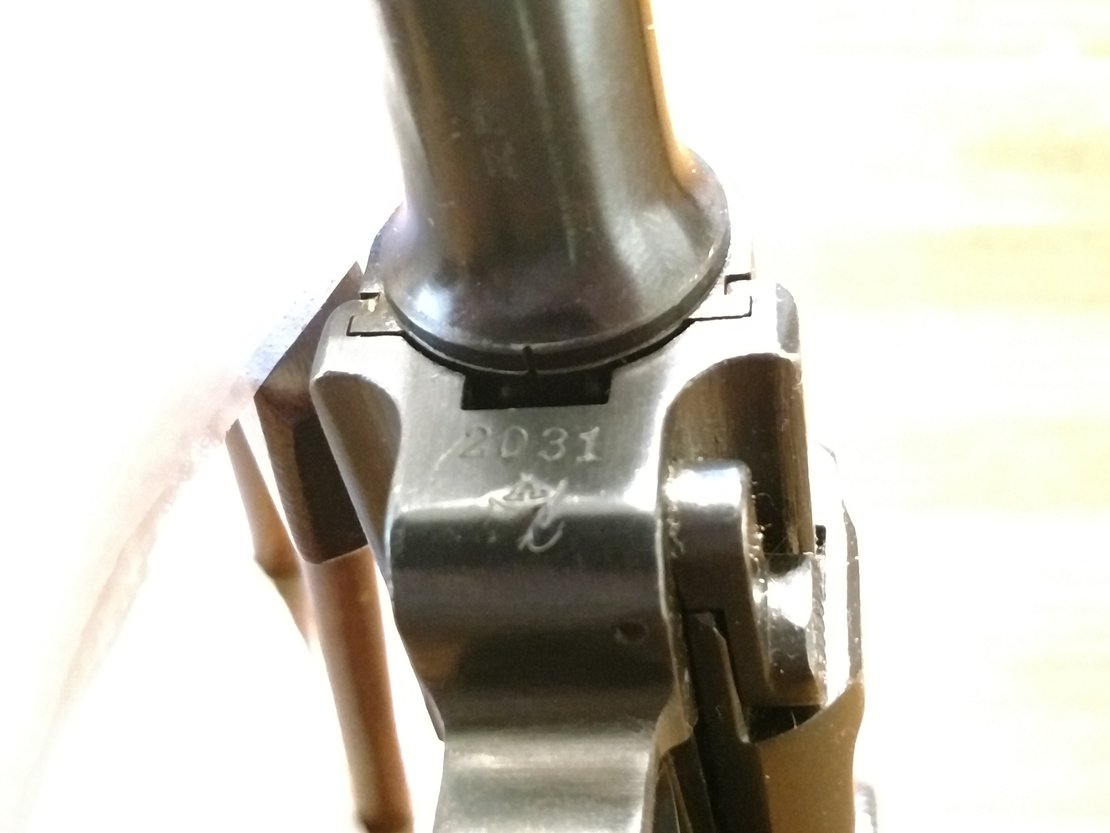

Serial number on the front of the frame (below the barrel) is 2031; there appears to be a "k" in script below that, although that looks like it has been partially stamped out by an "x" in block lettering. Would that serial number block correspond to a 1914 DWM? Serial number on the receiver is just 2031, but the font is noticeably larger, so I suspect it is force-matched. I tried several different shots to get the letter below the SN to come in clearly, but it's difficult to photograph as it's on a curved portion of the frame.

Yes, the receiver has been re-numbered to match the frame, there is no reason to think the frame is from 1914- but it could be.
The suffix letter on the frame looks more like a "c" to me, but really need a couple more pictures.
Try side lighting and try to get rid of the bright spots.
