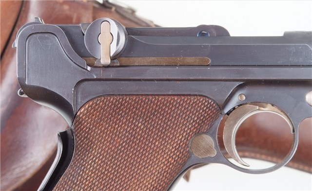

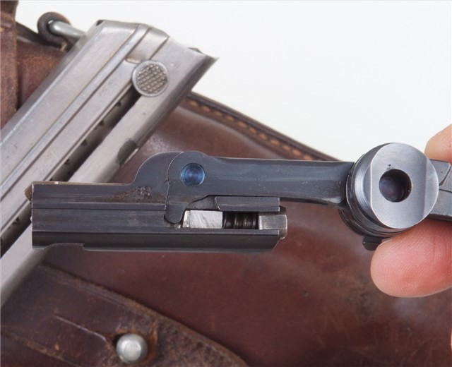

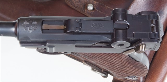

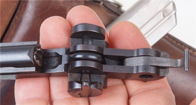

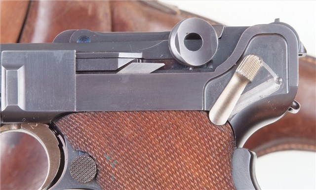

This is a current listing on GB I was looking at. The seller is quite proud of this pistol, going by the description. Link: Luger, 1900 Swiss, Military, Wide Trigger, Holster
I was alarmed to notice the rear toggle link with no knurling. There's no mention of it in the description.
What could it be? Did the Swiss arsenal adapt an 06/29 rear toggle link as a replacement on a 1900? Does anybody have an idea what might cause the failure of a rear toggle link; and thus, its replacement? I would think this is a pretty robust part.
Or if I'm all wet, please tell me so. I am no expert.

I agree with your question. All the original M1900 rear toggle links that I've seen, do have some knurlling on the forward edge on both sides. The only explanation that comes to mind, is that on your M1900 #4082 that the Swiss may have removed the knurlling during a rework. TH
Unread 03-04-2019, 10:53 AM   #3
Not uncommon to see fixed/repaired parts on Swiss lugers. If they needed fixing, they were fixed, that simple.
If original parts were not available, more recent spares were used.
Replaced rear toggles are not uncommon, and because they switched to non-checkered rear toggles in 1929, that is what they used for repairs after that time. Since these look different from the originals, it catches the eye. Other repairs are not that visible.

Both responses agree that the rear toggle link is a replacement, evidently crafted from a later part consistent with the post-1929 toggles used by the Swiss in Lugers they manufactured. That is exactly what I had thought.
My secondary question asked, "Does anybody have an idea what might cause the failure of a rear toggle link; and thus, its replacement? I would think this is a pretty robust part."
I'm still trying to get my head around what could cause a rear toggle link to fail. I am no engineer, nor a gunsmith. I've owned and shot a fair number of Lugers, but I've never seen one that gave indication of trouble in the toggle train. Can anybody add light to this?

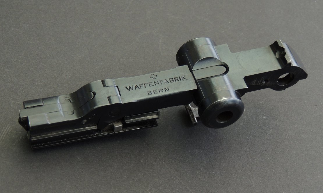

Cracks in the rear toogle were not uncommon among pistols in 1900 and 1900/06. As Vlim has already mentioned, the defective parts were often replaced by rear toogles of pistols 06/29. This was done by the W+F but also by local gunsmith.
This pistol 1900/06 (W+F, SN 18251) was repaired by the W+F in the 1940's . The owner of the gun was the Director of the M+F (ammunition factory in Thun, Switzerland).

Why would it fail?
Possibly:
-imperfections(inclusions) in the steel, not visible from the outside
- stress crack from forging, too small to see until it "grows" with use
- abuse(heavy/hot loads or many thousands of rounds fired".
Most cracks originate from sharp (square) inside corners, where firing stresses can be concentrated.

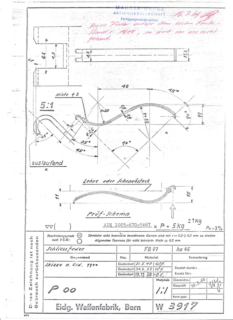

Commemorative Mausers were checkered.
Only a few pre production Mauser Parabellums had smooth toggle knobs. Normal production and commemoratives all had checkered knobs.
Grip safety looks normal to me, but could be a 1906 style replacement.

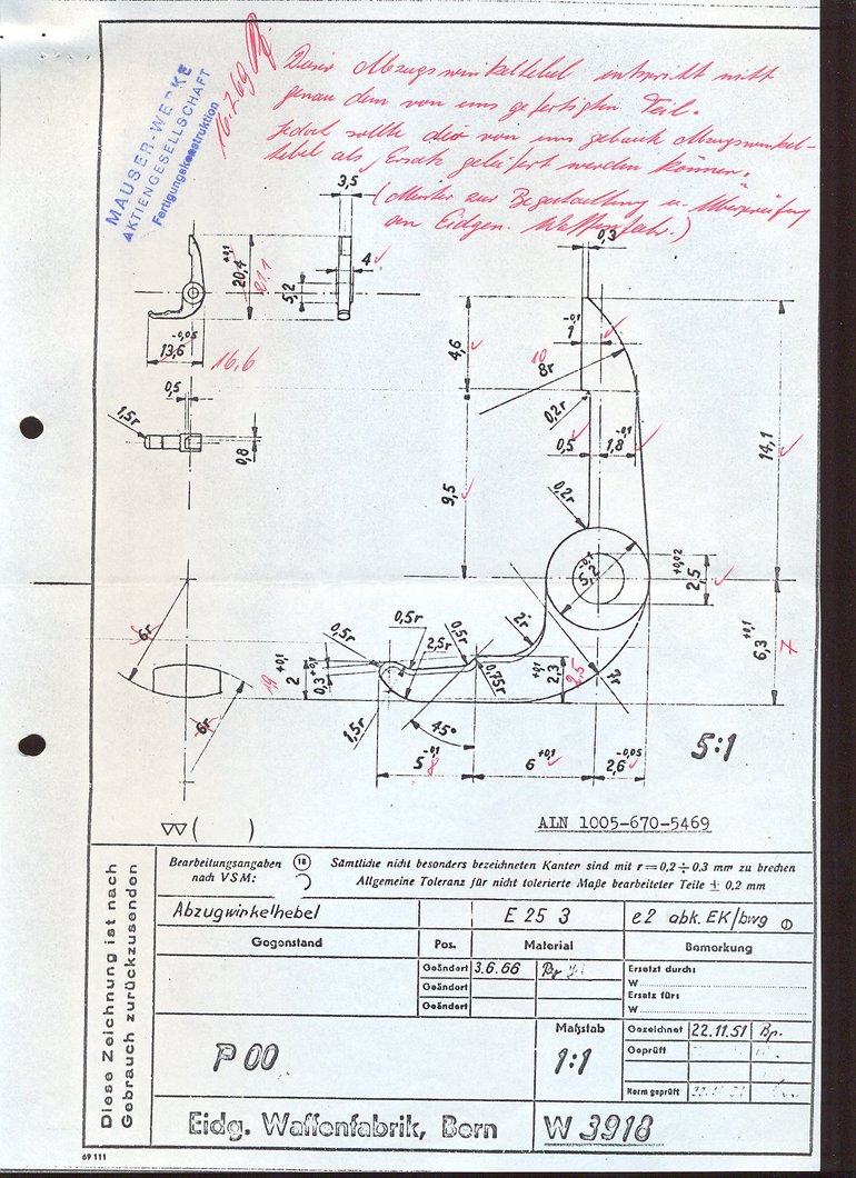

But one of the reasons Mauser was allowed to take over Swiss tools and drawings in the late 1960s was that W+F had the possibility to have Mauser make spares when needed. I found a few hints about it in the archives but no clear evidence that Mauser actually supplied parts to Bern.
As late as 1969 W+F asked about model 1900 leaf springs... which Mauser could not deliver, as they didn't make them.

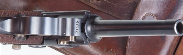

Curl, In the early 80s i saw a 1900 Swiss with that exact rear toggle. It was marked on the underside E25+ (like 4082). I assumed it was a replacement part made in 1925 specifically for old model Lugers. Never saw another till now. Unfortunately I didn't record the info.

E25+ refers to the steel type used.

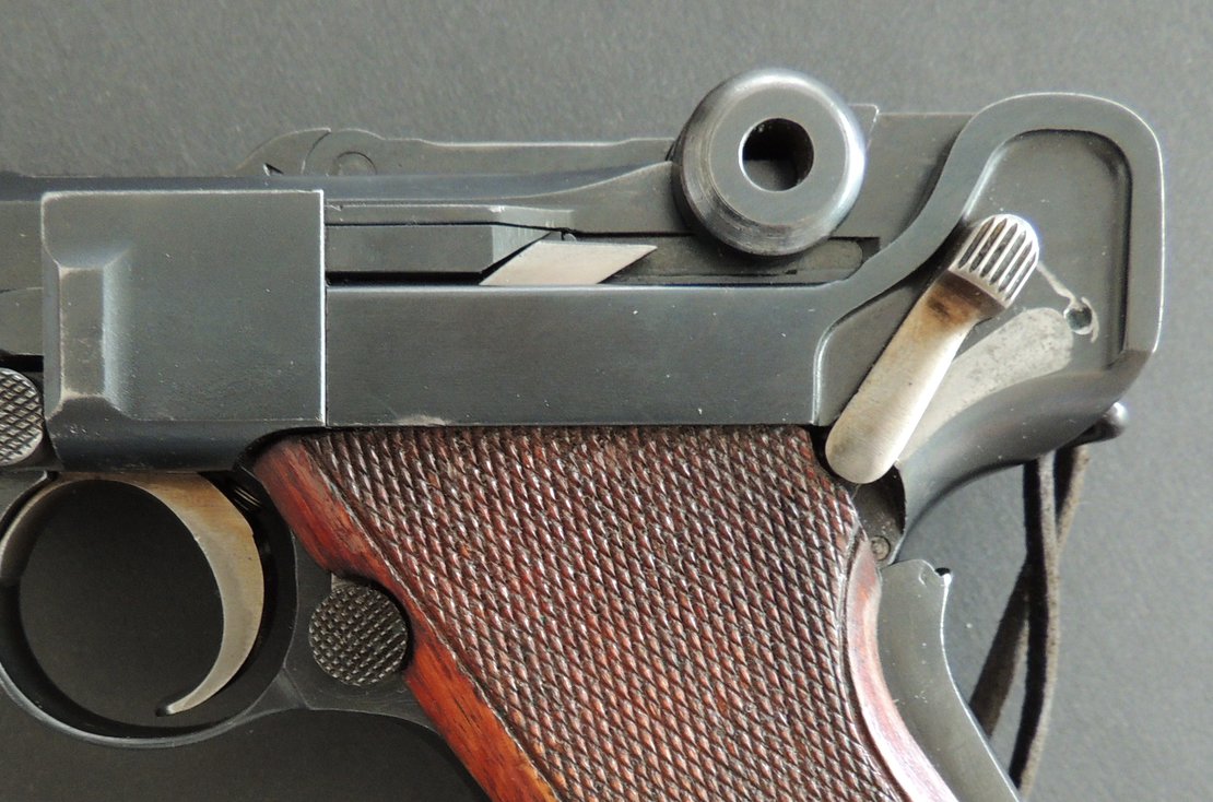

The original post photos show a neat modification to the 06/29 flat toggle knobs to appear more like the original sculpted 1900 style. Reminds me of similar machining that Sheepherder was experimenting with a while back.

If the early link was armoror swapped for a 29 why would they machine it and install the lever
Good point. Perhaps the work was done by a commercial gunsmith who was instructed to retain the functioning toggle lock? Or is the new rear link an aftermarket M1900 replacement?

Because the specifications for the Model 1900 say so.
