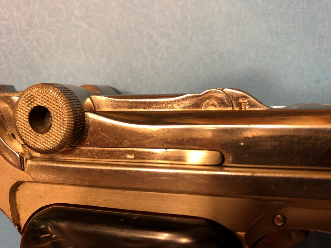

I picked up a new to me 7.65 Erfurt a few months back. I have been trying to research this one and can not quite figure it out. I can not seem to find an Erfurt with a long barrel that is 7.65. Could it have been changed to 7.65 for some reason? I am guessing a 1914 Military in 7.65? Any info would be greatly appreciated.

No Erfurt was produced in 7.65. The gun was re-barreled; probably in the 1920's.
k98mike is offline   Reply With Quote
Unread 02-19-2019, 05:52 PM   #3
Posts: 8,197
Thanks: 1,416
I'll go out on a limb here and say you have a long-shank barrel (but not military spec) fitted to a short-receiver. I can see the adapter ring between the barrel flange and the receiver.
The barrel profile does not meet the military blueprint specifications/dimensions, or if so, it has been 'massaged'.
Most likely an aftermarket barrel fitted to a military [Erfurt] receiver. Barrels wear out, and get replaced.
Looks heavily buffed. Probably barrel replaced at the same time.
It's also a Revisions Commission Erfurt.
Just my $.02...

I'm not seeing anything suggesting 1914. Why do you ask?
Unread 02-19-2019, 11:53 PM   #7
Posts: 7,040
Thanks: 1,106
Thanked 5,256 Times in 1,724 Posts
It is a Model 1914 dated 1917.

It also appears that it was an artillery model in the beginning.
A functioning shooter, for $750, that you don't have to worry about decreasing collector's value? Sounds like a deal to me.

All original Erfurt Artillery models are dated 1914...True
All post 1914 Erfurt PO8s have "artillery cuts"...Not True
most have cuts but some 1916 and 1917 uppers have been observed without the cut.
I own one dated 1917 without the cut undoubtedly original.
Rich

What are "artillery cuts" mentioned above?
hughscpa is offline   Reply With Quote
Unread 02-21-2019, 05:15 PM   #13
If you look down on the gun, just forward of the date you will see a flat surface, which was milled away so that the original artillery rear sight could lie flat instead of slightly raised.
