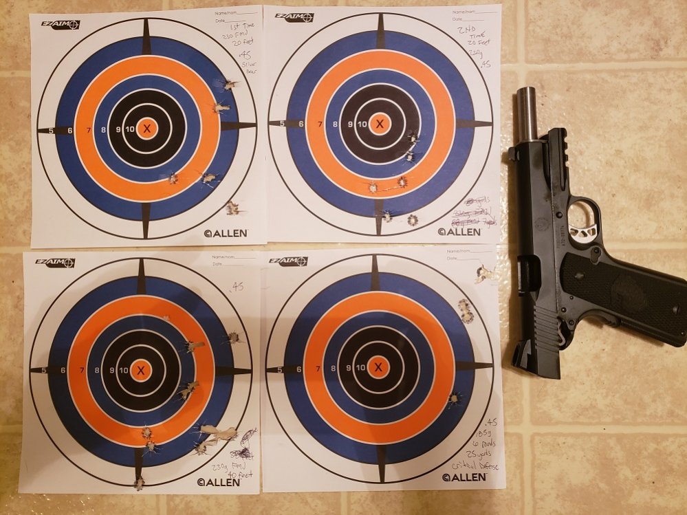

Have never given a range report and I am no firearms expert. My boss called and said don't try to drive on the roads so here goes.
This is a new Ruger model SR1911 in .45 cal, 5" barrel, stainless steel construction with nitride finish and picaninny rail. My previous .45 was a Stoeger made version of the Beretta Cougar 8045. Wasn't that thrilled with it and sold it to purchase this.
Replaced the grips before I ever fired it. Just a choice I made.
First impressions after firing at the range. Easy trigger pull, very manageable kick compared to a plastic gun. Sights are easy to line up. The 3 dot system worked well for me. The second round out of the second mag I ran stuck. I ejected it and the next one stopped just short of chambering. I bumped the slide forward and never had another issue. I think it was just a bit dry. All in all, I was very happy with my first time out with it and excited to shoot it again.
It occurred to me after I was done that my finger position probably could be better as I was pulling to the right. My second magazine showed that the sights are good. I also should think about glasses full time or hope that if I ever need to defend myself, I'm wearing my cheaters.

Thank you for the comments. I really do like this gun. Actually, the last thing I was blaming was the pistol. I've had new guns before and have had similar experiences. Was only approaching it from a scientific method of elimination, that's all.
I believe I have found the issue. I noticed a little pimple molded into the plastic, on the magazine follower, when going over everything. Thought it odd but didn't think of it again until I cleaned the pistol after shooting. While reloading a mag, the rim of the cartridge hung up. I need to trim this off.
