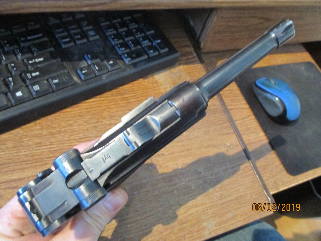

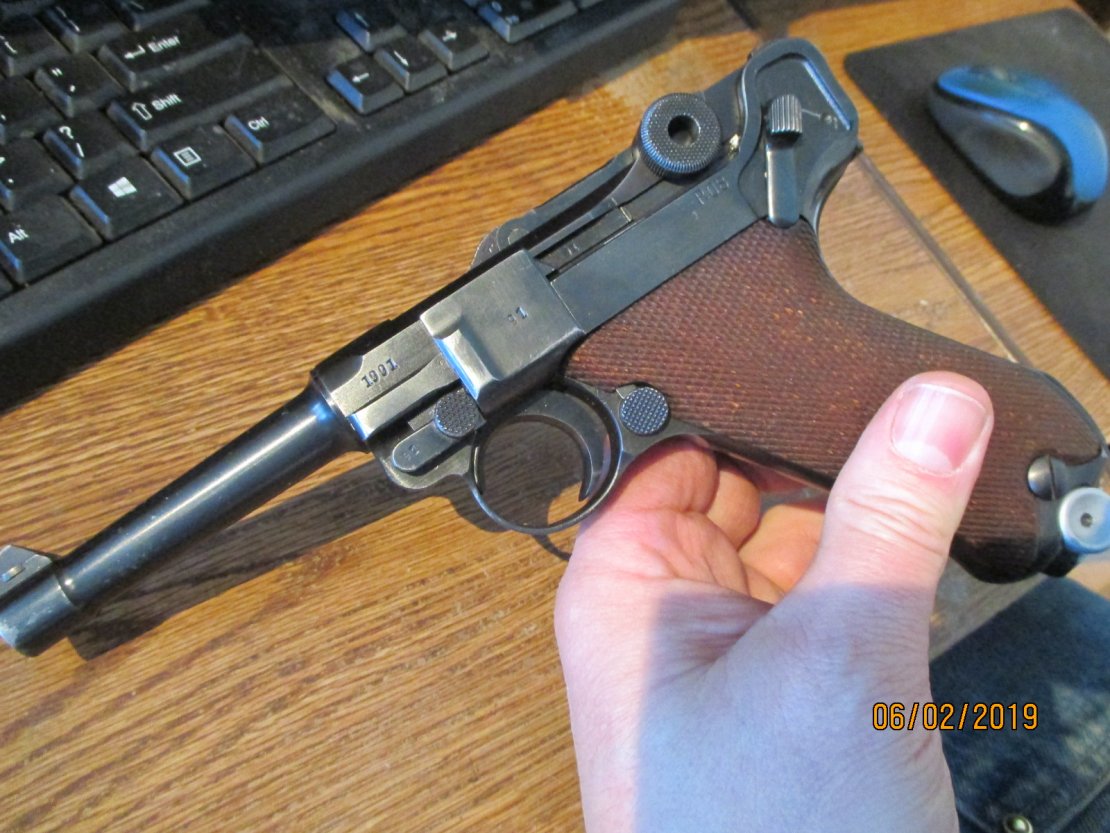

Here's a couple photos of my BYF'41 for comparison. It is generally correct that straw wasn't used after mid to late '37. Except for commercial sale Banner pistols. (Always exceptions). This one is an "r" block gun. DO NOT have your gun refinished. Unless it's a real pig.
