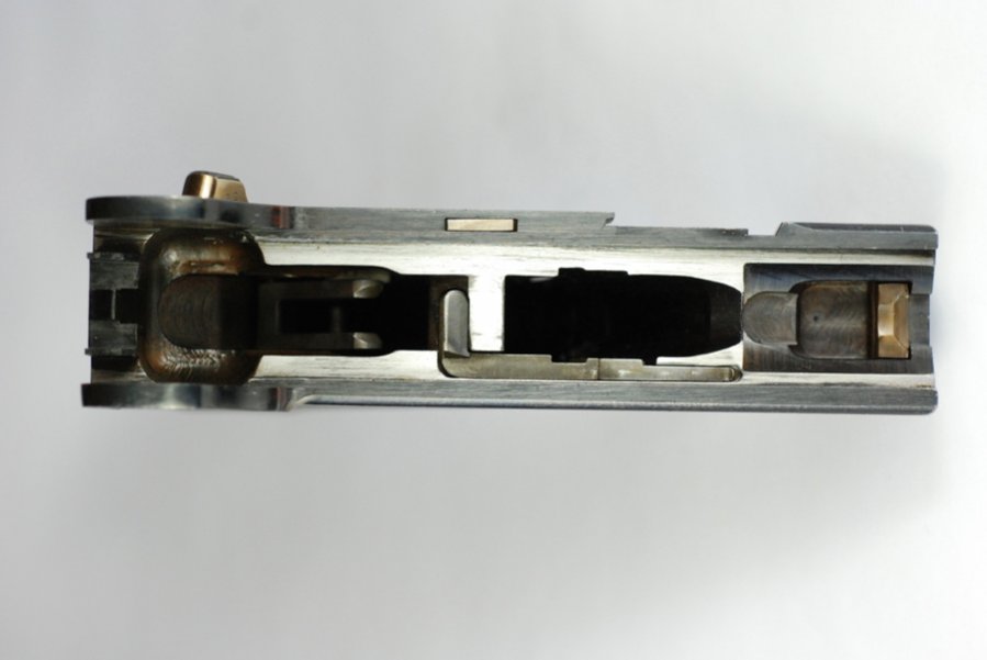

I wondered how they avoided blueing the inside rail and other parts?

For a rust blue finish, the bluing solution was only swabbed on the exterior as opposed to dipping the entire frame as is done with a hot salt blue process. Consequently the interior remained in the white.
Old 01-13-2019, 12:29 PM   #3
It also was difficult to do the "carding" process to remove the red oxide rust after it had slowly formed on interior surfaces. There was no good reason to do all that extra difficult work.
Old 01-13-2019, 01:21 PM   #4
I thought I read once upon a time, that the "white" areas were coated with wax- though maybe I dreamed that.
Also the inside was "polished" if the rust blue solution "dribbled" into areas it should not.
Maybe Charles Danner will explain how he does it?

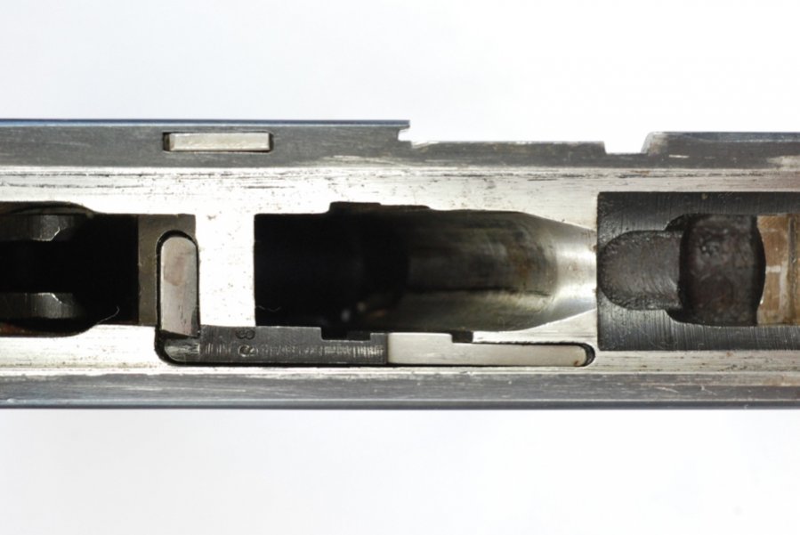

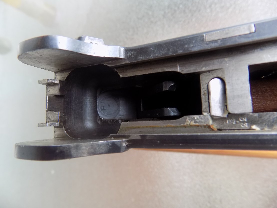

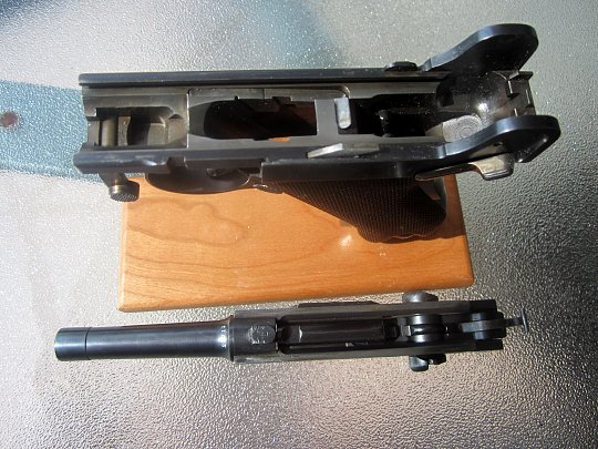

Old 01-13-2019, 02:07 PM   #5
This is a very complicated topic, bluing procedures varied both by manufacture and by year. For example, the first two photos are of an early Mauser 1937 S/42 which was rust blued and the second two are of a 1937 Kreighoff which was salt blued.
Norm
